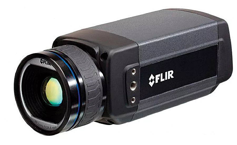

Four FLIR A315 thermal imaging cameras monitor 40 surface regions on the plastic parts after the heat cycle. Built-in analysis software determines if part temperature falls within the upper and lower control limits, and immediately notifies the welding machine PLC. Photo courtesy Flir

Germain says four FLIR A315 thermal imaging cameras proved to be the right solution. He says Yanfeng had already experimented with a small,
handheld thermal imaging camera from FLIR, so the company knew what thermal imaging could do. The Yanfeng team purchased its cameras through Emitted Energy, a certified FLIR camera distributor and system integrator.
“Thermal imaging cameras can give an accurate temperature of the plastic parts during the welding process inside the IR welding machine,” says Roy Ray, vice president of Emitted Energy. “These cameras trigger an alarm when a temperature threshold is exceeded. By means of advanced analytics software, they can differentiate between a good and a bad weld pattern.”
Emitted Energy installed the cameras on the welding machine. Together, the cameras monitor 40 surface regions (including subsurface defects and anomalies) on the plastic parts after the heat cycle.
If the part temperature falls within the upper and lower control limits, built-in analysis software sends a pass signal to the machine PLC and the welding process is continued. If not, the software sends a fail signal to the PLC, which stops the welding process. An operator then removes the rejected part, does a visual check and restarts the operation.
The software enables Yanfeng to map out heat trends over time and combine that information with additional data (such as squeeze pressure and IR heater voltage power) generated by other sensors. Most importantly, it ensures that all IW welds are high quality, error-free and repeatable.
“The cameras allow us to monitor weld quality without interrupting the welding process—even when nobody is attending the welding machine,” says Germain. “Since we no longer have to take apart the welded components, we have also significantly reduced the scrap rate.”
