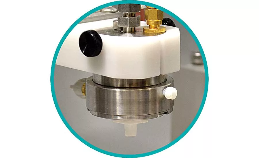

Using a specially designed ultrasonic atomizer, laser-absorbing dye is deposited on the surface of one of the clear mating parts, creating a spray pattern width as small as 0.5 millimeter. The presence of the dye enables an otherwise transmissive part to absorb laser energy. Photo courtesy Sono-Tek Corp.

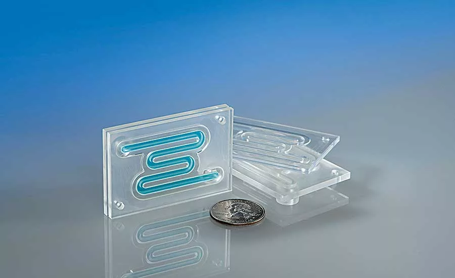

Two clear mating parts (at right) can now be laser welded using an innovative new welding process that can reliably produce complex fluid paths while maintaining superior aspect ratios. Photo courtesy Emerson

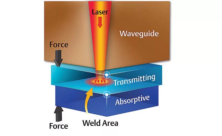

During the welding process, laser energy passes through the top part, hits the absorbing material, and consumes it, releasing heat energy that conducts through the weld zone of the mating parts, which then bond together under compressive force. Illustration courtesy Emerson

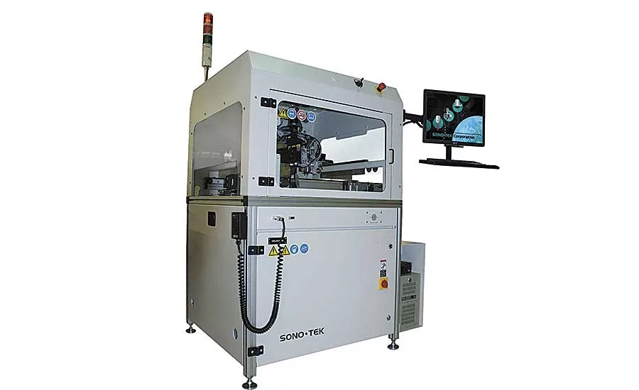

Equipment for dispensing laser-absorbing material onto plastic parts is easily integrated into existing automated assembly lines. Photo courtesy Sono-Tek Corp.

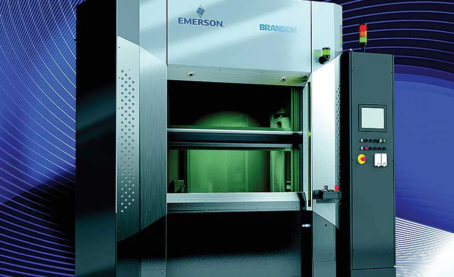

Emerson offers laser welding equipment in a range of sizes to assemble parts as small as microfluidic test cartridges or as large as taillights. Photo courtesy Emerson

The new process eliminates the prerequisite of combining one clear, or “transmissive,” plastic part with a second dark, or “absorptive,” plastic part. Instead, the process enables the laser welding of two clear plastic parts, as long as one has been precision-treated with a biocompatible laser-absorbing material. The laser absorbing material consists of microparticles of pigment dye or carbon black that are suspended in a carrier fluid, such as isopropyl alcohol or acetone. During the welding process, the laser energy hits the absorber and consumes it, releasing heat energy that conducts through the weld zone of the mating parts, which then bond together under compressive force.
The laser-absorbing suspension is applied using Sono-Tek ultrasonic spray-deposition equipment, which uses a specially designed precision ultrasonic horn to atomize the laser-absorbing dye and deposit it on the surface of one of the mating parts, creating a spray pattern width as small as 0.5 millimeter. When deposited using an optimal frequency and spray pattern, the carrier fluid essentially flashes off, leaving a precise pattern of laser-absorbing particles, 1 micron or smaller in size, on the surface of the plastic.
According to Anita Ennest, regional sales manager for Sono-Tek, the ultrasonic spray-deposition systems “are designed to deposit minute quantities of pigment dye, measured in microliters, with coating thicknesses that are evaluated in the hundredths of nanometers on the surface of the coated parts.” The equipment used to apply the laser-absorbing suspension is modeled on earlier equipment developed to deposit ultra-thin, ultra-precise coatings on medical stents.
The laser-absorbing suspension found its roots in light-absorbing coatings originally developed for use on photovoltaic cells, but is formulated with a bio-compatible solvent and pigment dye combination. Developing the right combinations involved a lengthy, iterative process that required Emerson and Sono-Tek to transition the coating, deposition and weld processes from absorbent to transmissive materials, then transmissive to fully transparent materials.
Sono-Tek’s ultrasonic spray coating equipment dispenses this absorber suspension onto one side of an injection molded joint—for example, the interior surface of a tongue-and-groove joint on one of the mating parts. Precisely depositing the absorber within a joint like this focuses the action of the laser-absorbing dye to produce the part-to-part melt. It also creates a “flash-trap” that contains the treated area of the melt, isolating it from any nearby microfluidic flow paths in the welded part.

A typical application involves two clear, flat plastic parts that, together, mate to form an assembly with a serpentine flow path. Examples include in-vitro diagnostic cartridges, drug-delivery systems, or implantable medical devices.

Multiple diodes produce laser light at a wavelength of 990 nanometers. Fiber-optic bundles transmit the light through a waveguide that uniformly distributes energy to the entire joint line simultaneously. The two halves of the part are clamped together throughout the process.
The waveguide is custom-made for each part, but quick-change tooling can be built to assemble families of parts.
Illuminating the entire bond line simultaneously reduces overall cycle time, enabling the technology to be considered for high-volume assembly of disposable medical devices. Depending on the application, cycle times range from 0.5 to 5 seconds.
