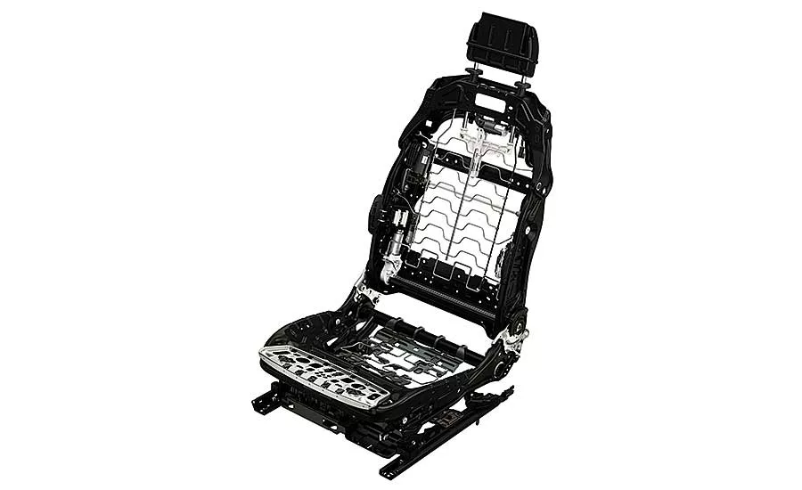

Automotive suppliers are scrambling to add new technology to seats. Photo courtesy Brose North America Inc.

They recently developed a new type of suspension system for use in the 2017 Lincoln Continental sedan. Thanks to integrated composite parts produced via multiple molding processes, the “perfect position seat” optimizes comfort by cradling the upper back and providing side-torso support, which flexes to accommodate various occupant sizes. The system, for which 83 patents have been filed, reduces total seat weight by 8 percent and cost by 15 percent, despite adding more features.
