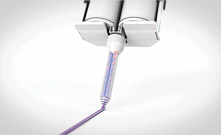

Once specific amounts of resin and hardener are metered out, the two materials pass through a static mixer to thoroughly blend the two fluids. This ensures complete curing and full realization of the adhesive’s properties. Photo courtesy Nordson EFD

Adequately mixing the two components greatly affects the final bond strength. Once specific amounts of resin and hardener are metered out, the two materials pass through a static mixer to thoroughly blend the two fluids. This ensures complete curing and full realization of the adhesive’s properties.

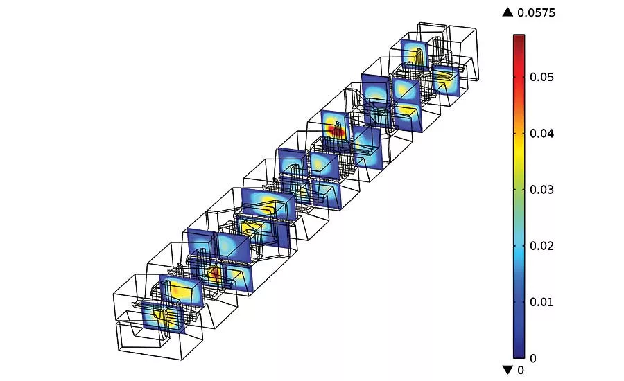

Software was an important tool in developing the new square mixer. We used mathematical analysis of probability density functions to predict mixing rates for various mixer geometries. Although static mixers have long been based in round mixing chambers, our mathematical analysis showed that a square geometry would actually provide more efficient and effective mixing results. The square geometry promotes laminar mixing, which we found to require less energy to achieve a desired mix quality.
In addition to commercial simulation and design software, we used our own proprietary analysis software to develop our new mixer. Two years in the making, our software predicts flow patterns and results from mixing two fluids with different mixing geometries, different inlet shapes, and different fluid paths and angles. The software potentially saved years of trial-and-error study by making it possible to simulate hundreds of different mixing geometries, fluid path angles and nozzle openings before determining likely candidates for prototyping.

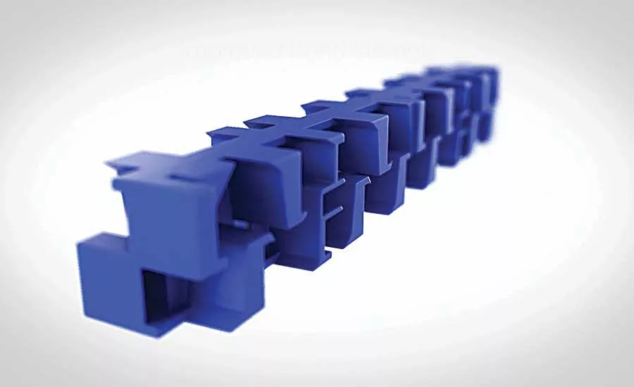

The result of our research is a new line of square, disposable mixers, the OptiMixer Series 480 mixers. Depending upon required volume and length, the mixers use different numbers of wedge elements to achieve optimum mixing results.
The mixer elements are 8.7 millimeters wide, and mixers are available with nine, 17, 25, 33 and 41 mixing elements. The number of elements determines the housing length and retained volume. Housing lengths range from 7.4 to 20.6 centimeters. Inlets are either an integral nut or bell. Outlets are barbed or stepped.
