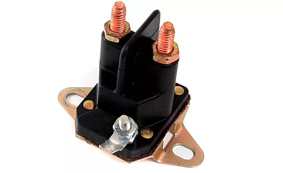

IMB adhesives structurally bond a plastic or metal substrate to a liquid thermoplastic or silicone rubber during injection or compression molding. Photo courtesy LORD Corp.

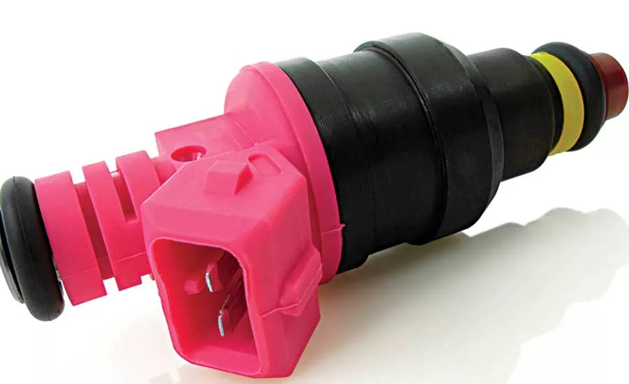

Current applications for IMB adhesives include automotive components, consumer electronics and medical devices. Photo courtesy LORD Corp.

Water may be vital to human life, but it can also be detrimental to the performance of many manufactured products. One such product is the automotive sensor connector, which Pune, India-based Minda Industries Ltd. has been making for several decades. Recently, however, the company needed to address the problem of water entry causing several of its sensor connectors to fail.
Minda’s product designers researched several ways to better seal the connectors—which leaked at below 0.5 bar pressure. To that end, Minda engineers met with LORD Corp. to discuss the capabilities of the company’s in-mold bonding (IMB) adhesives. LORD offered to apply one to several connectors during molding, and then have Minda test them under high pressure to see if the adhesive provided an adequate seal.
LORD developed IMB adhesives a couple years ago to help manufacturers increase efficiency and design flexibility during molding. According to Mayuresh Patil, technical sales executive at LORD Corp., the adhesives eliminate the secondary process costs associated with pressure-sensitive-adhesive tapes and structural adhesives. They also enable engineers to more easily design curved, thin and lightweight devices.
IMB adhesives structurally bond a plastic or metal substrate to a liquid thermoplastic or silicone rubber during injection or compression molding. Equally important, they create a strong seal that resists liquid or gas ingress and egress.
In the Minda test case, an IMB adhesive was applied to copper-alloy terminal pins, and nylon was poured onto the pins during injection molding. Each connector was then subjected to high positive pressure (up to 3 bar) for a specific time. Test results showed that no treated connector leaked, and the adhesive withstood thermal cycling better than the old sealant.
Minda has since begun using the adhesive on various connectors in production, with no customer complaints about sensor failure due to water entry. Patil says Minda especially likes the adhesives because they require no special surface preparation or atmosphere conditions, and are environmentally friendly.

Compatible substrates include aluminum, anodized aluminum, glass, steel, stainless steel, polycarbonate, select polyamides, nylon and magnesium. Acceptable thermoplastic molding materials are polycarbonate, ABS-polycarbonate, nylon, PBT and select elastomers. Current applications include consumer electronics (wearables, cell phones, cases), automotive components (ignition coils, injectors, pumps, solenoids, connectors) and medical devices.
