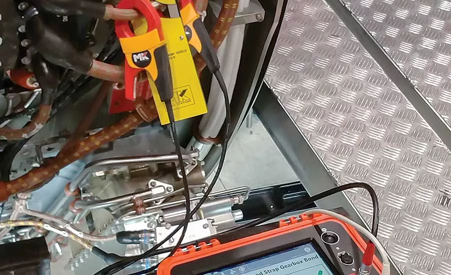

Harness technicians at Boeing, Airbus and other aerospace manufacturers use the B-LRT tester to quickly find unreliable ground circuits in aircraft. Photo courtesy MK Test Systems Americas

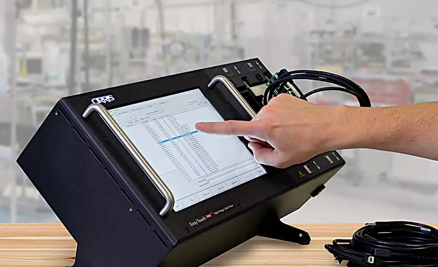

The Easy Touch Pro cable tester accurately tests resistors, diodes, capacitors, LEDs, switches and twisted pairs for opens, shorts and miswires. Photo courtesy Cirris Systems Corp.

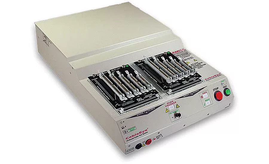

Harness manufacturers can meet industry-standard A620B testing guidelines with the HVX-21 high-voltage tester, which has a current sensitivity of 0.1 microamp and maximum test voltage of 2,100 VDC. Photo courtesy CAMI Research Inc.

A couple years ago, MK Test Systems developed the B-LRT tester to help harness technicians at Boeing, Airbus and other aerospace manufacturers quickly find unreliable ground circuits in aircraft. Such circuits leave aircraft vulnerable to the damaging effects of stray currents, lightning strikes and high-intensity radiated fields.
Kane says the B-LRT tester quickly performs bond, loop and joint resistance tests, and it guarantees accurate measurements. Built-in software guides the operator via easy-to-understand graphics and test instructions. All results are automatically recorded and uploaded to the facility’s main server via a Wi-Fi, LAN or portable storage device.
The bond test measures the electrical resistance between two joined metallic elements. For the loop test, a number of metallic elements and equipment are connected to create a loop of parallel resistance paths. The technician places clamps on each side of the loop. One injects current into the loop, while the other detects the current flowing in the loop. The joint resistance test also makes use of the loop test current. As current is injected, voltage is dropped and then phase-corrected to determine joint resistance.
“A typical single-aisle aircraft requires around 800 bonding measurements in each wing and 400 in the engine,” explains Kane. “It’s common for the total number of tests per aircraft to run into the thousands.”

Harness manufacturers often use Cirris’s Easy Touch Pro tester to accurately test resistors, diodes, capacitors, LEDs, switches and twisted pairs for opens, shorts and miswires. The tester runs easy-wire software on a Windows 10 operating system and offers 128 test points per box (1,024 maximum). The self-contained unit handles voltages of 1,500 VDC, and processes data up to three times faster than its predecessor, the Easy Touch. The upgraded model also features a high-resolution, 10.4-inch color touch screen made of

CAMI’s HVX-21 high-voltage tester has a current sensitivity of 0.1 microamp and maximum test voltage of 2,100 VDC. Designed to meet industry-standard A620B testing guidelines, the tester lets technicians specifically program ramp up, ramp down, dwell time (test time), trip current and trip delay (soak time) for each application. It also produces archival-quality reports for each cable tested that clearly says ‘pass’ or ‘fail’ at the top. Each report includes data such as test voltage, leakage current and insulation resistance for each wire group.
