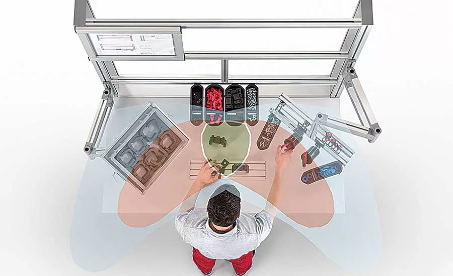

To optimize worker production at any workstation, every part and tool needs to be easily within reach. Photo courtesy item America LLC

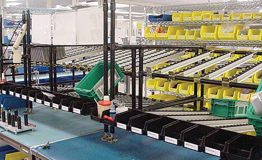

Anyone who does some type of manual or semiautomated assembly work, including kitting and packing, can benefit from an ergonomically designed workstation. Part bins should be above the work surface and color coded. Photo courtesy Creform Corp.

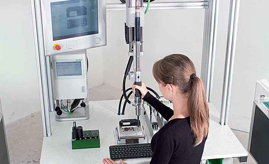

Installing fasteners is a common assembly process performed at workstations. Photo courtesy DEPRAG

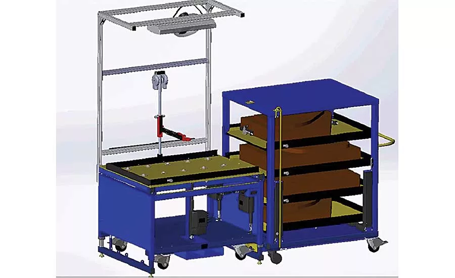

The RCT-SL workstation features four pallets stacked on an adjustable-height cart. Each pallet has a fixturing nest that holds a specific vehicle panel (front right, front left, rear right or rear left) in place during assembly work. Graphic courtesy LTW Ergonomic Solutions

“Because the demand for parts has lessened over time, the company needed to remove a full assembly line and use the space for other work,” explains John Lanphear, founder and president of LTW Ergonomic Solutions Inc., which has made adjustable- and fixed-height industrial workstations and workbenches since 1999. “Last year, we were asked to build a custom workstation that, in essence, replaces the old assembly line and helps workers efficiently assemble small batches (five to 10 pieces) of replacement parts.”
Within a couple months, LTW developed a durable adjustable-height workstation with advanced capabilities based on its patented standard model. Made of 2-inch-square, 7-guage welded tube steel, the station measures 48 by 40 by 86 inches and comes equipped with a touchbutton motor controller and five swivel-locking casters. The laminated work surface is 1.5 inches thick. The surface tilts, raises up to 12 inches, and has a 1,100-pound lift capacity.
Lanphear says the workstation’s most unique feature, however, are four pallets stacked on an adjustable-height cart. Each pallet has a fixturing nest that holds a specific vehicle panel (front right, front left, rear right or rear left) in place. When assembly work is required on a specific panel, that pallet is slid onto the work surface. After work is completed, the pallet is moved back in place on the cart.
Since installing the workstation, the Tier 1 supplier has had no problem keeping up with part orders, and is using the extra floor space for other production work. It is also considering installing similar workstations at more plants. Meanwhile, Lanphear named the workstation the RCT-SL (rapid change technology—side load), made it a standard product and is marketing it and a smaller version to manufacturers in all industries.

Most often, small and medium-size parts are assembled, inspected or tested on workstations. Lori Logan, marketing manager at DEPRAG, says assembly processes include installing fasteners, and pressing or bonding parts. Crimping or cutting wires is another common task.
To optimize worker productivity at any workstation, every part and tool needs to be within easy reach. Soderland says tool holders and holsters help workers grab, use and put away all sorts of hand tools. Balancing and positioning arms ensure proper ergonomic tool use and prevent worker fatigue. Fixtures keep parts secure during assembly.

“Anyone who does some type of manual or semiautomated assembly work can benefit from a modern workstation,” points out Dotson. “This includes those who do kitting and packing—especially e-commerce order fulfillment. Although not traditional assembly work, per se, it does involve constantly moving products from bins and conveyors into bags and boxes. The workstation’s ergonomic layout lessens the strain on workers and makes them more productive and efficient.”

“The technological features of workstations have expanded significantly in recent years, beginning with electric height adjustment,” says Logan. “Stations are also available with built-in sensors, process control systems, power and data supplies, and feeders. Sensors verify all parts are present in a subassembly, while a pick-to-light system makes sure the worker performs an assembly task in the proper sequence. The supplied electrical feed can handle computers and medium- or high-wattage tools, like a soldering iron, while integrated feeders quickly bring parts or fasteners to the worker to save time.”
DEPRAG’s latest manual workstation features an aluminum base frame that comes in various sizes. Height adjustment is done electronically, and the workstation can be equipped with rotating part fixtures so workers can access an assembly from all sides. According to Logan, this latter feature is most important for one major automotive Tier II supplier that assembles dashboards and doors. The workstation frame also integrates into an assembly line and comes with a built-in parts feeder, pick-to-light display monitor, energy supply and LED lighting.
