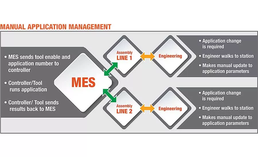

When an engineer needs to make a parameter change today, the engineer has to make the changes on the production floor. Making changes in multiple production locations provides even further opportunity for errors. (fig.1)

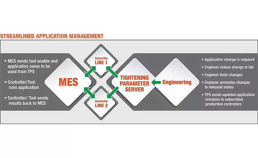

Using Cleco’s Tightening Parameter Server provides the ability to create and test in a lab environment prior to releasing into production. Assuring that you have the best quality manufacturing process possible. (fig. 2)

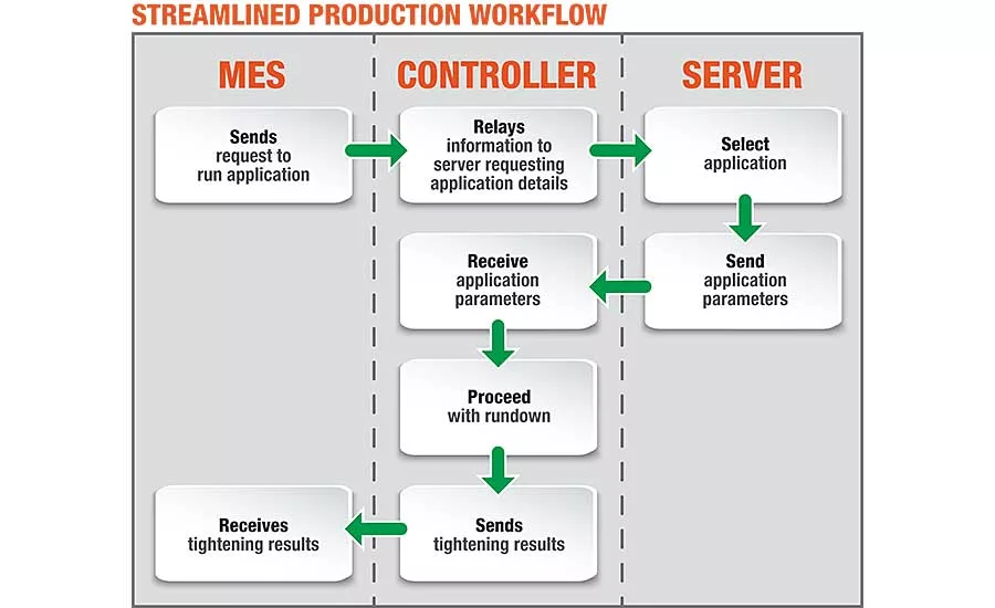

Having the Cleco Tightening Parameter Server enables the controller to have a virtually endless number of applications stored while also ensuring the correct application is being used each time. (fig. 3)
