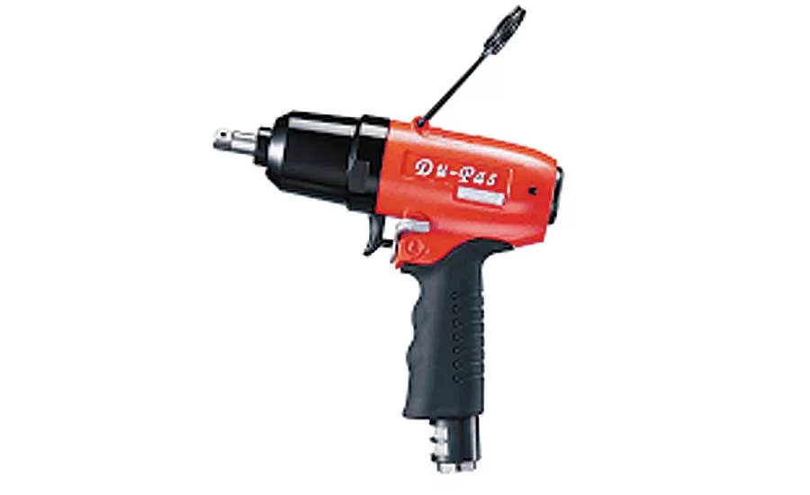

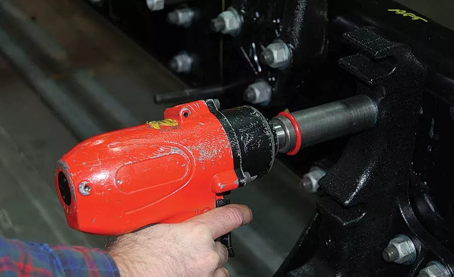

Primarily, there are two tool types for non-critical fastening: Discontinuous Drive Hydraulic Impulse & Continuous Drive Clutch.
Factors of consideration when selecting a torque tool….
  • Discontinuous Drive Hydraulic Impulse Tools
  • Features…
  • Good weight to torque ratio
  • High rpm
  • Low vibration
  • Pneumatic or Cordless
  • Torque accuracy of +/- 10 to 15%
  • Torque Range of 5-450 NM
  • High precision components designed for longevity and durability in industrial environments
  • Well balanced for low operator fatigue
Ideal applications…Pulse tools are best suited for hard to medium joints. Torque reaction is almost non-existent at torque specifications; thus no investment required for complicated reaction device. It is considered a one-handed tool. Based on the high rpm offering, this tool is ideal for demanding high production environments. Pulse tools require simple fluid changes based the demands of the application.
