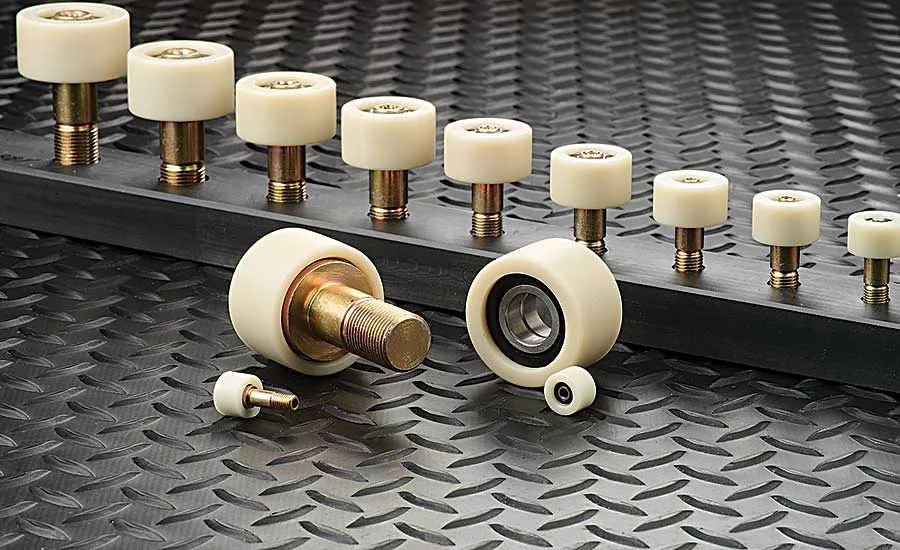

Featuring polymer-bearing surfaces with metal shafts and precision ball bearings, these cam followers weigh about 40 percent less than allmetal cam followers of the same size. Photo courtesy Intech Corp.

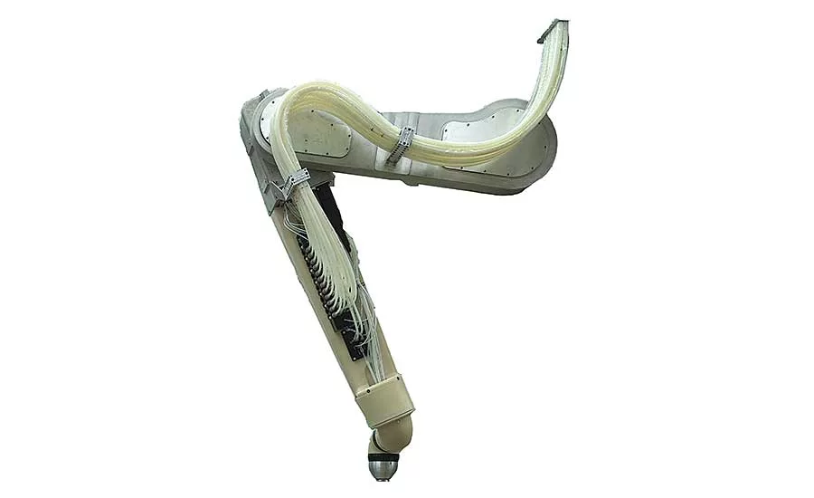

Used for painting cars, Intech’s Power-Core robotic arm provides electrical insulation for paint charged with 100,000 volts. Photo courtesy Intech Corp.

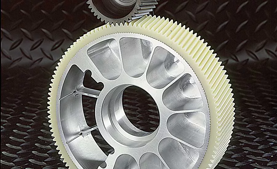

With an outside diameter of 19 inches, this 2.5- inch wide spur gear is the main drive of a diapermaking machine. Photo courtesy Intech Corp.

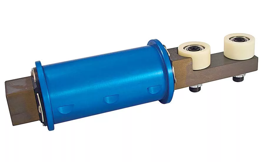

By upgrading motion components—such as these track rollers—engineers can improve the speed of a machine by 15 to 20 percent or more. Photo courtesy Intech Corp.

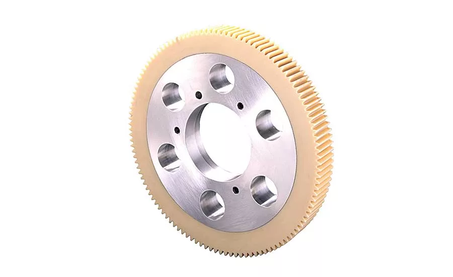

A hybrid approach to machine components lets engineers get the best of both worlds—the lightweight of plastics and the high-strength of metals. This gear set features plastic bearing surfaces over structural steel or aluminum elements. Photo courtesy Intech Corp.

To get the best of both worlds, we often take a hybrid approach that uses plastics and metals together—casting plastic bearing surfaces over structural steel or aluminum elements. For example, we can apply polymer-bearing surfaces over high-speed roller ball bearings, which is a natural fit for applications slowed down by the greased needle bearings used in most metal cam followers. We also employ metal shafts and gear hubs.
These hybrid systems require some extra design attention. Using advanced stress analysis, we can determine the right ratio of plastic to metal. A well-designed component will take the best of what each material has to offer—structural strength from the metal, such as using metal core for safe gear attachment to a metal shaft, and beneficial surface properties from the polymer.

One recent example involved the arm of a painting robot. To carry the payload and evenly distribute the stresses throughout its 1,000-millimeter length, we changed the original 100 by 100 millimeter square aluminum tube cross-section to a tapered shape with a 260 by 150 millimeter cross section at the wide end. The purpose of the change to plastic material was to provide electrical insulation to the robotic arm in an electrostatic paint process.
Another example is a 19-inch OD anti-backlash Power-Core gear in a diaper-making machine. This gear must withstand the forces associated with an e-stop, which is equivalent to the full torque of a 10-hp motor for 30 milliseconds, plus the shock load of the machine’s gear train mass. Our calculations showed that if we increased the gear width from 2 to 2.5 inches, the gear would carry this high emergency load. The increase in width was possible because the application had enough room on the drive end of the machine to accommodate the thicker gear.

Metal cam followers, as well as the cams or rails they’re running on, are subject to metal-on-metal wear. Over-greased needle bearings in metal cam followers can lead to skidding and extra wear. Cam followers on high-speed machines are often pressed against the cam with heavy spring loads to prevent skidding. High spring loads only accelerate wear on both the cam and cam follower. Fitted with lubricated-for-life ball bearings, polymer cam followers eliminate the need for lubrication of both the bearing and the cam surface. And, when properly designed, they maintain full contact with the cam without any springs, simplifying design. Most importantly, they don’t wear the cam surface, preventing costly downtime.
