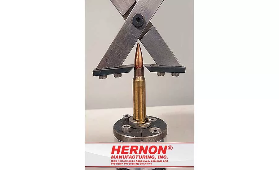

While first developed to protect against water and other contaminants, it was later realized that the sealants could be used to alter bullet pull strength. Using external ammunition sealant, pull strength is set by bonding the projectile to the casing. Because sealants adhere to the casing and projectile with a defined shear strength, ammunition manufacturers can essentially select the pull strength needed to separate the projectile from the casing. If manufacturers would rather just seal the cartridge without otherwise changing the properties of the assembly, they can use a sealant that does not measurably alter bullet pull strength.
Using an external sealant to set bullet pull strength can significantly improve ammunition performance compared with crimping. How? Crimping a cartridge adds variables that can make bullet pull strength inconsistent. The consistency and efficacy of the crimp is influenced by tool wear, machine

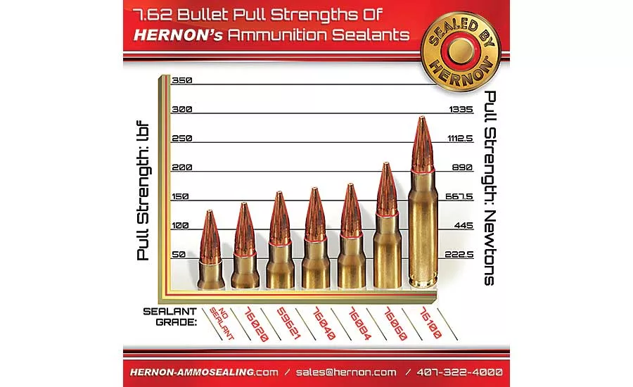

Because of its low viscosity and wicking properties, the external ammunition sealant is distributed evenly around the cartridge case mouth and base of the projectile. This even distribution results in uniform bullet pull strength and a stable release and flight pattern for the bullet. This claim is evidenced by comparing the standard deviation of bullet pull strength for sealed and unsealed cartridges. Results for sealed rounds have a lower standard deviation. A lower standard deviation of bullet pull strength translates into more consistent bullet velocities, a more reliable trajectory for each bullet, and ultimately a tighter (more precise) grouping on the target.
External ammunition sealants can maximize bullet pull strength at almost 300 pounds. As bullet pull strength increases, so does the pressure inside the ammunition casing prior to the bullet firing. This may be a positive or a negative for ballistics engineers, depending on what they want to achieve. As a result, ammunition sealants are available with a range of tested pull strengths.

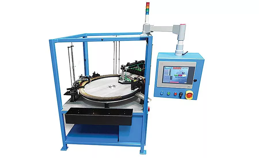

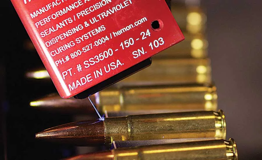

External ammunition sealants are applied with noncontact precision jet valves to the joint line of the cartridge case mouth and bullet. They can also be applied to the primer cap. They are specially formulated to exhibit very low viscosity and to wick around the case mouth and primer, resulting in a smooth, consistent distribution of sealant. The sealants are then cured in place using an array of UV LED curing lights.
When exposed to UV light at the right wavelength and intensity, the sealants only need a few seconds to cure. Further subsurface curing occurs anaerobically. After UV curing is completed, ammunition can be handled, tested, packaged and shipped in minutes without ever leaving the assembly line.
Originally, the cost of automated ammunition sealing systems may have only made business sense for the largest ammunition manufacturers. However, new smaller models have brought automated sealing, curing and inspection equipment within reach of any manufacturer. Improvements in design have reduced machine complexity and even the software and interface has become more intuitive.
