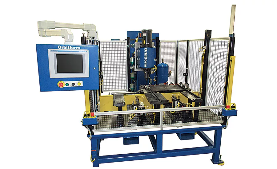

Several factors can influence the overall design of a multistation automated assembly system, such as production volume and model mix. Photo courtesy Orbitform Group LLC

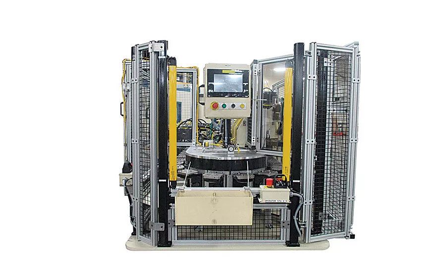

The goal of automation is to have a machine run with minimum downtime and little or no operator interaction. Photo courtesy Orbitform Group LLC

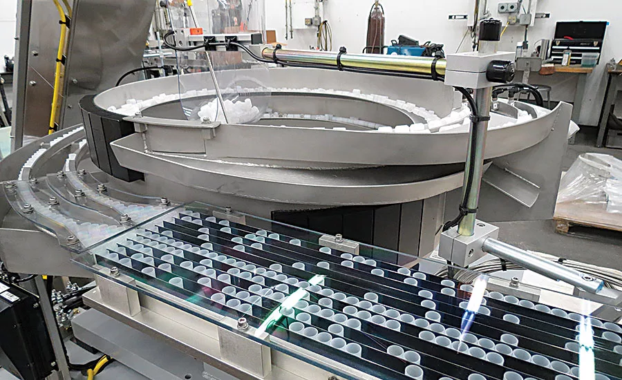

Without actual parts, it’s difficult to design high-speed assembly systems. Photo courtesy Performance Feeders Inc.

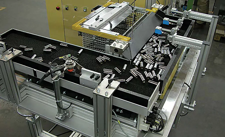

Parts feeding plays a critical role in the long-term success of multistation automated assembly systems. Photo courtesy RNA Automation Ltd.

Several factors can influence the overall design of rotary-dial machines and other types of multistation automated assembly systems. Production volume, model mix, floor space requirements, and the size and quantity of the parts to be assembled must be considered.
Generally, if production volume is high, model mix is low and the parts are small, fixed automation is the way to go. If production volume is lower, model mix is high and the parts are relatively large, a more flexible, cellular approach is necessary.

“Ideally, the goal is to have a machine run with minimum downtime and little or no operator interaction,” adds Bryan Wright, vice president of sales at Orbitform Group LLC. “Today, it’s more common to see manufacturers come to us with multiple product variants.”
For example, instead of producing a single assembly at a rate of 1 million units a year, the project might have to produce five assemblies, each at a rate of 200,000 units a year.

Another common mistake that engineers make is underestimating the importance of parts feeding. “It’s something that often gets overlooked,” says Pflum. “Many engineers look at bowl feeders as a commodity. They ask things such as ‘how quickly can I get a 15-inch bowl?’ rather than focusing on what the feeder actually needs to be doing.
“Part feeders are not simple plug-and-play devices,” adds Pflum. “A vibratory bowl isn’t always the best way to go. Sometimes, a centrifugal or step feeder might be a better option.”
As more engineers retire, the problem is getting worse. “Parts feeding is not something that’s taught in college,” claims Pflum. “Many new guys don’t understand what’s involved in the process. They think we can convert a digital model and then machine a feeder bowl out of a piece of metal. But, that’s just not how it works.”
Some engineers also make the mistake of not supplying parts for a vendor to evaluate before they quote a project. “They don’t understand why we can’t build something without first seeing the physical parts,” says Pflum. “If you don’t have parts, you can’t test and debug the system to make sure that it works.”
