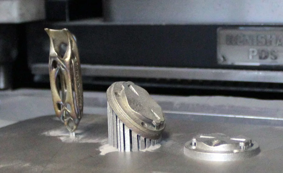

The same cannot be said for 3D printing. The build time for a single part can be measured in hours. Just removing a piece after a printing run may require cutting it off a build plate and removing supports. Leaving aside for a moment the post-processing work that needs to be done on the part itself, the printing machine needs to be cleaned, loaded with fresh raw material, and reset to begin the next part.

Currently, surface finishes are rough and need sandblasting, polishing, grinding, or other processes to achieve an acceptable result. They also require post-processing for various reasons. For instance, this may include tapping and threading concentric holes, or machining flat mating faces and precise angles. That means that additive and subtractive manufacturing must work seamlessly together to achieve true high-volume production. Currently there are some constraints to having these technologies work side-by-side.
