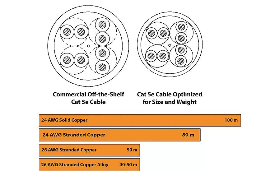

Size- and weight-saving cable configurations meet the need for highspeed Ethernet over reduced distances. The bars indicate practical distances for different conductors. Illustration courtesy TE Connectivity

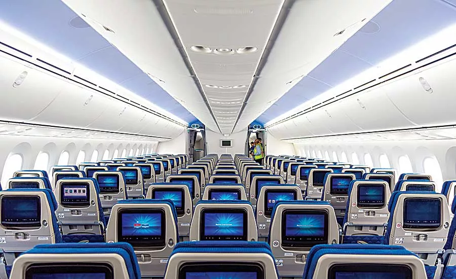

Even passengers in coach expect on-demand access to audio, video and games. High-speed cables are vital to giving passengers what they want. Photo courtesy The Boeing Co.

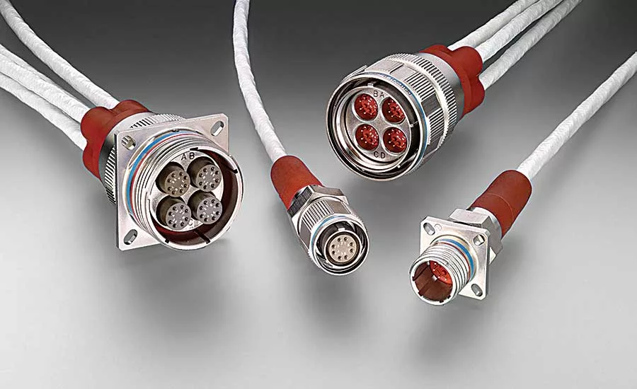

CeeLok FAS-X connectors provide reliable, consistent high-speed performance in military and aerospace high-speed networking applications. Photo courtesy TE Connectivity

Consider a Cat 5e cable for Gigabit Ethernet. Its typical commercial construction is a 24 AWG solid bare copper conductor with polyethylene insulation and PVC jacket. The ANSI/TIA 568-C.2 standard defines electrical requirements for attenuation, insertion loss, return loss, crosstalk and a host of other criteria. For our purposes, we will focus on insertion loss. This characteristic largely determines allowable cable distances (assuming crosstalk goals are met).
Consider a typical progression in defining a Cat 5e cable for aerospace. Each step tends to increase both attenuation and insertion loss, effectively reducing the allowable cable length. TE Connectivity works closely with aerospace designers to craft cabling that meets the goals of the application protocol and the requirements for size, weight and robustness.
Stranded conductors give greater flexibility in installing and routing cables in space-constrained aircraft. While the 568-C.2 standard recognizes stranded conductors for short patch cords, it specifies solid conductors for backbone needs because of their lower insertion loss. The change from solid conductor to stranded conductor allows for a 20 percent increase in insertion loss, which would result in a 20 percent decrease in the maximum cable run length.
Many aerospace applications specify silver-coated copper alloy conductors because of their high tensile strength. Moving from pure copper to a copper alloy can increase insertion loss by another 10 percent, depending on the cable design.
Smaller conductors save weight, which explains the trend toward 26 AWG and even 28 AWG. Additional size and weight reductions can also be obtained by using thin-wall, lower permittivity dielectrics and tougher jacket materials.
