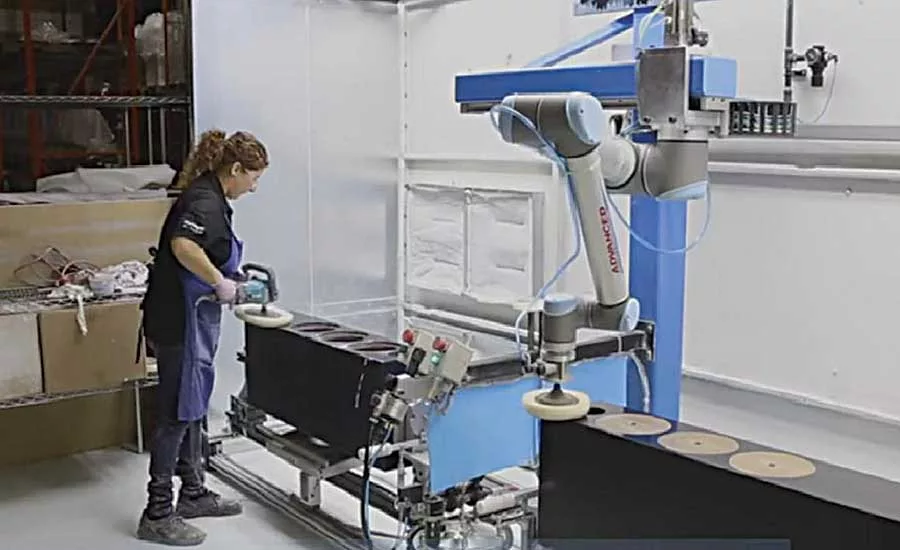

After a worker applies lacquer to the cabinet surface, the robot uses an end-of-arm buffing tool to perform the initial polishing. The worker checks whether the robot has done an adequate amount of work before he does the final polishing. Photo courtesy Universal Robots

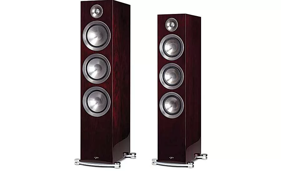

Since the fall of 2014, Paradigm Electronics Inc. has offered some speaker cabinet models, such as the Prestige, with a Midnight Cherry finish. Photo courtesy Paradigm Electronics Inc.

In the fall of 2014, the company began offering some speaker cabinet models, such as the Prestige, with a Midnight Cherry finish. Oleg Bogdanov, director of product development at Paradigm, says the market response was quick and positive.
“To produce that finish, [we] have to apply multiple layers of lacquer, and sand and buff [twice] between each layer,” explains Bogdanov. “There’s a lot of manual labor involved, and we just couldn’t find enough skilled people who can do that.”

Since Paradigm installed the robot in 2015, Bogdonav says it has increased production of Midnight-Cherry-finish cabinets by 50 percent. After a worker applies lacquer to the cabinet surface, the robot uses an end-of-arm buffing tool to perform the initial polishing. The worker checks whether the robot has done an adequate amount of work before he does the final polishing.
“It’s a very hand-in-hand kind of operation between the two as they safely interact,” says Phillips.
He cites two robot features as the most important. One is built-in force control, which ensures the application of consistent pressure during polishing to prevent surface overheating. Another is easy programming. A worker trains the robot by simply positioning it in the sequence that it needs to move during operation. Saved programs are quickly recalled on a 12-inch touch screen.
The UR10 has a load capacity of 10 kilograms and a reach radius of up to 1,300 millimeters. It weighs 28.9 kilograms, has a repeatability of ±0.1 millimeter and can work in temperatures from 0 to 50 C.
