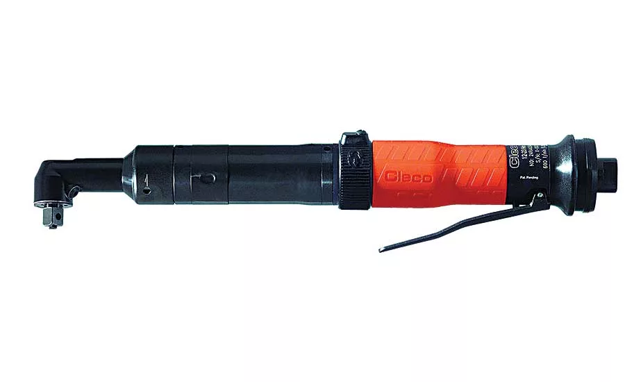

For example, a right-angle tool typically requires more maintenance than an inline model, due to the bevel gears in the tool’s head. “Our general recommendation is that maintenance should be performed every 500,000 cycles for right-angle tools and every 1 million cycles for inline tools,” says Russ Hughes, product marketing manager for Desoutter Industrial Tools.

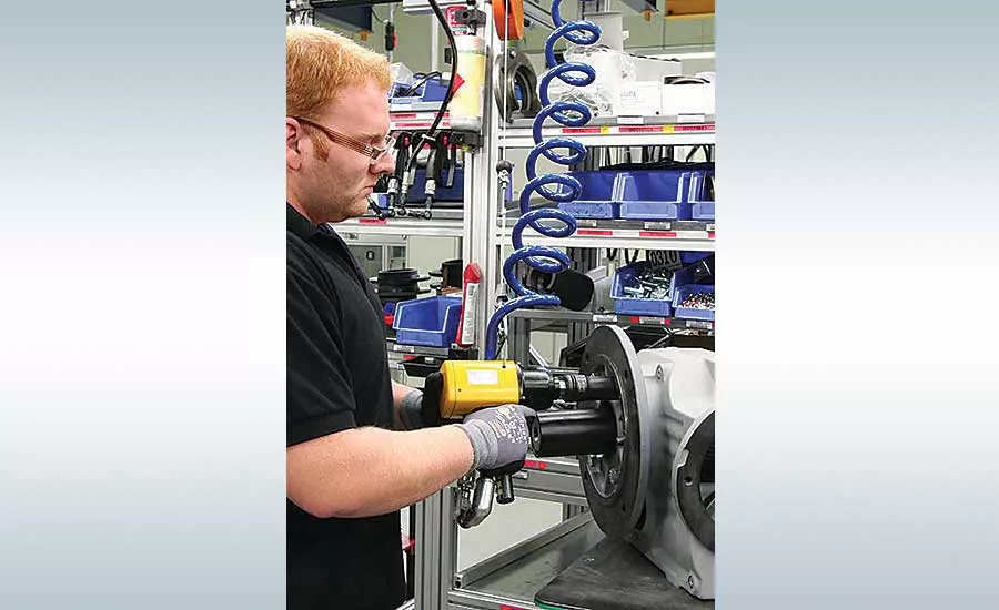

Pneumatic tools are durable and require little maintenance. When they do need to be fixed, the repairs are simpler and less costly than repairs to electric tools. An air motor can’t burn out when stalled. Pneumatic tools can take a lot of abuse without the need for protection circuits, load monitoring or overload control devices. Any electric or cordless tool, no matter how well-designed, runs a slightly higher risk of being damaged from overload.
Pneumatic tools are powered by compressed air running through an air motor. Think of the air motor as a windmill. Compressed air blows against the windmill and turns a driveshaft, and that rotary motion is eventually transferred to the fastener. Thus, pneumatic tools need to be supplied with clean, dry, lubricated air. Separating humidity from the air will prevent corrosion in the air motor.
Once per week, engineers should check the condition of air hoses, power cables and connections. Tool suspension components, torque reaction devices and FRL units should also be inspected.
With every 100,000 run-downs, the gear head should be lubricated. The tool housing, baseplate, socket and socket bushings should be inspected, and any worn components should be replaced.
With every 250,000 run-downs, it’s a good idea to disassemble the motor and check the rotor blades for wear. The front and end plates should be inspected, and the motor bearings should be replaced. The valves, seals and clutch should be inspected. The gearing in angled heads, crowfoot tools and tube nut tools should be inspected, as well.

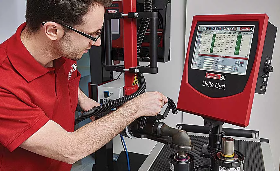

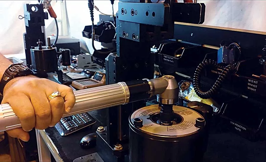

At a minimum, fastening tools should be calibrated once per year, or any time they receive preventive maintenance. Calibration involves comparing two torque values with each other using a defined measurement system: the value given by the tool to be calibrated and the value given by the reference. If the torque is outside acceptable tolerance limits during calibration, the tool must be adjusted.
Calibrating a tool is not the same as auditing it. “With auditing, you’re checking to make sure the tool is performing within limits,” explains Hughes.
How often a tool should be audited depends on the type of tool and the application. Is the tool being used to fasten the side panels of a washing machine? Or is it being used to assemble the landing gear of an airplane? The latter would require more frequent auditing than the former.
Hughes says one aerospace manufacturer audits its fastening tools before and after each shift. In the past, that wasn’t always the case. Then, if the maintenance department found a tool that was performing outside of its control limits, technicians would have to check every fastener installed with that tool.

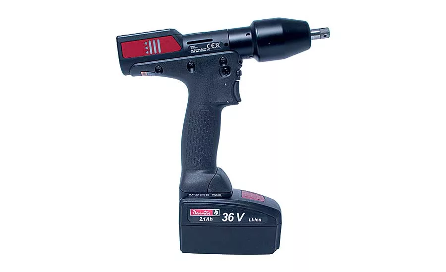

Hydraulic pulse tools are known for their ergonomic benefits and fast run-down speeds. The chief drawback of these tools is maintenance: The hydraulic fluid must be changed regularly.
The E-Pulse electric pulse tool from Desoutter Industrial Tools offers the benefits of a hydraulic pulse tool, but without the need for costly and time-consuming maintenance. The pulses are generated directly by the electric motor—there is no hydraulic fluid to change. The tool can complete more than a half million cycles before any preventive maintenance is needed.
Available in both cordless and corded models, the tool has a maximum free speed of 4,600 rpm. The pistol-grip tool is equipped with a transducer to measure torque and angle. It can detect rehit or stripped fasteners; it can keep a batch count; and it can store data from 10,000 rundowns.
