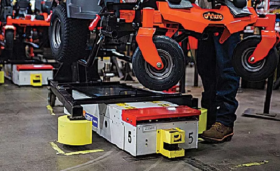

Framing mounted on each cart holds a riding mower that weighs up to 635 pounds, eliminating the need for an operator to manually push the mower from station to station. Photo courtesy Ariens Co.

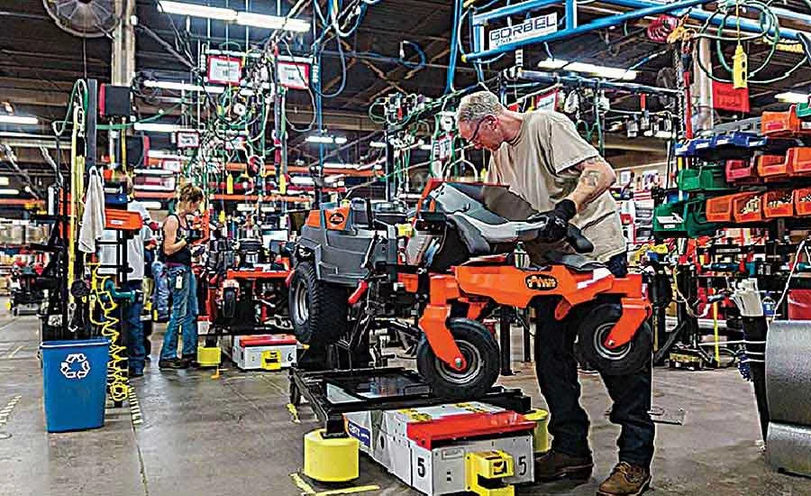

The SmartCart AGC (automatic guided cart) assembly system includes eight carts that stop at seven workstations, laid out in a straight line, during the assembly process. Photo courtesy Ariens Co.

The system includes eight AGCs that stop at seven workstations, laid out in a straight line, during the assembly process. Framing mounted on each cart holds a riding mower that weighs up to 635 pounds, eliminating the need for an operator to manually push the mower from station to station. The stations provide a stable and accurate production flow, and enable real-time productivity tracking.
The carts are guided by a floor-mounted magnetic tape path that can be easily reconfigured in response to product or volume changes. The carts are height-adjustable to optimize operator ergonomics and efficiency, and, according to Masters, they are smaller, cheaper and easier to install than traditional automated guided vehicles.
Implementing the system did require Ariens to replace its U-shaped workcell with a linear assembly line. However, the new layout gives operators and material handlers more access to both sides of the mower. Previously, the inside of the U caused a bottleneck because space got tight. Other system benefits include more consistent production, improved assembly sequencing and a simple way for assemblers to build commercial and residential lawnmowers on the same line.
