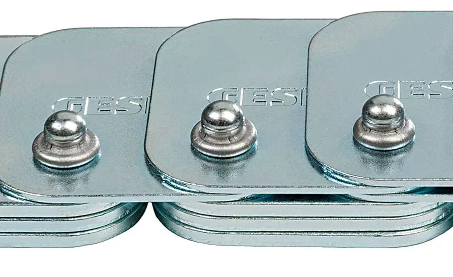

Gesipa’s Polybulb rivet features a unique large-diameter closing head that gently distributes pressure on sensitive and porous materials. Common automotive applications include joining composite materials when mounting loudspeakers, door modules, body and instrument panels, and seating.
“The closing head protects the rivet from being pulled out of the application, and the locked mandrel keeps the joint safely together even when exposed to high loads,” says Rogers. “In many cases, C-parts, such as washers, are no longer required.”
Rogers adds that the closing head is aesthetically pleasing, with a low profile. The rivet has a wide grip range and produces a tight joint that remains rattle-free when exposed to vibration.

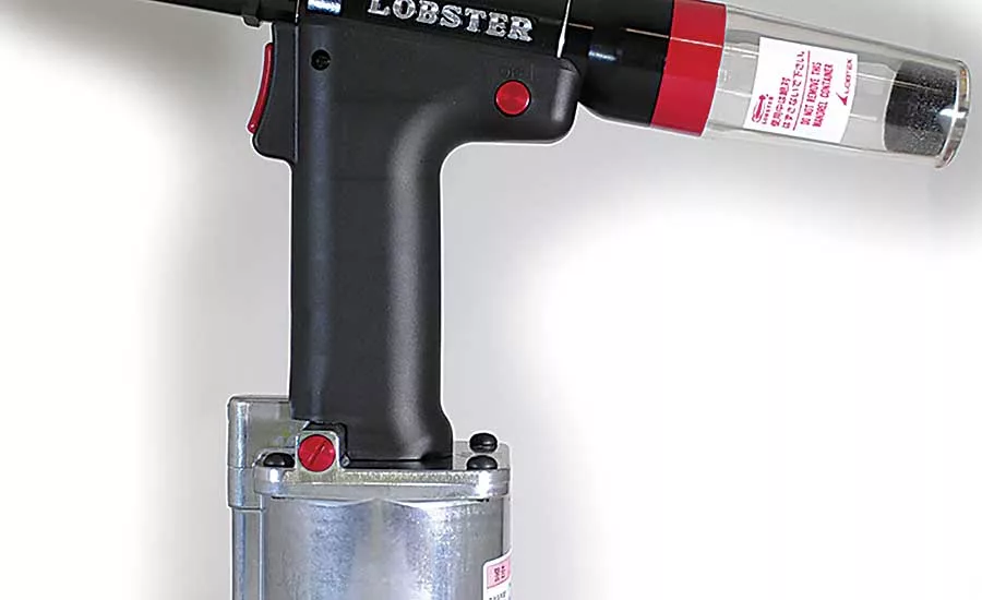

The pneumatic Lobster R1A1 and R1A2 rivet tools from Yamazen feature a stroke of 19 and 26 millimeters, respectively. Model R1A1 handles steel, stainless steel and aluminum non-structural rivets from 0.094 to 0.188 inch in diameter. The tool weighs 2.2 pounds and produces 2,200 pounds of traction pulling power.
In contrast, model R1A2 weighs 3.8 pounds and produces 4,000 pounds of pulling power. This latter capability enables it to install 0.188- and 0.25-inch-diameter rivets. Battery-powered
versions (R1B1, R1B2) weigh a bit more (3.7 and 4 pounds), but have pulling power (1,900 and 3,200 pounds) without the need for air. All four models feature a safety mechanism whereby the tool only works when its mandrel-collection tank is properly attached.

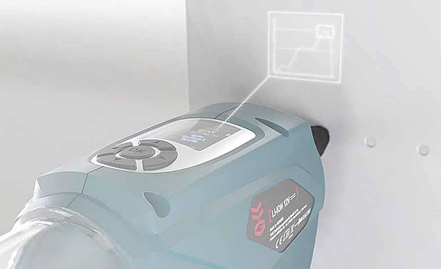

S-B Industries’ rivet tool with process monitoring capabilities is called RivSmart, the latest addition to the company’s Rivdom series. It features a display panel, built-in software that sends monitoring data to an IOS or Android app via Wi-Fi, and a 12-volt lithium-ion battery that generates enough power to install steel rivets up to 0.188-inch diameter.

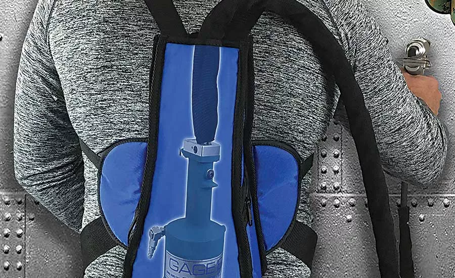

One of the newest types of blind-rivet tools is the split-system, where the tool base rests in a backpack while the operator holds the much-lighter pistol grip. Gage Bilt’s pneumatic GB7454SHV split-handle rivet system was originally developed for aerospace assemblers who had to install rivets all day with an 11.5-pound tool held above their heads. Assemblers in the auto and solar-panel industries now use the system as well.
The system features a 3-pound tool and an 8-foot vacuum hose that connects the tool and base. Lang says that a hydraulic version of the system features a 6- or 11-pound tool. Both systems can be equipped with either a vacuum bottle or tube to collect mandrels.
