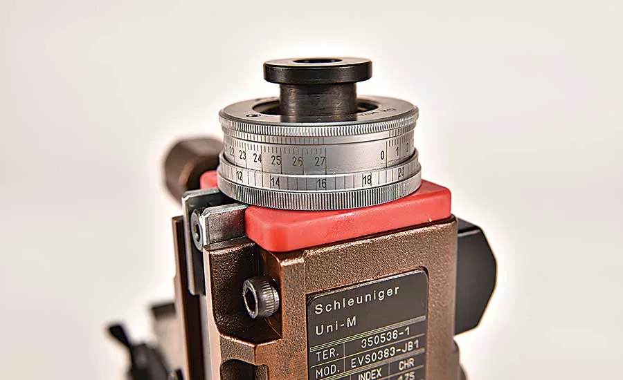

A ram collar (red piece shown in the photo) prevents collisions between the upper and lower tooling when the applicator is not installed in a press. Photo courtesy Schleuniger Inc.

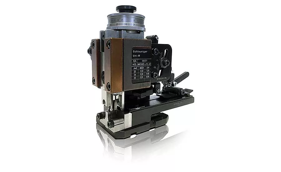

The Uni-M is a crimp applicator for use in both automatic and semi-automatic benchtop crimping machines designed for use with side and end feed, banded terminals of open or closed barrel construction. Photo courtesy Schleuniger Inc.

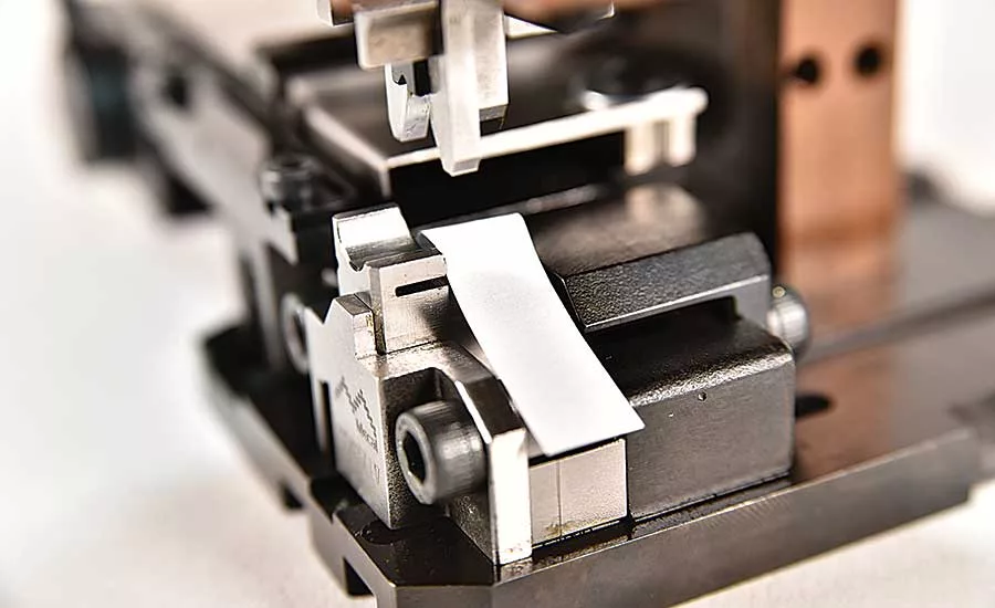

Tooling must be mounted properly to prevent excess wear. When replacing tooling, ensure that mounting surfaces are clean and in good condition. Crimp tooling must sit flush with the base plate and applicator ram. The upper tooling, or crimp dies, must be centered over the lower crimp anvil. A simple method to ensure that the upper tooling is centered is as follows:
1. Install the lower and upper tooling and hardware but do not completely tighten the screws.
2. Gently install the applicator ram ensuring the upper tooling does not contact the lower tooling.
3. Lay a thin strip of paper over the lower crimp anvil.
4. Gently but firmly push the upper tooling down over the anvil. While keeping downward pressure on the ram, tighten the screws to secure the upper and lower tooling.

Most applicators are shipped with ram collars. The ram collars prevent collisions between the upper and lower tooling when the applicator is not installed in a press that might damage the tooling prematurely. Signs of tooling damage may be scarring or marking inside the upper crimp die which can also appear as consistent marking on the crimped terminal. Rounded edges on the crimp anvil revealed by excessive flash or burrs on the terminal are another sign of damage.
Whenever an applicator is installed into a press, it is recommended to either hand-cycle or cycle the press in jog mode two or three times to ensure the tooling closes properly without collisions.
