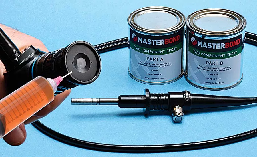

Find the Right Medical Adhesive
Certain epoxies that pass USP Class VI specifications are widely used in the medical industry for manufacturing and repairing endoscopes, surgical instruments, catheters and many other medical devices. Photo courtesy Master Bond Inc.

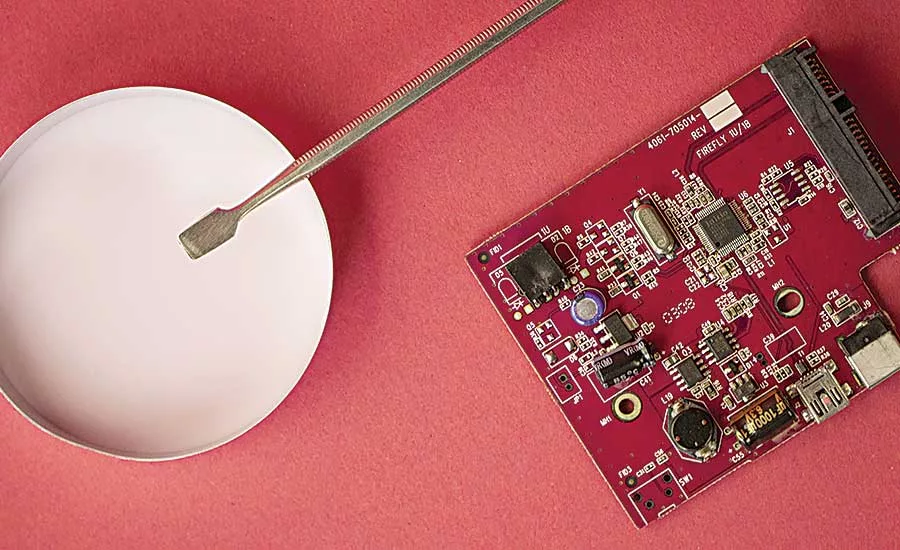

Electrically conductive epoxy adhesives that meet USP Class VI requirements may be used in medical electronic applications that require biocompatibility. Photo courtesy Master Bond Inc.
