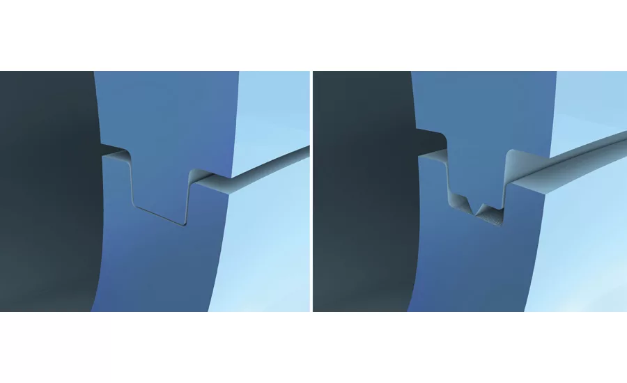

Incorporating rapid product volume scale-up capabilities into your manufacturing processes can greatly improve your company’s responsiveness to challenging market demands, such as those related to COVID-19. A key consideration could be to make design choices that keep your assembly options open to both adhesive and ultrasonic welding methods. Perhaps the easiest way to do this is to design a simple tongue-and-groove joint into the mating surfaces of the assembly. This type of joint offers an inherent alignment feature—the groove—that’s ideal for capturing adhesive and aligning the tongue of the mating surface. Coincidentally, it also produces a strong ultrasonic weld.
Should production needs or volumes change, it is a straightforward process to convert a tongue-and-groove part from adhesive assembly to assembly using ultrasonic welding. All that is required is the addition of an “energy director”—a small bead of sacrificial weld material—to the bottom of the existing tongue. Typically, this can be done with a modest “steel safe” change to the mold. Then, during the weld process, the energy director on the tongue melts neatly into the groove, resulting in a very precise, high-strength weld joint that offers good sealing properties.
