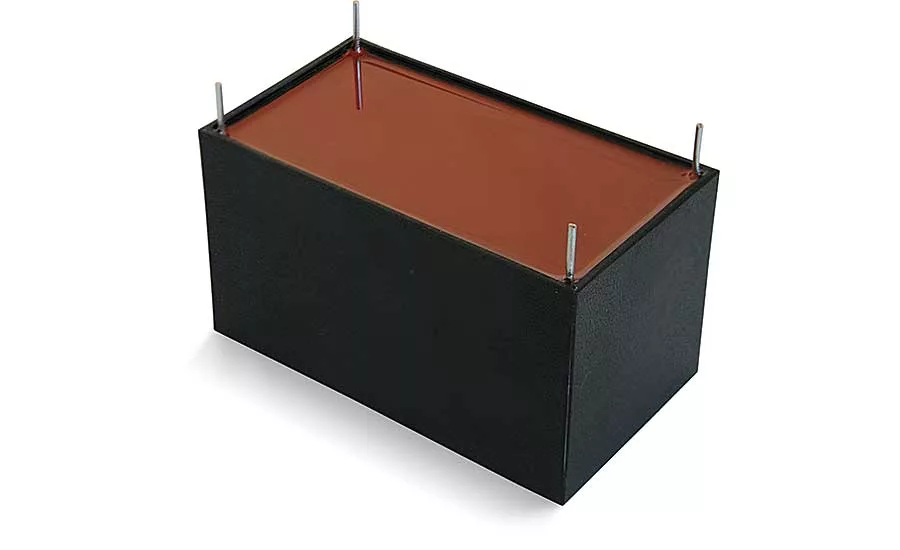

To function reliably over their entire service life, FTCAP’s film capacitors is encapsulated are vacuum with an epoxy. Photo courtesy Scheugenpflug.

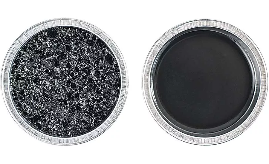

These photos show the difference in texture between a foamed PU that was exposed to moisture, left, and a PU correctly prepared and potted under vacuum, right. Photo courtesy Scheugenpflug.

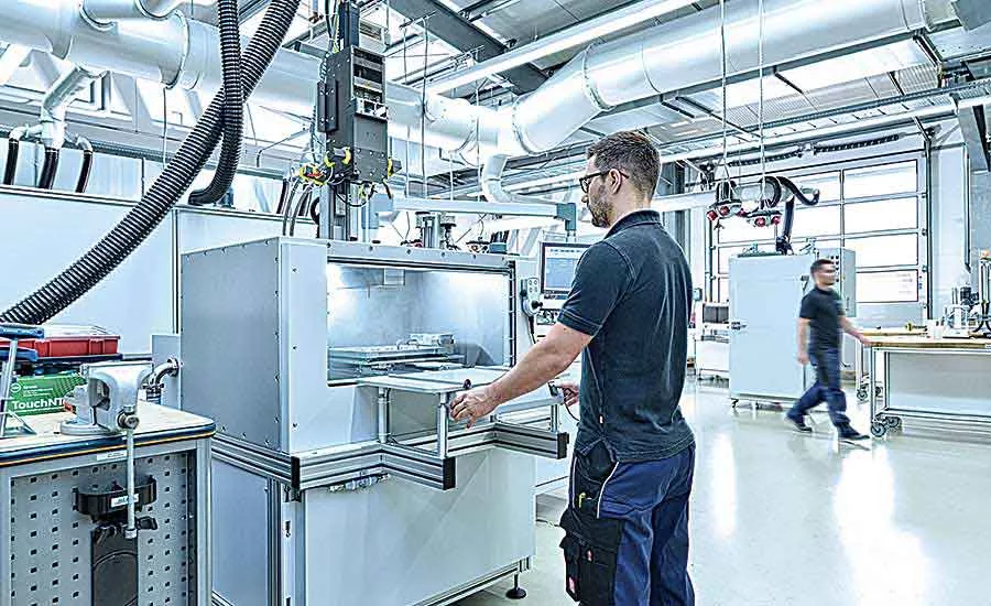

At Scheugenpflug’s Technology and Application Center, an expert technician pots capacitors under a vacuum. Photo courtesy Scheugenpflug.

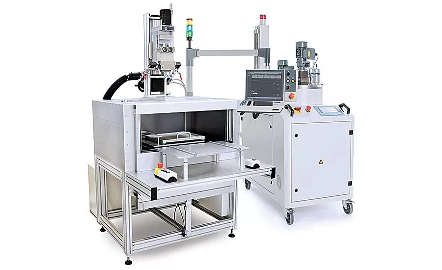

With three traversing axes, the VDS U vacuum dispensing system is suitable for potting several parts in one run. Photo courtesy Scheugenpflug.

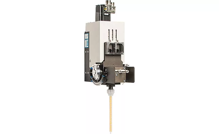

The Dos P016 dispenses two-component materials precisely and repeatably while maintaining a constant mix ratio. Photo courtesy Scheugenpflug.

Before deciding on a suitable system technology for the new encapsulation process, FTCAP looked for the right potting material. “For our ‘regular’ capacitors we use potting resins based on polyurethane. However, since the high-voltage capacitors come into contact with liquids such as transformer oil during operation, epoxy resins are more suitable here,” says Tausche.
Polyurethanes (PU) offer a very broad and versatile range of properties. PU compounds are characterized by good machine processibility, low volume shrinkage and moderate flexibility after curing. However, polyurethanes are very sensitive to moisture and must be adequately stored and prepared under vacuum before potting.
In comparison, epoxy resins are characterized by good temperature stability, low flammability and elevated glow-wire ratings. Due to their high hardness, high modulus of elasticity and good mechanical stability when cured, these potting materials are also well-suited for components used in demanding operating environments. The low moisture absorption and the high chemical resistance of epoxy are also key properties for this application.

VDS U: One for All
In the course of the dispensing tests, Scheugenpflug’s vacuum potting system achieved good results with regard to bubble-free operation and repeatability of the potting process. The universal system is particularly suitable for the series production of medium and large components. Even with difficult part geometries or complex casting programs, the VDS U is the system of choice.
The system is based on standard modules, much like the platform strategies of the automotive industry. This gives users maximum flexibility with short delivery times and attractive pricing. Even in the case of very cramped production environments, the modular components allow for a demand-oriented system design tailored to the respective application.

Scheugenpflug’s Dos P016 piston dispenser ensures the output of exact and reproducible material quantities. Not only does it cover a wide range of requirements, it also allows gentle dispensing of pressure, moisture or shear-sensitive potting media without the risk of material changes. To achieve optimum flow properties with the epoxy resin used, the Dos P016 was additionally equipped with a heating unit for the metering head and each mixing tube. They heat the material shortly before potting, thus reducing its viscosity and ensuring reproducible and bubble-free potting results, even with complex geometries.

At FTCAP, the capacitors to be encapsulated are manually inserted in the system. The encapsulation chamber is then evacuated up to a value of 20 millibars. Depending on their size, the housings of the high-voltage capacitors are then filled with epoxy resin in one or more steps.
Large capacitors in particular require multi-stage encapsulation to ensure the absence of bubbles. A defined amount of material is dispensed into the housing under vacuum so that the winding inside is completely covered with potting medium. During the subsequent ventilation of the vacuum chamber, the epoxy is pressed even deeper into existing angles and gaps by the ensuing pressure build-up. After the material has cured for the first time, a final top layer is applied.
The encapsulation process is followed by an optical inspection of the components by the system operator. “It is difficult to check the height of the encapsulation in the housings automatically because we already have tolerances in the film thickness of the winding,” explains Tausche. “The material layer on top of the winding should have a certain minimum thickness. Generally speaking, a slightly fluctuating filling level is no problem for us.”
In the final curing process, the potted epoxy is cured in a furnace at 80 C for two hours and at 110 C for another six hours.
