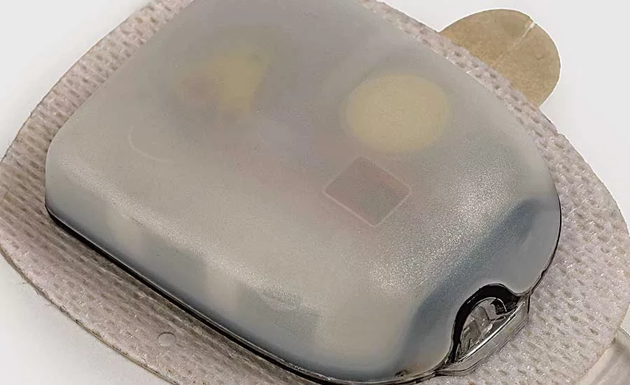

Medical device manufacturers, like Billerica, MA-based Insulet Corp., are among the biggest users of LPW. For the past seven years, the company has been using LPKF’s InlineWeld 6600 system to weld the outer plastic housing to the chassis of the Omnipod device.
Part of the Omnipod System, this device is filled with insulin by the patient, who then adheres it to his arm or abdomen. The other part of the system is a wireless handheld Personal Diabetes Manager that programs the pod device with the patient’s personalized insulin-delivery instructions, wirelessly monitors the pod’s operation and includes a FreeStyle blood glucose meter.
Insulet welds about 18 million Omnipods annually. Welding is done by a through-transmission process, where laser energy passes through a top component (the transmissive part) and is absorbed by the bottom component (the adsorptive part). The energy locally heats and melts the surfaces at the joint interface, and, with the application of a controlled clamp force, the parts are joined.

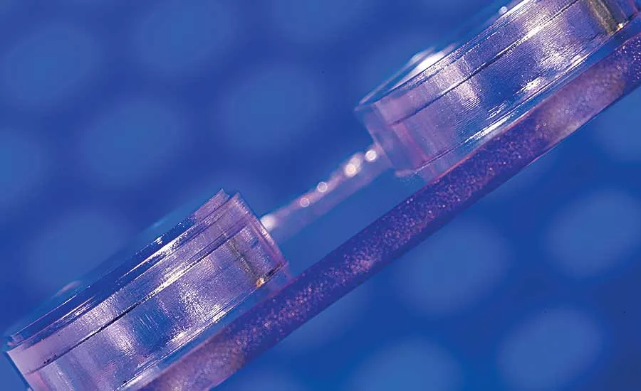

Keeping parts stationary is a must for precise LPW. To ensure the creation of high-quality microfluidic components, LPKF’s PrecisionWeld 3000 transparent welding machine uses Differential Pressure Clamping Technology. The machine’s clamping tool applies internal pressure to create a homogenous pressure ratio and 100 percent contact between the lower and upper parts. With this technology, any burrs are reliably bridged over and positively locked.

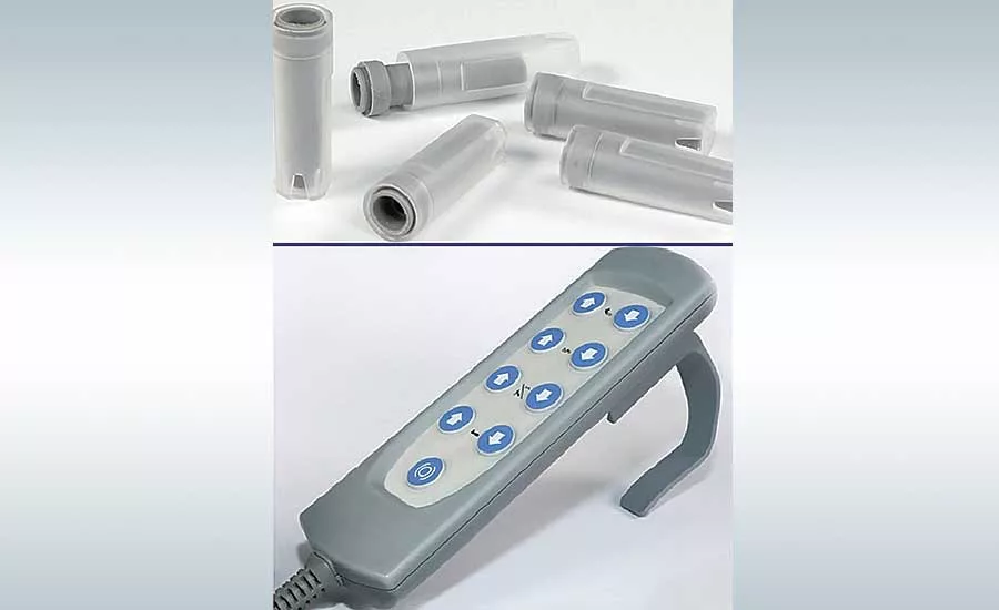

Many types of plastic parts for medical devices are laser welded. High-volume disposable components are common, such as filtering elements, blood-analysis-device parts and those with noncomplex housings. Others include diagnostic cartridges and products with plastic tubing (like catheters) or bags (for medicine or bodily fluids).
“Because of LPW’s ability to join components that are just a few millimeters in size, it is becoming the technology of choice to weld today’s increasingly advanced medical technologies,” says Tom Hoover, senior medical and business consumer electronics market manager for Branson at Emerson. “These include complex cardiac devices, wearables, microfluidics, devices for in-vitro diagnostic or drug delivery, sterile kits, implants, tissue-engineering, implantables, stent assemblies, lab-on-a-chip devices and optical scanning equipment.”

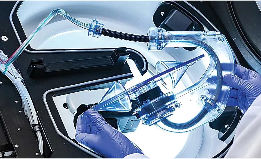

Dukane’s laser-welding workcell is capable of welding clear-to-clear plastics, and designed to weld medical device components of different sizes, including most common tube-to-port assemblies. The system’s 2-micron laser enables highly controlled melting through the thickness of optically clear parts, while LaserLinQ software harmonizes the action of a multiaxis servo gantry and a scan head to precisely control the laser beam movement. Alex Savitski, Ph.D., chief engineer for advanced technologies for Dukane, says that the software also lets users break complex weld patterns into separate geometric segments, and modify and assign different welding parameters to each segment. A built-in CCTV camera provides a live weld preview on the HMI screen and can monitor and record welding cycles for further analysis.
Healthcare technologies company Invetech uses the workcell to manufacture a consumable for its counterflow centrifuge (CFC) instrument. Researchers in the emerging cell therapy industry use the device to help develop new therapies for the treatment of cancers and other illnesses. Good Design Australia, an international design promotion organization, recently named the CFC a 2017 winner in product design for medical and scientific products, notes Mike Luehr, applications technology manager at Dukane.

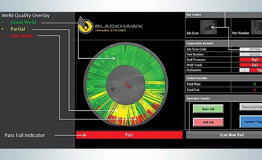

On the quality control side, several technologies and practices can ensure a good weld every time. Most of Blackhawk Technology’s focus is on infrared (IR)-based systems that perform three types of post-weld non-destructive analysis: bond integrity inspection, part location and material defect recognition.
According to Hamilton, the system is designed for just-welded opaque parts that are IR transmissive on the top and IR absorbent on the bottom. After such a part is bathed in IR radiation, the inspection system is activated. Its custom camera, lens and filtering have an illumination design that catches the IR radiation reflected off the internal part and allows the camera to see through the opaque part. Built-in proprietary software reliably performs all three types of analysis in milliseconds, making the system effective in manual or automated applications.
