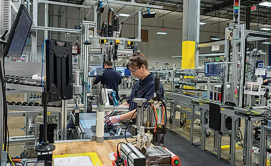

Parts presentation is a key factor in work efficiency and productivity. Photo courtesy Bosch Rexroth Corp.

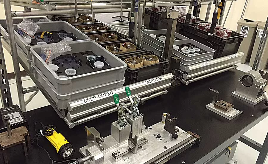

Parts kitting can help reduce line-side footprints and make it easier for operators to do their job. Photo courtesy Lean Factory America LLC

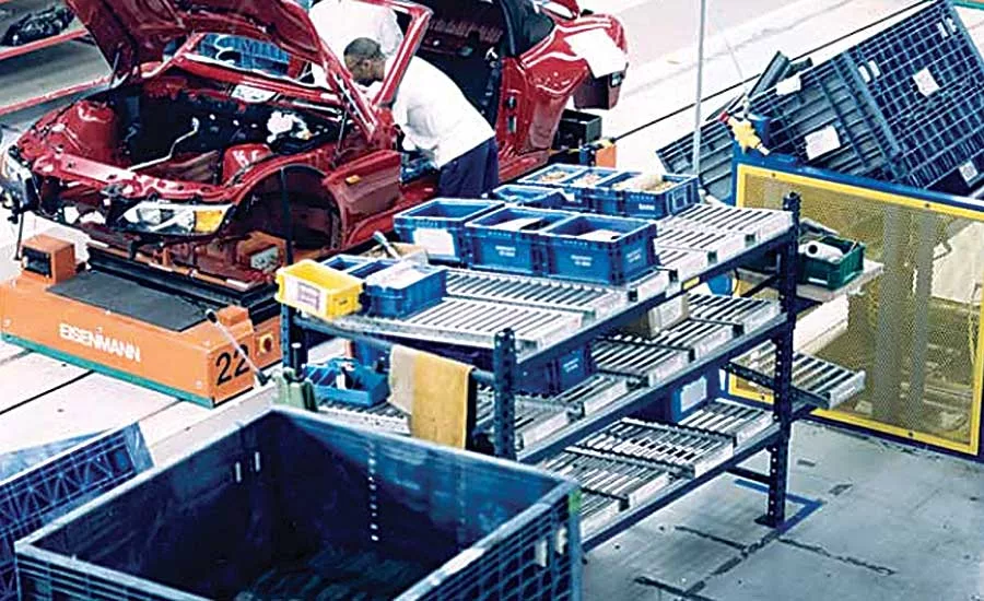

Flow racks are popular, because they can be replenished from behind without disturbing assemblers. Photo courtesy UNEX Manufacturing Inc.

“Parts presentation is a key factor in work efficiency,” adds Lori Bechtler, product manager for manual production systems and aluminum at Bosch Rexroth Corp. “If operators are waiting for parts or leaving work areas to gather parts for production, that is waste.
“Extra reaching, unnecessary movement in and around the workcell, and parts placement without regard to the assembly sequence [is also] waste,” Bechtler points out. “It can be discovered quickly with time and motion studies, or even by simple observation with a stop watch.

Flow racks are popular, because they can be replenished from behind without disturbing assemblers. However, most experts suggest using small bins or containers that don’t weigh more than 35 pounds.
“Gravity-fed flow racks may help, but under extreme circumstances the operators may not even have time to dispose of an empty bin,” notes Greissinger. “This is where flow racks outfitted with karakuri—low-cost automation based on gravity, springs, counterweights and levers—can enable a one-touch or no-touch box exchange.”
“Flow racks are essential for lean manufacturing,” says Harris. “But, the shelving should always be adjustable. If it’s engineered correctly, the operator should have no choice but to do first-in, first-out. Simple two-bin systems are ideal for fasteners, nuts and other highly repeatable, low-cost items.”
Kits of parts can also help reduce line-side footprints and make it easier for operators to do their job. Each kit should give assemblers all the parts and tools necessary to complete the specific components they are building.
“Frequent product changeover requires a certain degree of repeatability,” says Verrill. “For instance, three different product builds require different hardware kits, depending upon the product being assembled.
“If parts are fed to the operator with different kits for each product build, the kit itself usually should be located in roughly the same access position,” adds Verrill. “Non-related parts for any given build should be removed from the area to ensure accuracy.”
Kitting works well when you have a small area to present parts and many parts are required. But, it comes at a price. It typically takes five times longer to kit parts as it does to deliver parts.
However, many manufacturers have benefitted from parts kitting. “Toyota’s Georgetown, KY, plant recently achieved a 5 percent improvement in productivity, even though they had to add extra people to prepare the kits,” notes Rahn.
