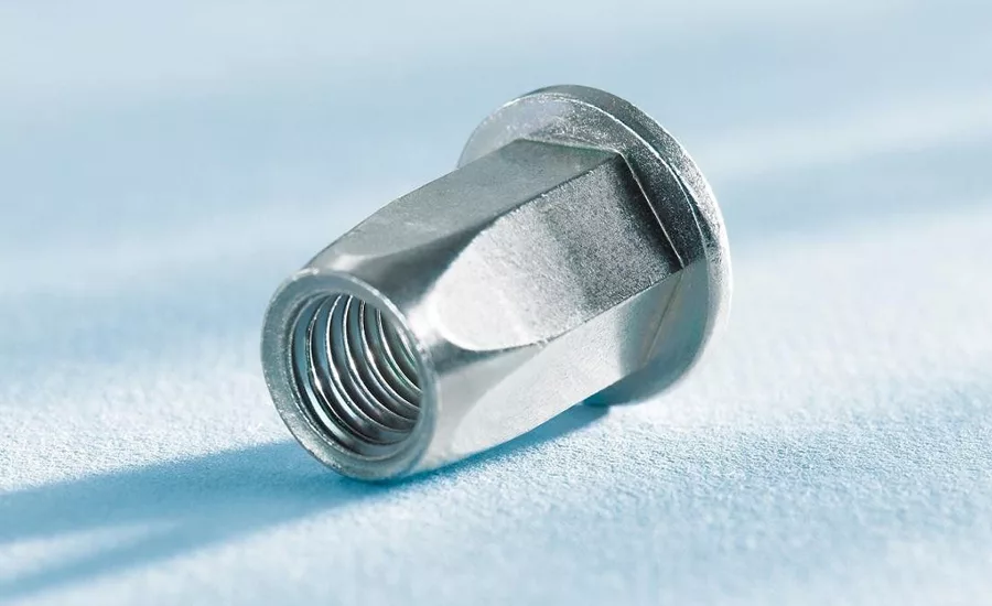

Rivnut fasteners are internally threaded fasteners produced by Bollhoff Rivnut Inc. (Kendallville, IN) that can be installed in seconds by a single operator from one side of the work. When in place, they form secure nut plates with clean threads for screw attachments. The fasteners stay firmly anchored, even when repeatedly assembled. They are available in more than 5,000 sizes and styles. The style used on General Motor’s sport utility vehicles features thin-wall shanks that compress during installation, forming large flanges. These flanges spread loads evenly over a large area. This provides outstanding pull-out resistance. Other benefits include wide grip range, and exceptional torque and thread strength.
These fasteners are commonly used in the automotive industry for attaching carrier racks and other external components to automobile and truck bodies. They provide a durable and inexpensive method of attaching hardware. They can be bolted securely to a sheet metal body without requiring access to the other side.
