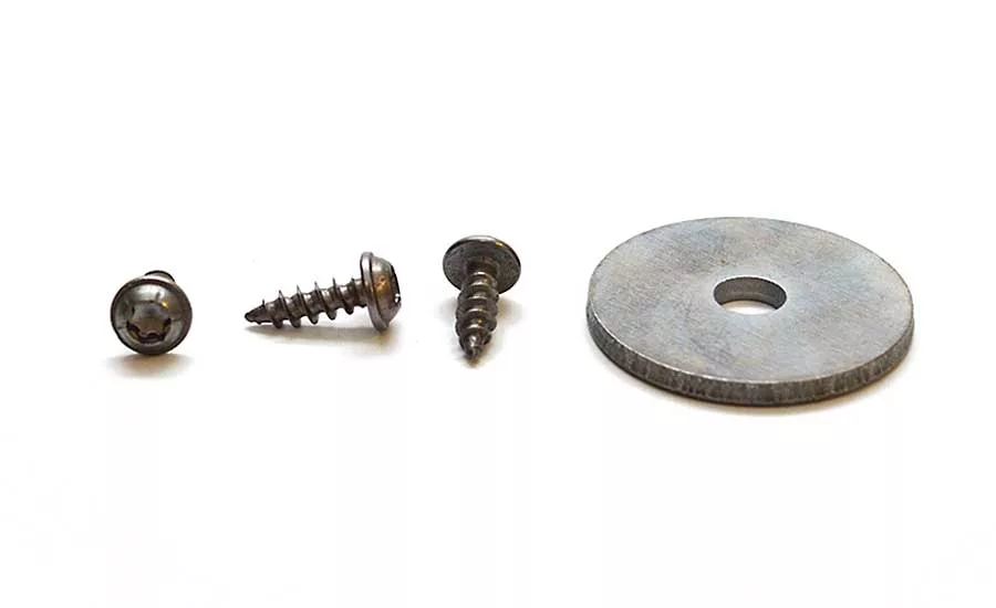

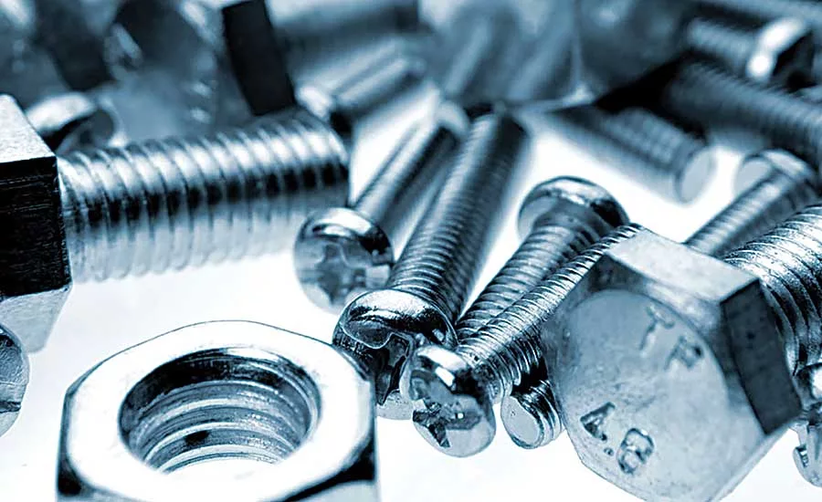

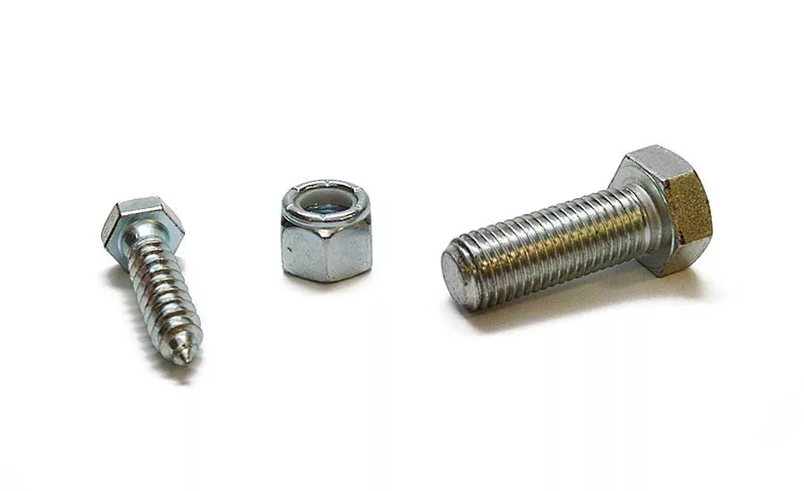

Electrodeposited zinc or “commercial” zinc
  • Safety: hydrogen embrittlement risk for high strength fasteners.
  • Corrosion protection: mild to moderate.
  • Resistance to handling damage: moderate.
  • Critical joints: difficult to control friction.
  • Functionality: can be sued with small fasteners; no problems with threads or recesses.
  • Cost: low.
  • Availability: high.
  • Recommended for: any fasteners with a mild to moderate corrosion protection requirement and a hardness of less than 38 on the Rockwell C scale.

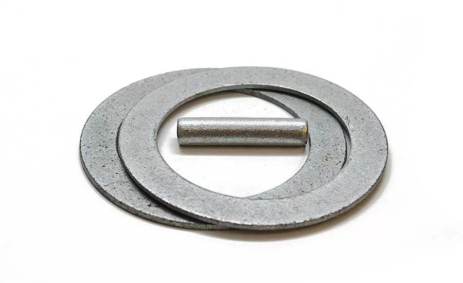

Mechanical zinc
  • Safety: no hydrogen embrittlement risk.
  • Functionality: poor coverage in recesses or holes; not recommended for threaded parts.
  • Cost: medium to high.
  • Availability: medium to low.
  • Recommended for: high-strength washers and pins with a hardness of less than 38 on the Rockwell C scale. Not normally recommended for threaded fasteners.

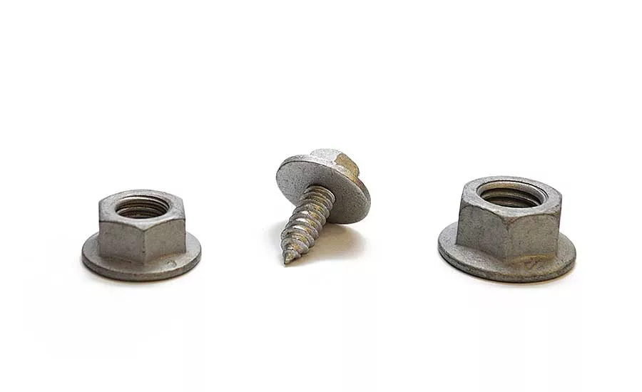

Zinc flake
  • Corrosion protection: severe to very severe.
  • Critical joints: excellent friction control properties.
  • Functionality: not generally recommended for threaded fasteners less than M8 or for any fastener with an internal drive feature.
  • Cost: medium.
  • Availability: medium.
  • Recommended for: larger fasteners (greater than M6) with severe to very severe corrosion protection requirements and for joints where clamp load is critical to maintaining joint integrity.
