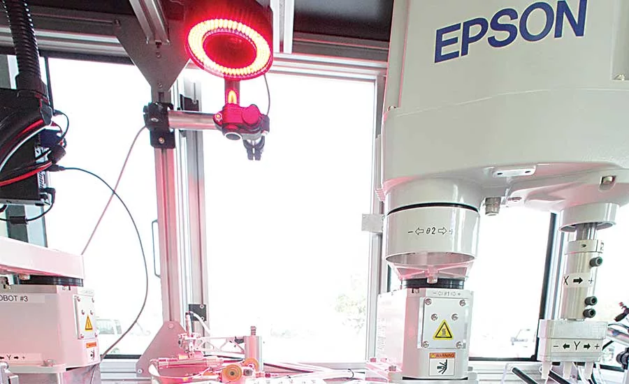

The assembly process starts with the piezoelectric material fed onto a conveyor from a vibratory feeder. A color-sensing camera determines the polarity of each two-sided piezo block. Any piezo blocks presenting bronze side up are rerouted through the feeder to present with the silver side facing up.

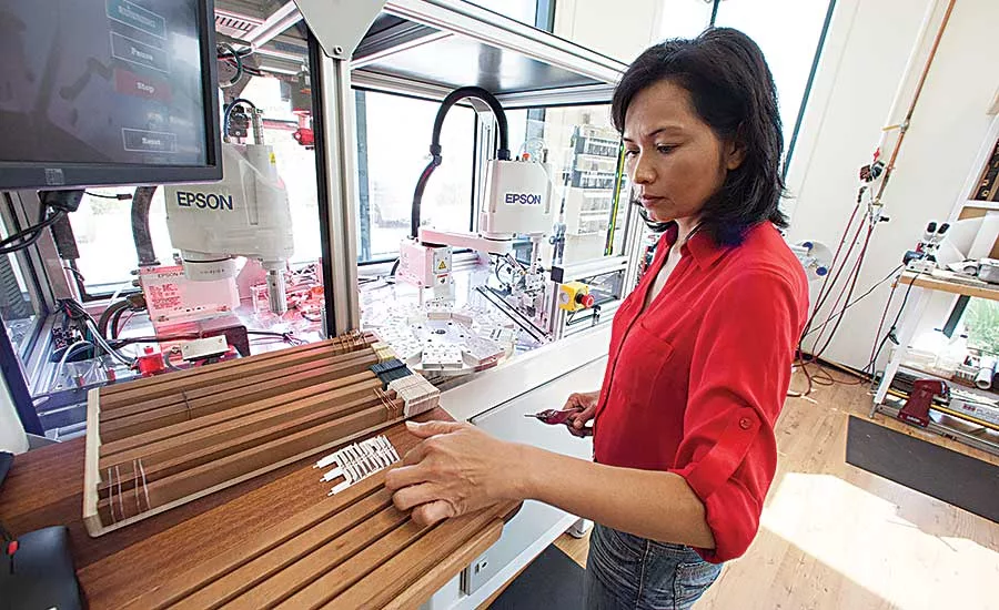

While the camera determines piezo block polarity, a worker inspects and places pieces of the assembly in the pickup molds, which are arranged on a rotary indexing table. The paper backing is removed from the adhesive by automated tooling custom-made by Taylor’s engineers.
Then, an Epson G3 robot places insulation and installs a printed circuit board (PCB). The other Epson robot is equipped with custom end-of-arm tooling to pick three piezo blocks at a time from the conveyor and place them in the appropriate slots of the pickup assembly. Once the piezo blocks and PCB are installed, the pickup assembly is folded and an Epson robot transports the completed assembly to a wrapping station.
Throughout the assembly process, a combination of machine vision cameras and a laser sensor are used to verify correct placement of the piezo blocks, assess final assembly and confirm the presence of components in the pickup assembly.
