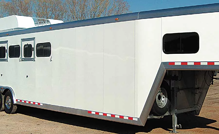

Bonding tape effectively adheres a design element to a panel, such as the exterior sidewall of a trailer. Photo courtesy 3M

Bonding tape is equally effective at adhering a stiffener, external element or structural glazing to a panel, such as the exterior sidewall of a trailer. Besides speed and ease of use, this approach avoids read-through. The tape foam also reduces vibration and noise caused by flexing of the thin-gauge panel material, such as a commercial baseboard air conditioning unit.
