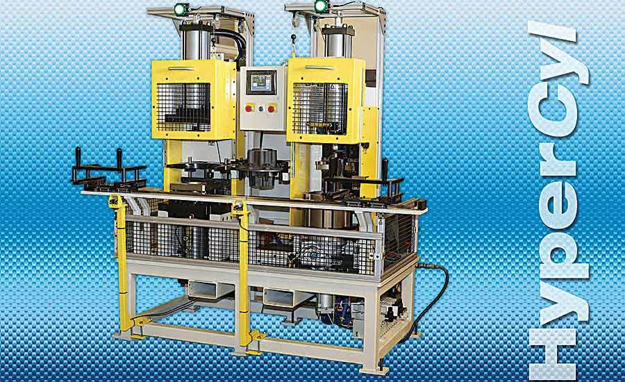

This hydropneumatic press setup is designed to insert studs into wheel hubs. Photo courtesy Aries Engineering Co. Inc.
Presses for High-Force Applications

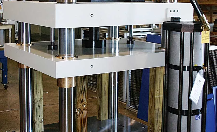

This 100-ton hydropneumatic press is mounted in a four-post, guided H-frame for stability and precision. Photo courtesy Aries Engineering Co. Inc.

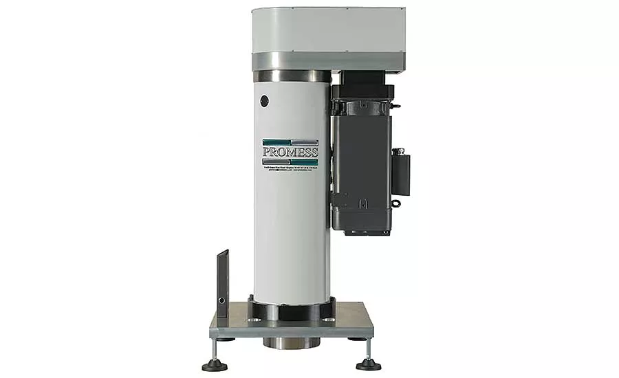

This servo press can generate more than 56 tons of force. Photo courtesy Promess Inc.

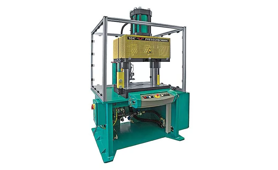

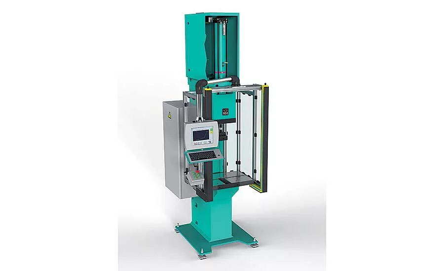

Hydropneumatic presses combine the speed, efficiency and low cost of pneumatic presses with the high output force of hydraulic presses. Photo courtesy TOX Pressotechnik
TOX Pressotechnik’s hydropneumatic press is unique in that it has a servo-controlled power package. That technology enables engineers to control the position of the ram with an accuracy of ±40 microns. Photo courtesy TOX Pressotechnik

TOX Pressotechnik recently accommodated an application in which a 100-ton press was used to press-fit eight studs simultaneously. “Instead of hitting the part eight times, you hit it once. A smaller press might run faster, but there’s no substitute for being able to cycle once rather than eight times,” says Troy Waldherr, North American sales manager for TOX.
Although forming or press-fitting multiple parts at once can save time, engineers should approach such applications with caution, advises Michael T. Brieschke, vice president of sales at Aries Engineering. “You want to center the parts around the centerline of the ram to prevent side loads,” he says. “If the parts are, say, 1 inch from each other, that’s not too bad. You can do that with a single ram. But, if they are 6, 10 or 12 inches apart, you might be better off [doing each part individually] and dropping the force down.”

Engineers have three technology options for high-force pressing applications: hydraulic, hydropneumatic and servo.
Hydraulic presses can generate tons of force. Some can produce more than 200 tons of force. However, hydraulic presses are not very energy-efficient, nor are they suitable for applications, such as medical device assembly, that cannot tolerate contamination from hydraulic fluid. Hydraulic presses are also less accurate than other press technologies. Hard stops are often needed to control ram position.
Hydropneumatic presses combine the speed, efficiency and low cost of pneumatic presses with the high output force of hydraulic presses. A hydropneumatic press consists of a hydraulic cylinder, an air-over-oil intensifier and an oil reservoir. At the start of the cycle, the ram approaches the workpiece at high speed, but low force, under
compressed air. Once the ram contacts the workpiece, the intensifier is
automatically energized by a directional control valve. At that point, hydraulic power takes over and the full force of the press is applied. At the end of the cycle, the ram retracts rapidly.
Because it uses compressed air as its primary power source, a hydropneumatic press requires less expensive piping systems and components. There’s no need to fill an oil tank with large quantities of expensive hydraulic fluid. Hydropneumatic presses are also lighter, more compact and more energy efficient than pure hydraulic presses.
TOX Pressotechnik’s hydropneumatic press is unique in that it has a servo-controlled power package. That technology enables engineers to control the position of the ram with an accuracy of ±40 microns, says Waldherr.
Servo presses are the most expensive option for high-force applications, but they’re also the most precise. “Electromechanical presses are used for pin and bearing insertion applications when high precision is needed,” says Nausley. “You can’t get that from pressing to a hard stop.”
Flexibility is another advantage of servo presses. “A lot of high-force applications are low-volume products,” says Nausley. “Lithium-ion batteries come in many different sizes, depending on the product they’re used in. Each size might require a different amount of force. To do that with a hydraulic press, you would have to constantly adjust the hydraulic pressure. With a fully electric press, it’s just a matter of changing the program.”

Aries Engineering’s 200-ton hydropneumatic press features a cylinder with a 12-inch bore and 1-inch thick walls. The machine’s steel frame is designed to accommodate high forces.
“With high-force applications, we spend a little more time sizing things accordingly,” says Brieschke. “We do a 3D analysis on the frames of all our standard presses, but with the high-force models, each one can be unique as far as the press frame.
“You want to make sure the press frame keeps flexion to a minimum,” he continues. “Flexion in a press will kill a job before it starts. Is the frame capable of handling a 50-ton load? Can it handle a 50-ton load over a five-year period? Sizing the press frame is where we start on high-force applications.”
With servo presses, roller screws tend to displace ballscrews for high-force applications. Depending on the speed requirement of the application, a substantially larger servomotor is not necessary. Rather, the higher output force is generated by a higher-torque gearbox.
Large size and high force do not necessarily translate into less accuracy. Engineers can take advantage of force and distance monitoring technology whether the application calls for 1,000 pounds of force or 100,000 pounds.
“Our large presses are just as accurate in terms of movement as our smaller presses. These monster presses can still move with accuracies of 5 or 10 microns,” says Nausley.
“However, a large press has a much bigger load cell,” he continues. “So, you will lose force measurement accuracy proportionally to the size of the load cell. Force measurement with a 10,000-pound press will be 10 times more accurate than it will with a 100,000-pound press.”
