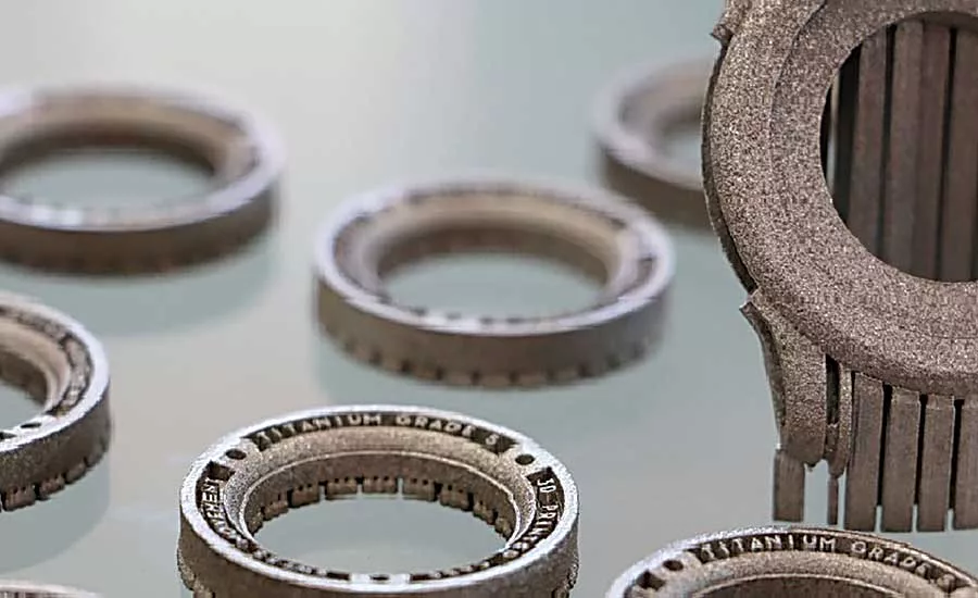

The case, crown and buckle of the Ornament 1 were printed in stainless steel 316L. The watch case has a diameter of 38 millimeters and is only 10 millimeters thick. It features a raised inscription of the Holthinrichs brand on its edge with the words “stainless steel,” “3D printed case” and “Swiss movement” in capitals on its reverse. These intricate details were only possible with additive manufacturing.
The batch of watches took approximately 30 hours to print on the Renishaw AM250 system. Following post-processing, the watches were returned to Holthinrichs, who finished them with hand filing and polishing. The post-processing, assembly and adjustment by hand took an additional 30 hours per watch.

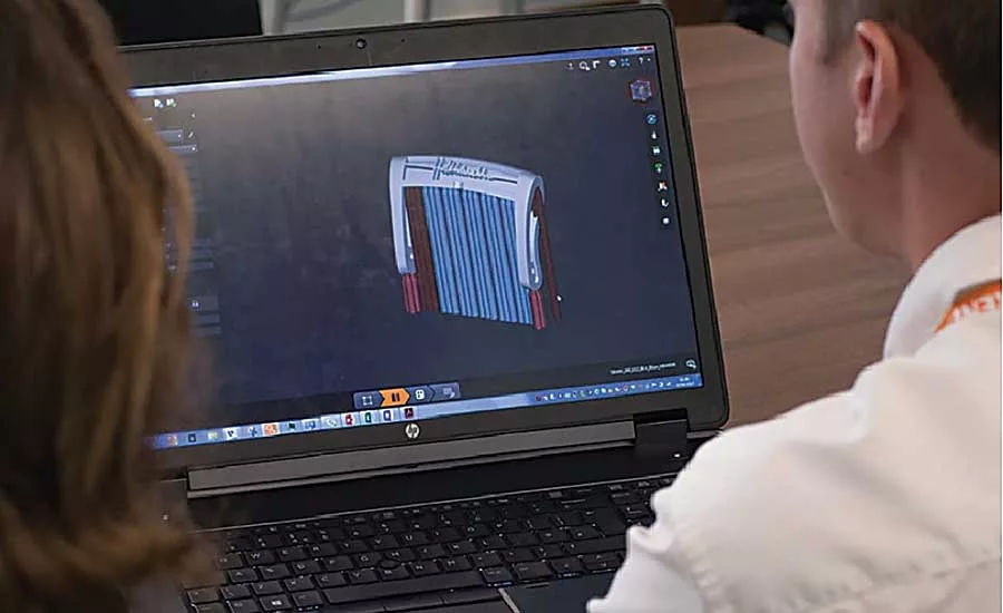

Based on the success of the Ornament 1, Holthinrichs wished to offer the watch in an alternative material. Renishaw recommended titanium because of the high-polished finish and that it’s suitable for investigating chemical post processing, which could reduce finishing time. Also, titanium is lighter than stainless steel, providing an additional difference in the design range. Through training at an AMSC, Holthinrichs was able to draw his design with 3D computer aided design software.
“If Michiel wants to tweak a design or change an engraving or a signature he can do that on his computer and there’s no knock-on effects further down the process line,” explains Charlie Birkett, a Renishaw additive manufacturing applications engineer who supports customers in the UK AMSC.
Renishaw exported Holthinrichs’ new design into its QuantAM build preparation software. Once the build was prepared in QuantAM, the file was sent to a Renishaw AM400 metal additive manufacturing system. The AM400 was chosen for its flexibility in terms of material changeover and ability to reproduce sharp corners and the fine detail in the design.
