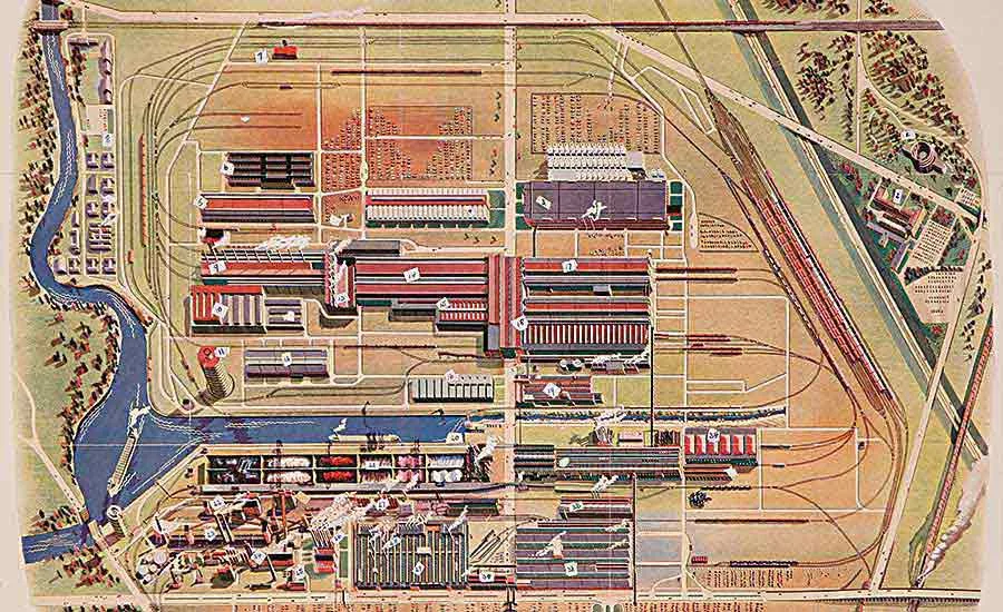

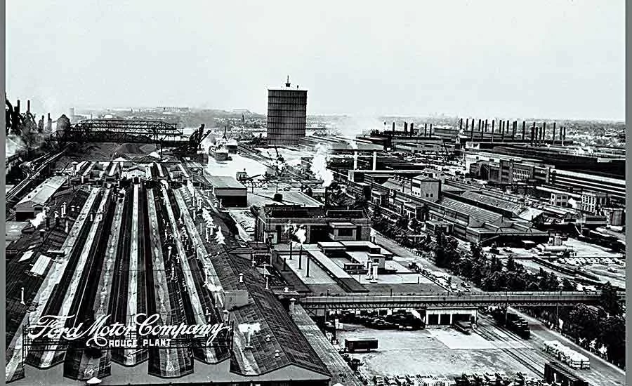

The Rouge was once hailed as the “world’s most famous plant.” This map shows the layout of the vertically integrated complex where iron ore arrived by ship and then rolled off the assembly line as finished automobiles a few days later. Courtesy The Henry Ford

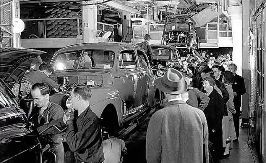

Thousands of visitors have flocked to the Rouge to get an up-close look at the automotive manufacturing process. In the days before OSHA safety regulations, public tour groups could get within inches of the assembly line. Photo courtesy Ford Motor Co.

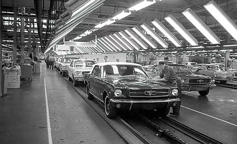

The iconic Ford Mustang first rolled off the Rouge assembly line in 1964. Photo courtesy Ford Motor Co.

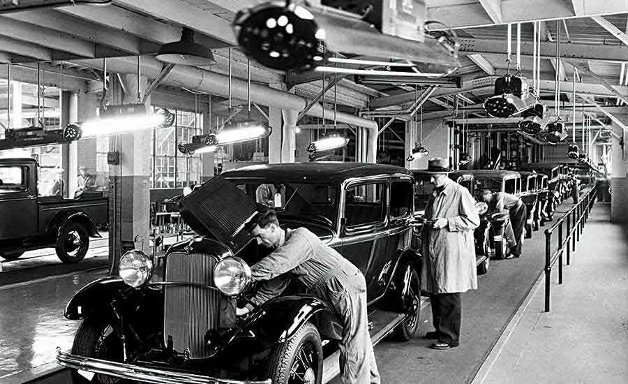

Since 1918, the Rouge has mass-produced a vast array of vehicles, including automobiles, ships, trucks, tanks and tractors. Three of Ford’s most iconic vehicles have been assembled there, including the Model A in the 1930s, the Mustang in the 1960s and F-150 pickup truck today.

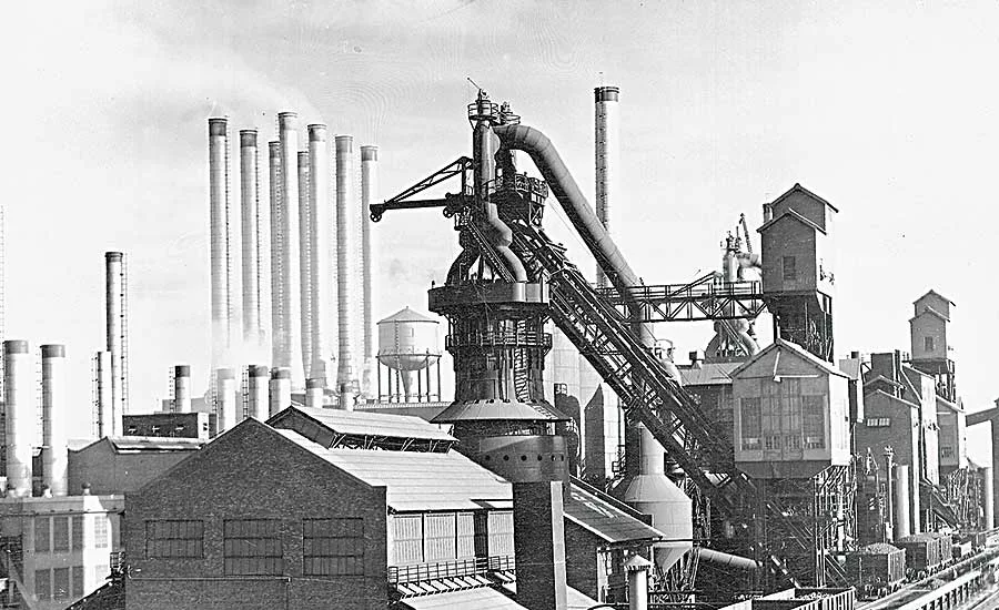

During its heyday in the 1930s and 1940s, the Rouge was a temple of vertical integration. The vast industrial complex included a steel mill, a glass factory, a power plant, a rubber factory, foundries, machine shops, stamping plants and assembly lines. It also included a cement plant, a paper mill, a leather plant and a textile mill.
All totaled, the buildings covered 16-million-square-feet of floor space. They were interconnected by 120 miles of conveyors and more than 100 miles of railroad track. During the height of its operation in 1948, the in-house railroad used 18 locomotives to move more than 1,600 freight cars daily.

The Rouge was once the equivalent of vertical integration on steroids. Henry Ford’s ultimate goal was to achieve total self-sufficiency by owning, operating and coordinating all the resources needed to produce complete automobiles.

Ford also bought up several thousand acres of land along the Rouge River southwest of Detroit and converted it into a self-contained manufacturing city. Between 1919 and 1926, it grew to include 93 buildings capable of producing 4,000 vehicles per day.
The original Rouge complex was a mile and a half wide and more than a mile long. The foundry alone covered 30 acres and employed 10,000 people.

Unlike Ford’s Highland Park and Piquette Avenue plants, which were multistory factories where the moving assembly line was developed and perfected, the Rouge featured one-story buildings that did not require elevators, ramps and hoists to move materials up and down.
“[Ford] was adamantly opposed to unnecessary effort, especially in moving materials,” says Brinkley. “He argued that a one-story building allowed for the smoothest movement of materials past men and machines.”
