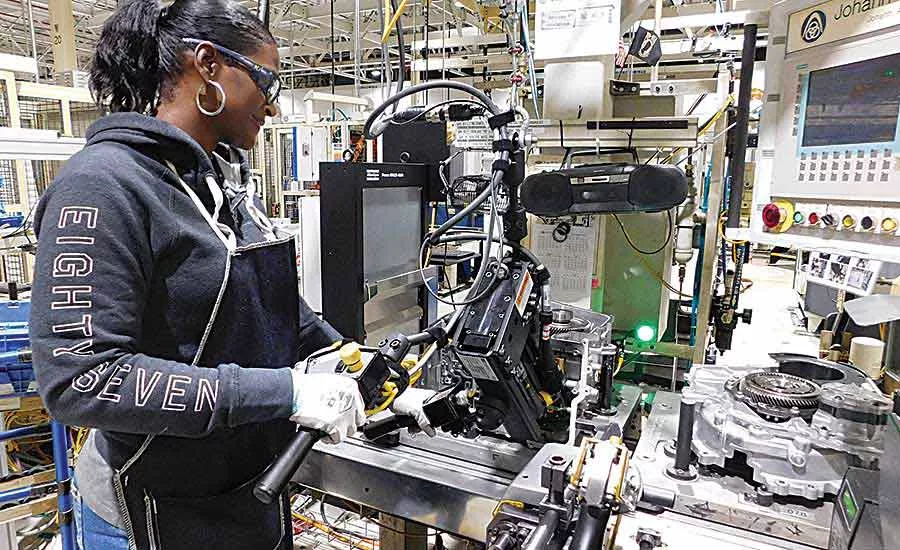

Workstations are equipped with lift-assist devices that enable operators to easily move heavy components and subassemblies on or off assembly lines. Photo courtesy Ford Motor Co.

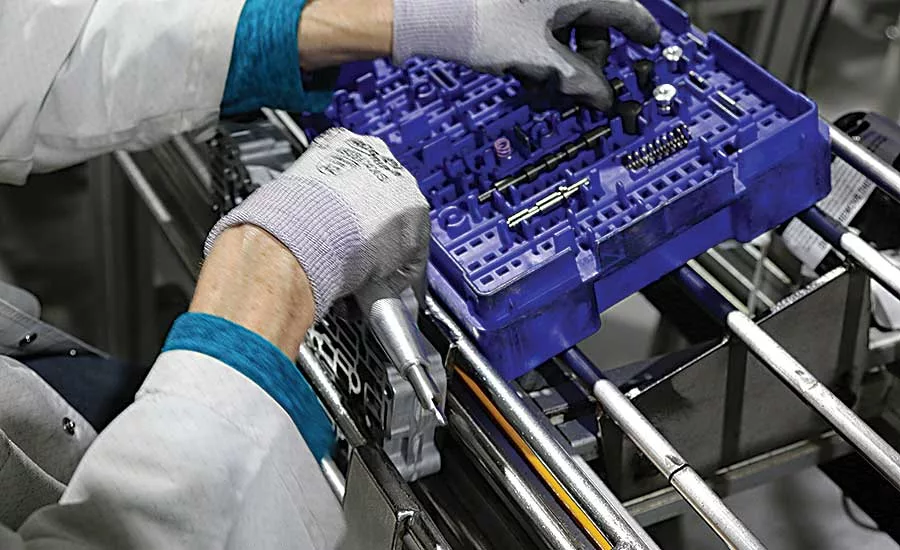

Ford Van Dyke uses parts kitting to reduce errors and improve quality. Photo courtesy Ford Motor Co.

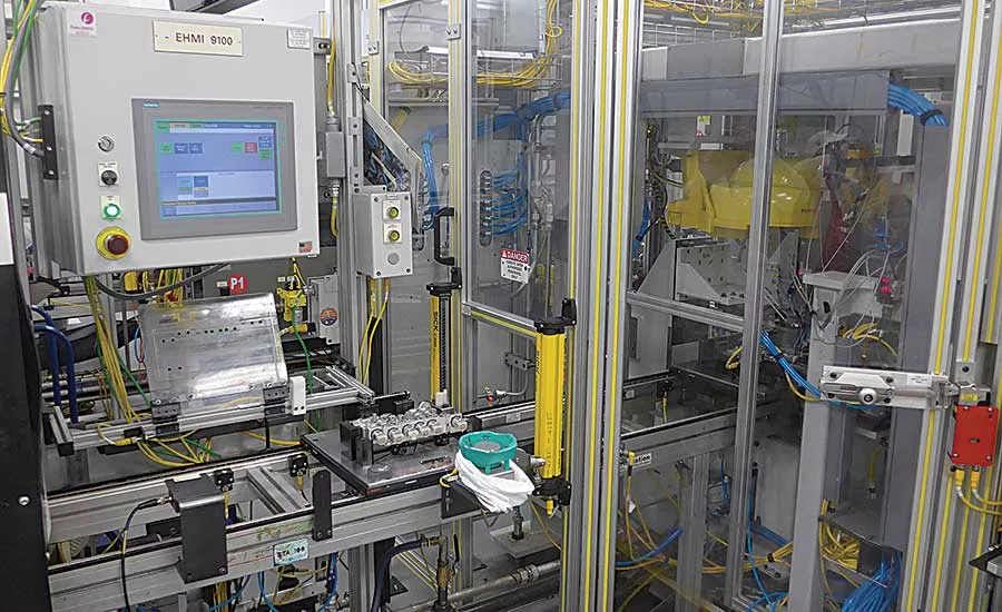

This high-speed delta robot is used to insert tiny retention pins in a valve body subassembly that controls shifting. Photo by Austin Weber

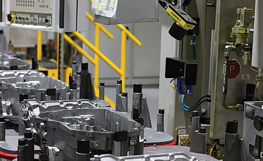

Inline machine vision applications address error proofing, gauging and complexity issues. Photo courtesy Ford Motor Co.

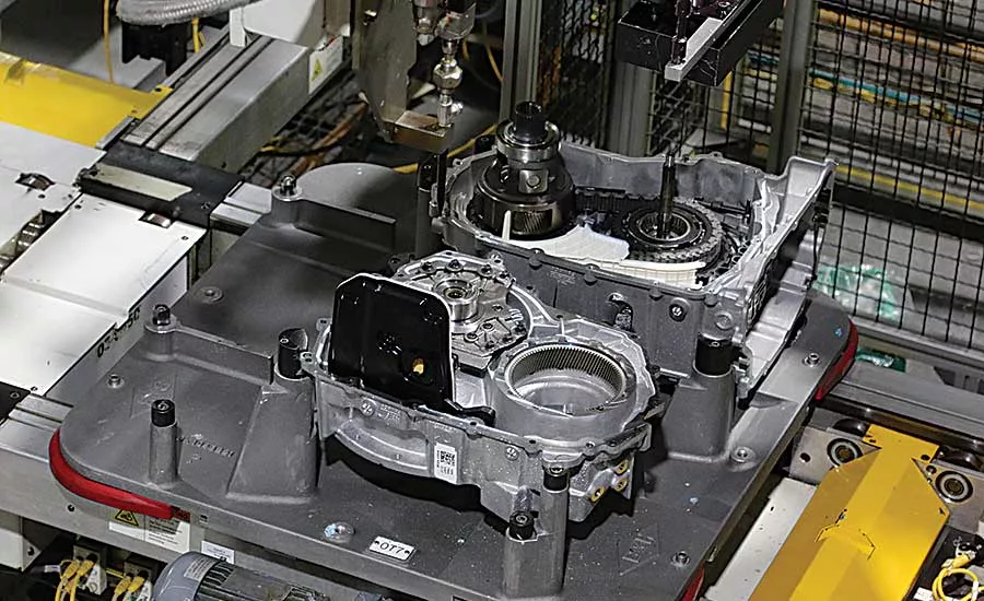

A transmission is typically built in two halves that are then fastened together. The outer shell contains the convertor housing.
The main control is the brain of the transmission. It contains electronic components that support the functionality of the transmission, such as enabling numerous hydraulic passages.
The case side of the transmission is built first. It holds the gear sets and decides the various gear ratios. Once the case build has been completed, an aluminum housing is attached. It has a unique shape that is determined by vehicle type and engine mounting patterns.

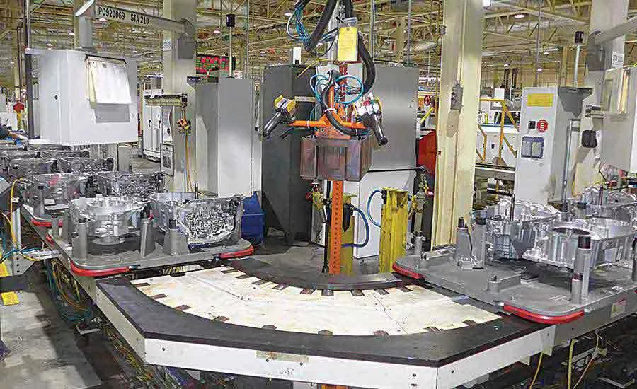

Assembly line layout consists of a pseudo horseshoe shape. The line is structured in a complete loop to allow pallet routing. Some assembly lines consist of a traditional circular pattern. Others weave in and out due to structure and floor space requirements
On most of the final assembly line, friction-powered roller conveyors are used to transfer pallets from station to station. However, some smaller parts are conveyed on a modular chain-driven pallet transfer system.
Parts kitting is used extensively to reduce errors and improve quality. Some parts are kitted in-house and others arrive from another Ford plant in Rawsonville, MI.
“Kitting reduces the potential of a misbuild,” says Linneburg. “It helps organize workstations by not allowing the operator to install incorrect parts. Kitting also reduces the chances of a bonus part and reduces congestion at workstations.
“There’s no need for gravity conveyors, silos, feeders or excess parts all over the floor,” adds Linneburg. “Kits are delivered to the final assembly areas on carts pulled by tuggers.”

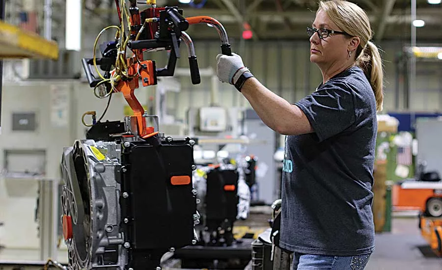

Many workstations are equipped with jib cranes and lift-assist devices that enable operators to easily move heavy components and subassemblies on or off assembly lines.

For instance, robots and vision systems are used to dispense sealant. A six-axis robot applies a bead of room-temperature vulcanizing silicone at variable quantities, speeds and angles. The application is validated with a vision inspection system that ensures the correct path and width of the bead.
One of the newest robotic applications at Ford Van Dyke is located in a clean room that assembles sensitive components. The automated station features two high-speed delta robots that each insert seven tiny retention pins in a valve body subassembly that controls shifting.
“The pins retain solenoids that must be aligned with a groove and casting pin bores to allow the pin to fall into the bores without interruption,” explains Reilly. “The pins are fed automatically and drop vertically through the robot’s end-of-arm tooling while indexing. Positions are determined by a camera that ensures accurate positioning of the robot.”
