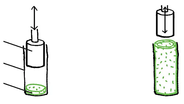

Impact extrusion is a cold process for forming metals that marries forging with extrusion. In a nutshell, backward impact extrusion is a method of forming hollow metal parts by striking a metal billet (or disk), which is confined within a cylindrical or square die, so hard that the metal is forced upward into the space between the “hammer” (or punch) and the die. The gap between the punch and the inside of the die determines the wall thickness of the final component.
There are in fact two types of impact extrusion, forward extrusion and backward extrusion. Backward or indirect extrusion is used to make hollow shapes, because the punch is solid and thrusts the material around itself into the space between itself and the die.
The other sort of impact extrusion, forward (or direct) extrusion, can only produce solid sections. In this instance the space between the punch and the die is too small to allow metal to wrap itself around the punch. Instead, the metal is hammered downward into a die forming a straightforward solid shape. Nevertheless, these processes can also be combined in a single operation, where the repeated action of the punch pushes material both upward (in order to form a hollow top) and downward (to make a solid, shaped base).
Designs that require outward tapering may need some post forming after extrusion, and any threaded sections, such as the bottle neck, are also added after forming.
