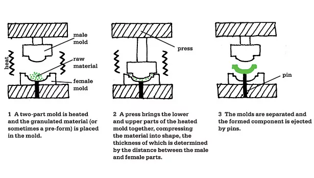

This process can be pressed into service for forming several different materials. On the one hand, it is used for producing ceramics, and on the other, it can be used to mold thermoset plastics (it was the original method for forming Bakelite), as well as fiber-based plastic composites.
To understand the basic principle of compression molding, just think of children jamming their fists into lumps of dough to create imprints.
The elaborated industrial process uses granules as a starting point rather than solid material, and heated molds to replace the fist. The two-part Into Solid: Compression Molding male and female molds can be used to process anything from thick, solid shapes to thin-walled containers.

Quick Guide
Volume of production
Can be equally suitable for batch or high-volume production.
Unit price vs. capital investment
In relation to other plastic-molding methods (for example, injection molding), tooling costs are moderate while still maintaining a low unit price.
Speed
Speed is affected by how long the mold remains closed, which is determined by part size and material.
Surface
Good surface quality.
Types/complexity of shape
Compression molding is often used for large plastic parts with thick wall sections, which can be more economically produced with this process than with injection molding. The nature of shaping objects with a two-part, male/female mold makes the process suitable for simple forms with no undercuts, but it also means that parts can have variable wall thicknesses.
Scale
Generally used for small parts of approximately 12 inches in any direction.
Tolerances
Fair.
Relevant materials
Ceramics and thermoset plastics such as melamine and phenolics, and fiber composites and cork.
Typical products
Melamine kitchenware (bowls, cups, and similar products) is often made with compression molding. Other applications include electrical housings, switches, and handles.
Similar methods
Hand and spray lay-up molding and transfer molding. And, although more expensive, injection molding could also be considered.
Sustainability issues
These depend upon the type of material used. As the process is often used for thermoset plastics, recycling parts made with this group of plastics is not an option. Wastage can be high because of the excess of material required to hold the material being formed firmly within the mold.
