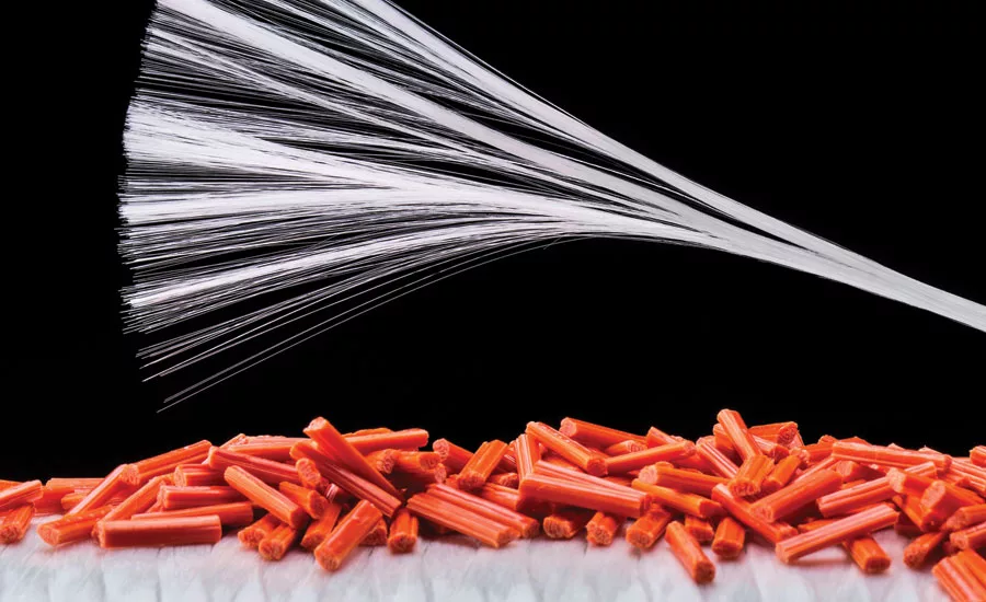

This highlights the continuous strands of fiber and resulting long fiber reinforced thermoplastic composite pellets that are produced. Source: PlastiComp

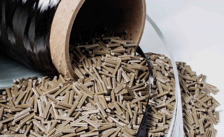

Fiber-reinforced plastics. Source: PlastiComp

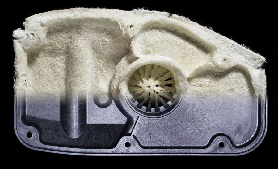

Burning away the plastic substrate of an injection molded part using pyrolysis reveals the internal fiber skeleton which is providing reinforcement. This method can be used to check for even fiber distribution and fiber alignment at key stress points. Source: PlastiComp

Compounding can combine a wide range of fibers into thermoplastic matrices to boost their mechanical properties, but glass and carbon fiber are the most common and universal types of fiber used to reinforce plastics.

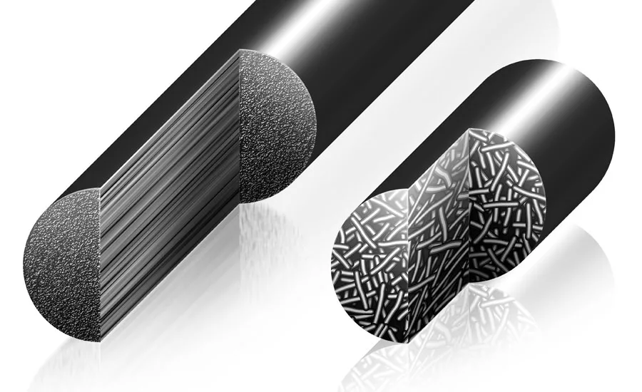

Most fiber-reinforced plastics are available in two variants: short fiber compounds and long fiber composites. In short fiber materials, chopped fiber filaments are melt blended with a host polymer using a compounding extruder. In long fiber materials, a pultrusion process impregnates continuous fiber strands with molten polymer.
As the names of these variants imply, the length of the fibers in the material are either short or long. The mean fiber length in short fiber material is typically less than one millimeter. In long fiber, the fibers are unidirectional through the full length of the pellet. For processing via injection molding, long fiber is cut into 1/2 inch (12 mm) pellets to facilitate material handling and feeding.

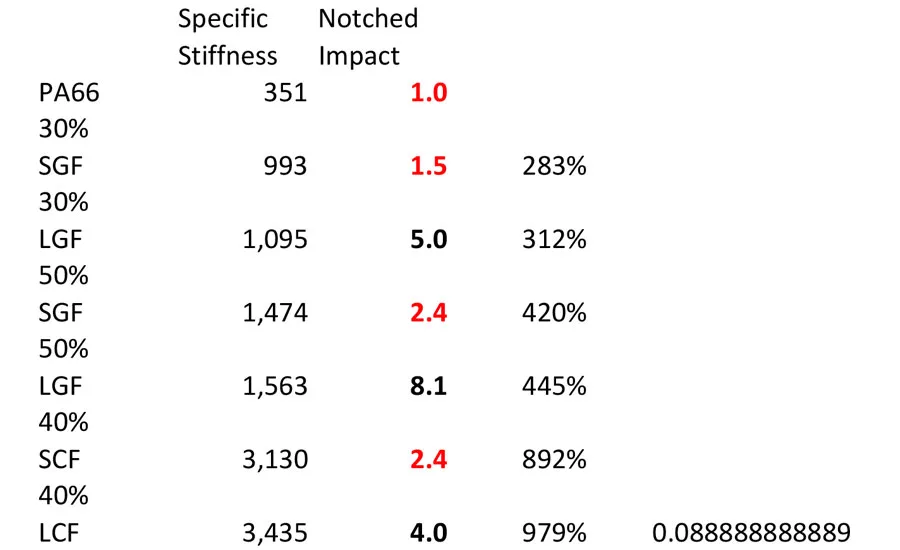

Gains in stiffness are more a function of the rigidity of the fiber used and the volume fraction of fiber included in the composite.
 Figure 2 illustrates this effect in nylon 6/6, short and long glass fiber loadings of 30% provide a relatively similar 3X gain in stiffness and as the glass fiber content is increased to 50% a similar 4X rise in stiffness occurs.
A significant boost in stiffness, almost 10X over the unmodified polymer, takes place when combining a 40% loading of more rigid carbon fiber into nylon. The difference in fiber length between short and long carbon fiber variants contributes just a modest 9% of additional stiffness.

In figures 3 and 4, the yellow lines indicate notched impact resistance. They show an incremental and stepped rise in composite durability as fiber content and length increases. Toughness up to 4X unmodified nylon is possible with carbon fiber reinforcement and an outstanding 10X with glass fiber reinforcement.
Although fiber alignment with flow occurs during molding, with longer fibers, particularly with more flexible glass fiber, there is some intertwinement to form an internal fiber skeleton within molded components. Because of this skeleton formation, long fiber composites are better able to resist crack propagation.
