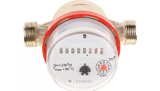

Nanopower AMR sensors can be used to prevent magnetic tampering of utility meters. Two sensors, mounted at 180 degrees from each other, will detect if an external magnet is used to alter flow accuracy. Source: Honeywell
