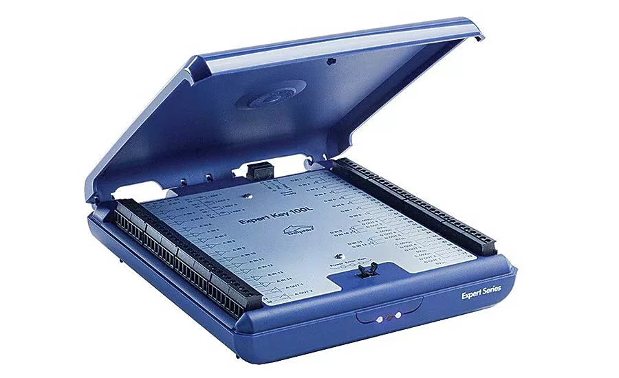

Connecting a sensor, such as a thermocouple, to a data acquisition system to obtain accurate measurements involves some forethought. For example, electromagnetic signal interference (also known as signal noise) and other factors can combine to negatively affect measurement accuracy—or possibly even damage the equipment. Understanding these factors is crucial to obtaining meaningful measurements.
This article addresses the four most common causes of measurement accuracy issues. These issues regularly occur when a data acquisition system collects data in typical industrial process applications.
Signal Noise
A leading cause of measurement errors, signal noise is caused by multiplexers in PC-based data acquisition systems, allowing cross-channel interference due to their capacitance. Multiplexer inputs store a charge proportional to their measurement system’s sample, or data collection, rate. This is why a high sample rate and the resultant data exchange can dramatically increase signal noise.

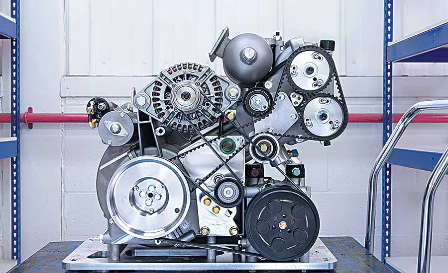

Electrochemical batteries are the most common way to store energy. Sometimes, however, it’s more effective to store energy as cold—in the form of liquid air. That is the central idea behind an innovative new zero-emission piston engine being developed by UK technology startup Dearman.
Liquid air can be kept safely in insulated, but unpressurized, tanks. When exposed to heat, liquid air will instantly re-gasify and expand 700-fold in volume. This expansion drives the pistons of Dearman’s innovative new engine. The engine operates like a high-pressure steam engine, but the low boiling temperature of liquid air means that ambient heat can be used as a heat source, eliminating the need for traditional fuel.
A unique feature of the engine is the use of warm water as heat-exchange fluid. When the water mixes with the extremely cold liquid air, the gas expands at a near-constant rate, which significantly increases the engine’s efficiency. The only emission from the engine is air. It does not emit nitrous oxide, carbon dioxide or particulates.
As a bonus, producing liquid air may not necessarily require much additional energy. Because liquid air is simply air that has been cooled to -196 C, it can be produced by recycling the huge amounts of cold energy that are typically wasted when liquid natural gas is re-gasified at import terminals around the world.
