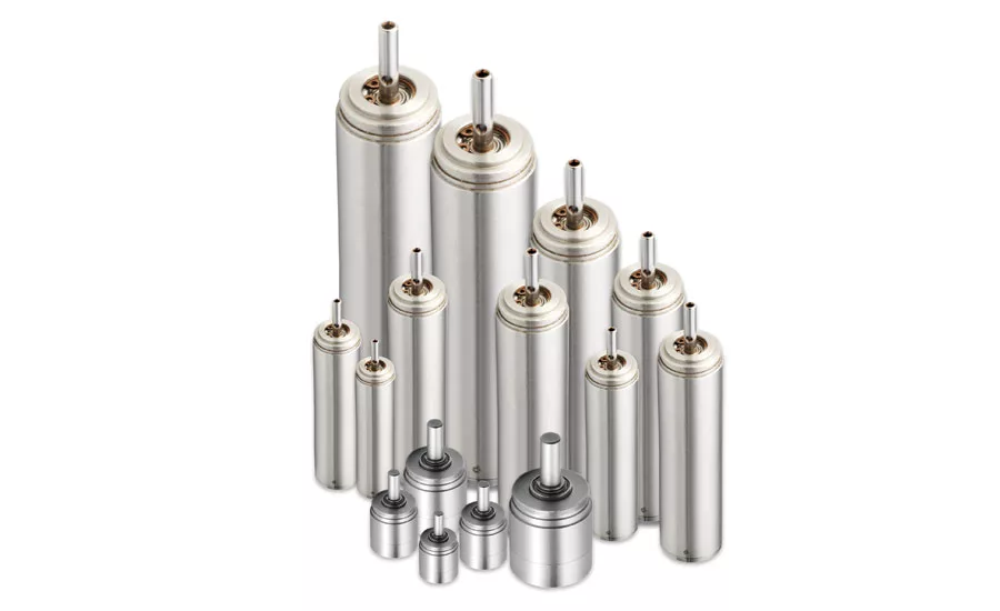

BLDC slotted motors and gear family. Slotted BLDC motors are preferable when the diameter is larger and a higher number of poles are required. Source: Portescap

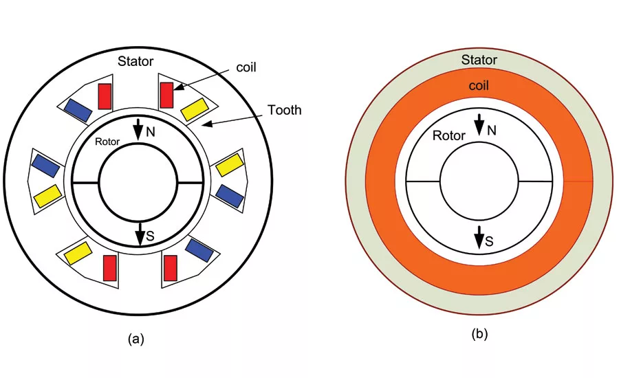

Fig.1. Type of BLDC motors (a) Slotted, (b) Slotless. Source: Portescap

Fig. 1 shows the cross-sectional view of a Brushless DC (BLDC) motor. In slotted BLDC motors (as shown in Fig.1 a), the presence of stator teeth prevents the overall size of the motor from being minimized. Moreover, the winding process becomes progressively more difficult as the motor shrinks in size [1]. On the other hand, the slotless BLDC motor (as shown in Fig.1 b) has either skewed or axial type windings fixed on the cylindrical stator iron core providing several advantages as well as small size.
Although the power density of slotless BLDC motors may be lower than that for equivalent slotted motors, the emergence of high energy permanent magnets (ex: NdFeB and SmCo) and its magnetization arrangements (e.g., radial, parallel and halbach) have promoted a renewed interest in slotless motors [2]. Also, easier manufacturing of the stator core is possible and this allows the design of the motor parts with a low degree of complexity. On the other hand, slotted designs do not take advantage of high energy magnets due to the reduced slot area and therefore reduced ampere turns.

In slotless BLDC motors, the stator winding differs from the conventional slotted motors which are inserted in the slots as shown in Fig.1 a. For example, the windings in the slotless motors can be self-bonded with skewed and cup shaped windings placed on the air gap. This motor can be analyzed in simple two dimensional (2-D) finite element method (FEM) based model, if the rectangular windings or axial coils are used [3].

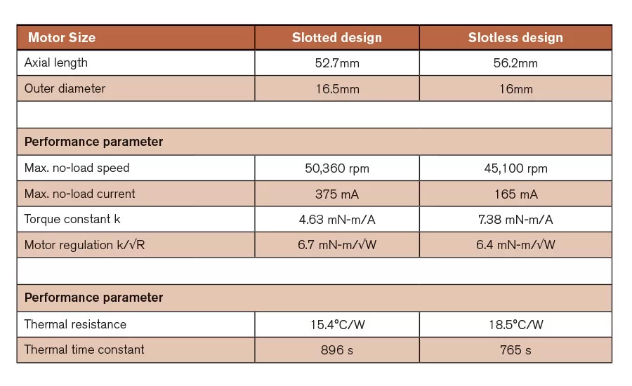

The table below details the performance of the slotted and slotless BLDC motor.
It can be seen that the removal of iron in the slotless design makes the motor more sensitive to overloading because its thermal time constant is reduced and therefore the stall current is limited.
