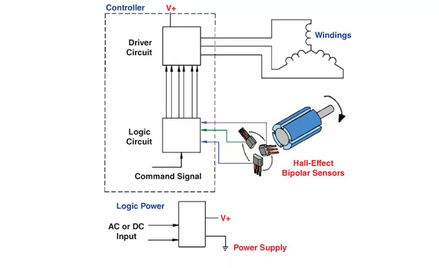

BLDCs use electronic commutation to control the power distribution to the motor, using Hall-effect sensors to measure the motor’s position. Source: Honeywell Sensing & Control

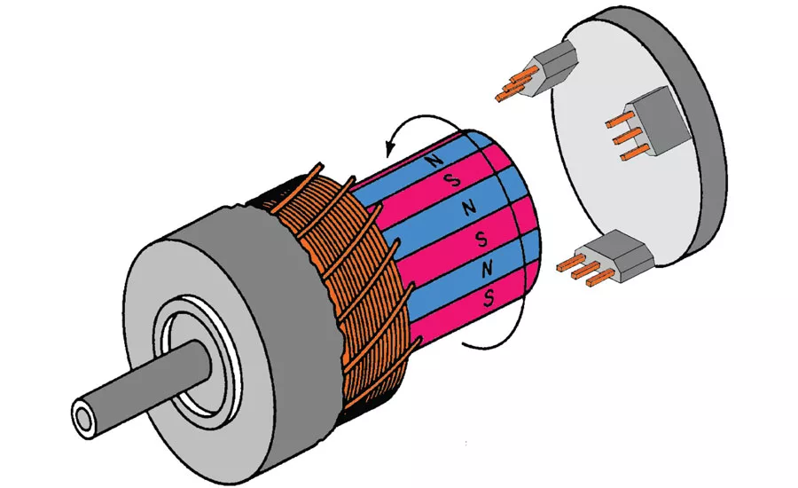

Bipolar Hall-effect sensors are used in BLDC motors to detect the position of the rotating magnet. In this example, an eight-pole motor with a three-phase winding uses three bipolar latching Hall-effect sensors. Source: Honeywell Sensing & Control

BLDC motors use electronic instead of mechanical commutation to control the power distribution to the motor. Latching Hall-effect sensors, mounted in the motor, are used to measure the motor’s position, which is communicated to the electronic controller to spin the motor at the right time and right orientation. These Hall-effect sensors are operated by a magnetic field from a permanent magnet or an electromagnet, responding to South (operate) and North (release) poles. These magnetic sensors determine when the current should be applied to the motor coils to make the magnets rotate at the right orientation.
