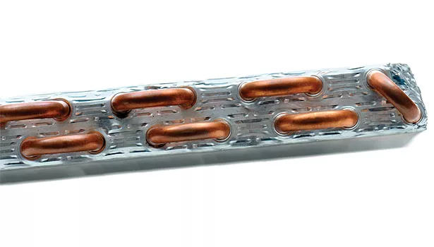

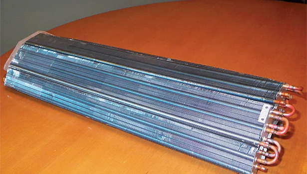

heat transfer single row coil
This single-row coil for an outdoor condenser unit of a split system from Midea features highly efficient, smaller diameter, inner-grooved copper tubes. The tubes are only 4-mm in diameter.

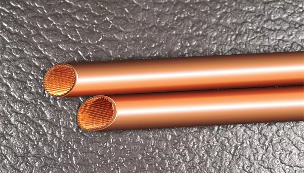

heat transfer copper tubes grooves
Smaller diameter copper tubes with inner grooves transfer heat more efficiently than conventional tubes, prompting the redesign of evaporator and condenser coils for many types of air conditioning and refrigeration products.

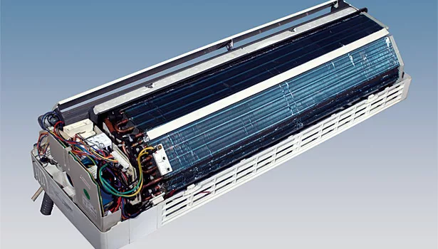

2600 w split unit ac kelon heat transfer
This 2600 W split-unit, room air-conditioner from the Kelon Corporation uses coils made with MicroGroove technology. The use of smaller-diameter copper tubes in the evaporators of the split units resulted in a higher coefficient of performance while reducing the total weight of tube material.

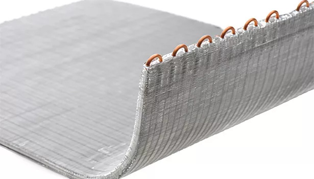

rtpf heat exchanger coils copper
Typically, in round tube plate fin (RTPF) heat exchanger coils, the fins are laced into the tubes, which are then mechanically expanded to make contact with the fins. The tubes are flared at the ends to allow for the insertion of U-bends to complete the tube circuitry.

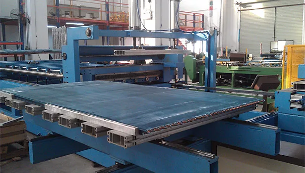

heat transfer factory board fins
Typically, the fins are laced into the tubes and then the tubes are expanded using a tube expander, such as this horizontal tube expander. Vertical tube expanders are also available to mechanically expand the tubes until they make contact with the fins.

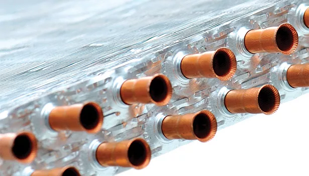

heated windows heat transfer
These are 5 mm tubes for window units.

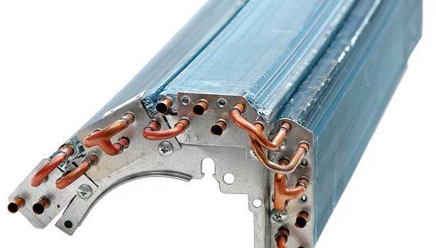

heat evaporator coil split system
Evaporator Coil (indoor coil) from a Split System. The coil employs 5-mm diameter MicroGroove copper tubes, which resulted in a 30 percent reduction in tube weight for the same performance (2500W cooling capacity) as previous models.
