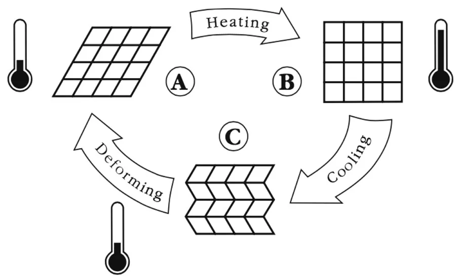

Figure 1. The crystal structure of a Shape Memory Alloy (SMA) such as nitinol deforms easily when in its cold Martensite phase (A). Heating to its hot Austenite transition temperatures causes a phase change and the alloy returns to its original shape (B) with a large force – several times greater than the force needed to deform it. When cooled below its transition temperatures, the phase change reverses (C) and it can again be easily deformed, and the cycle repeated. Source: Dynalloy

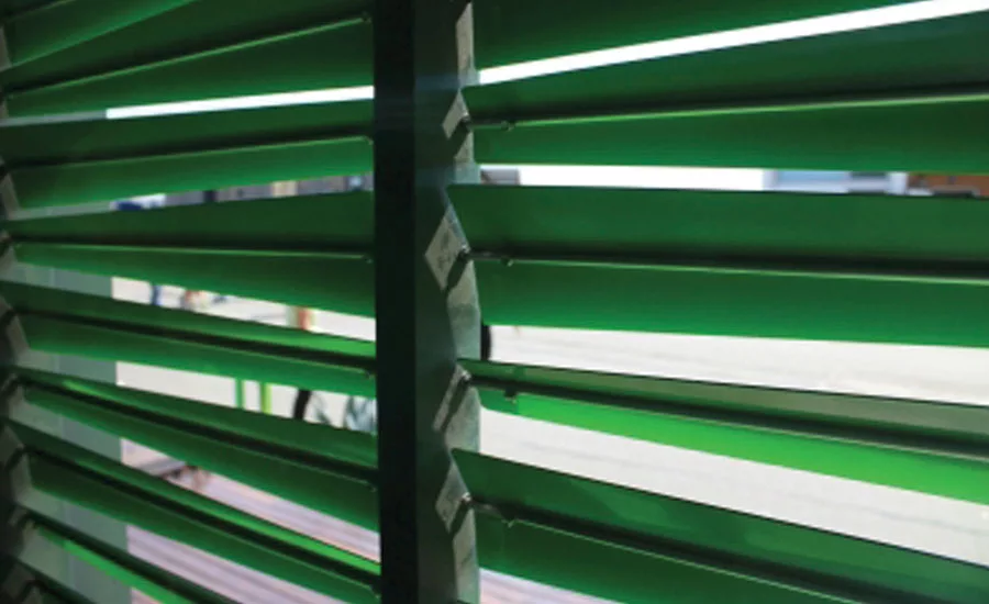

Figure 2 and 3. Example of an SMA louver system operated by the temperature changes from day to night. System created by the Catholic University of Washington D.C. and Dynalloy, Inc. for the Solar Decathlon 2013. Source: Dynalloy

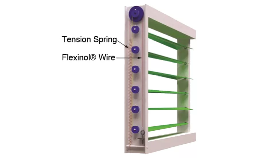

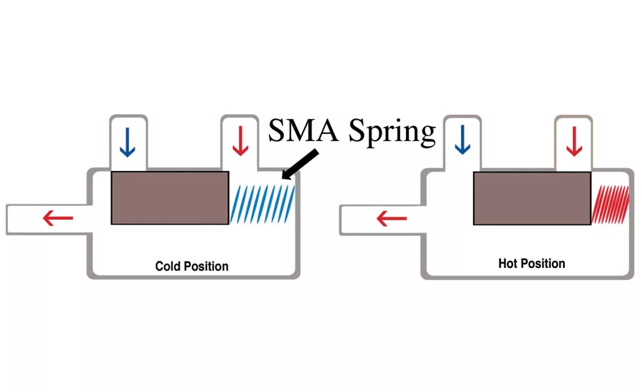

Figure 4. Example of an Anti-scald valve using SMA technology. When the water is too hot the SMA will contract and reduce the flow of hot water, while increasing the flow of cold water. Source: Dynalloy

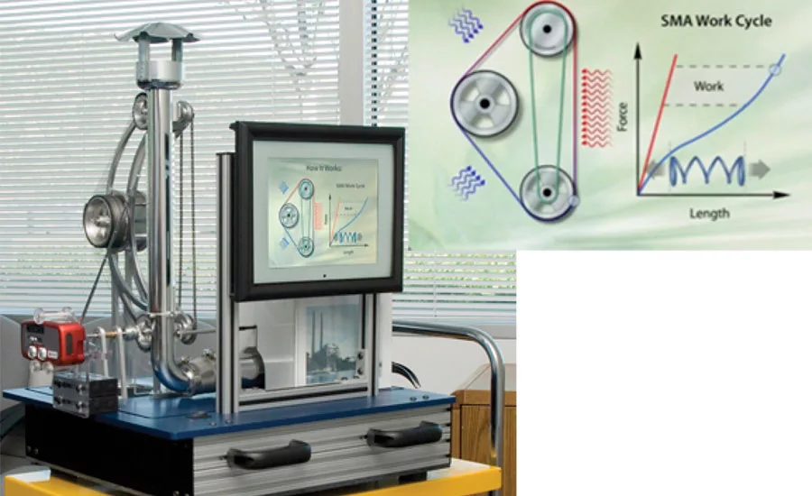

Figure 7. Example of an SMA based heat engine running an emergency radio from a simulated exhaust pipe or smoke stack. The SMA element goes through the pipe and then around three pulleys making a triangle. The SMA element gets shorter in the heat chamber, then elongates outside the heat chamber forcing the system to rotate. Source: Dynalloy

The underlying principle with SMAs is their ability to change their crystal form, or atomic structure, depending on the temperature of the material, basically becoming a solid state actuator. When the material is in the cool martensite phase it has a B19 or monoclinical crystal phase and when in the hot austenite phase an ordered B2 form. For a specific alloy and manufacturing process, the material can predictably change from one phase and related form to another, have predictable temperatures of transformation, and with predictable force levels. The cool martensite phase can be deformed with less force than the recovery forces of the hot austenite phase allowing a useable work delta between them.
 A simple example would be an SMA helical with hooks on the ends. When cold the SMA helical could be easily deformed and stretched with the appropriate steel return spring. Upon heating the helical to its transition temperature, the helical would then shorten back to the original length, and reverse to elongate upon cooling again.
This phenomenon can be demonstrated either by electrically heating the material or through ambient temperature changes. The focus of this article is how the material can be used with ambient temperature, specifically regulating temperatures, controlling valves or similar systems with only temperature, sensing entire systems versus measuring temperature in one or a few locations, taking action based on temperature, and the notions of moving heat from one location to another and to provide work from low grade waste heat.

Using only the hot and cold temperatures generated by the sun rising and setting each day, shape memory alloys can be used to regulate the internal temperature of a structure. Currently in homes and businesses, temperatures are regulated by heaters and air conditioners that work to create a comfortable internal environment, despite the outside elements. Energy is used to run these systems while the natural energy created by the earth heating and cooling each day is wasted. With the use of SMAs, this natural energy can be utilized to increase or decrease heat transfer rates (whichever is favorable dependent on the season) through walls, vents, and windows in such systems as blinds, attic vents, and perhaps even “breathing walls” with SMA activated vents all along the façade of a building.
In one such example, a system of blinds was used to cover a large span of sliding glass doors in a residence. SMAs were created with transition temperatures that matched the climate of the area, and the desired effect of the blinds. The SMA mechanism was oriented exposed to the outside air, so that during the daytime the heat of the sun contracted the SMAs and closed the blinds. This created shade inside the space and kept the internal temperature at a comfortable level against the high heat of the outside environment. When the outside temperature dropped below a preset transition temperature programed into the wire, the wire was stretched back out again using a bias force mechanism, shifting the blinds open. This would let in the cold night air to cool the home. This type of mechanism could in fact work the opposite way in the alternate season if designed properly. In this example, the blinds were also multicolored, adding a unique design element to the façade of the home.

SMA technology can optimize performance of standard valves and other similar systems. Just by using the ambient temperature of the appliance, like hot oven air or hot water from a dishwasher, the SMA can react to perform a function.
When the hot fluid or air enters the valve, the temperature alone will force the SMA to go through a phase change and perform work, depending on the design. An existing example produced today are anti-scald valves, and the potential extends to many other similar applications.

Over the last several decades SMAs have been explored heavily as an alternative energy source, most recently in 2010 with the US Department of Energy ARPA-E program. The notion is that low grade waste heat (roughly defined as < 200°C and as little as 10°C temperature differences between the heat source and ambient temperatures) be used to move the material back and forth between its transition temperatures and through this process accomplish usable work and ideally generate electricity. The results from this work indicate that yes, it is possible; however, today the efficiency levels keep the cost greater than fossil fuel based solutions.
Although the thermo to mechanical efficiency of the SMA heat engine is relatively low (approximately 0.5% to 3%) the latent heat in the SMA element between phases demonstrated a unique ability to move heat from one location to another, with the potential to span larger distances than existing solutions today. So, in addition to turning a fan (to even air temperate for more controlled cooking) or some other mechanical work, moving heat from one location to another has evolved in new ways. For example in high power battery applications the ability to move heat away, physically separate batteries, and/or break a circuit within a battery or between batteries simply based on temperature is possible in new forms.
