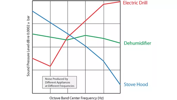

The first step toward successful use of perforated metals for an acoustical application is to get a better handle on the nature of the noise produced by your appliance design. You can reach some general conclusions simply by listening carefully. If you hear a pure tone or a prominent frequency (a squeal, hum or whine, as opposed to a whoosh or roar, like a waterfall), this is a good indication that the disturbing noise is concentrated in a limited frequency range.
However, a more detailed frequency analysis, whether measured or estimated, will show more clearly how the energy of the noise is distributed among the various frequencies. The most accurate means of determining how the energy is distributed over different frequency bands is by means of a sound level meter.
Figure 1 shows that the noise of a typical stove hood is strongest at low frequencies (125 and 250 Hz), while that of an electric drill is most intense at high frequencies (2000 and 4000 Hz). Dehumidifier noise is distributed about equally over the entire frequency range.
In performing your noise analysis, it’s important to account for the full range of operating conditions of the appliance and related work materials. A change of operating speed or work material can significantly affect the noise energy distribution. Also, you should allow for a possible change in the dominant noise frequency as the equipment ages and wears.

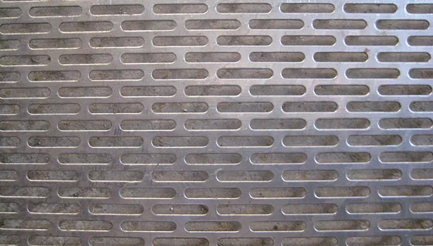

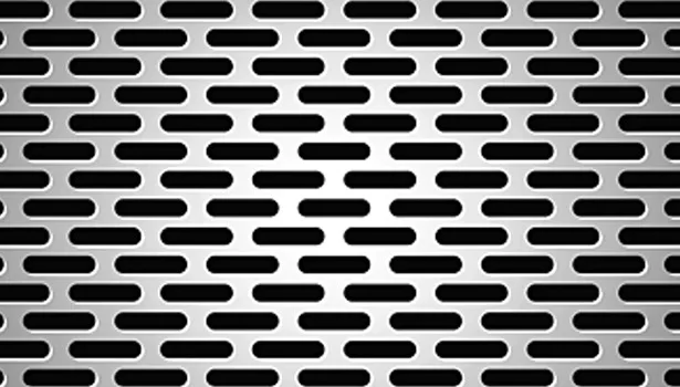

So what’s the best perforated metal design for this application? Most people assume that the greater the percent open area of the sheet, the more easily sound can go through it. And generally speaking, this assumption is correct, but not always. For example, we could make a sheet with 10 percent open area in two ways: either by making a single large hole at the center, or by very fine perforations overall. In Figure 2, both sheets have a total open area of 10 percent. But in the one on the left, 90 percent of the material is completely opaque to sound—reflecting it rather than letting it pass through. Meanwhile, the material on the right is nearly 100 percent transparent to sound.
For high transparency, the most important consideration is to have many small perforations, closely spaced. It is better to minimize the bar size (the size of the solid portions between the perforations) and (to a lesser extent) to minimize the sheet thickness, rather than to concentrate on percent open area. However, for practical reasons, very tiny holes should be avoided because they may get clogged with dust or filled with paint when the sheet is repainted. Perhaps more important, very finely perforated sheets tend to be fragile and are much more expensive to manufacture.
Therefore it is sometimes best to choose the gage of the metal first, based on cost, availability or other reasons, then choose the possible hole size, and jockey the other parameters to achieve the desired transparency.

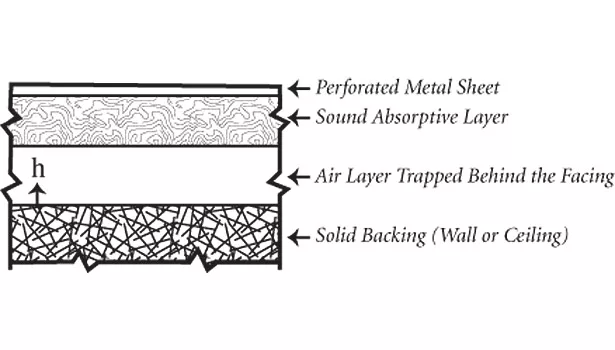

In some applications, you may need to absorb sound only in a certain band of frequencies, but not at frequencies lying above and below that band. The practical advantage is that focusing the frequency of the problem noise enables the actual absorptive material to perform its function more efficiently and with much less material.
For this purpose, you need a resonant sound absorber. In this application, the perforated metal, instead of disappearing, takes an active part in tuning the absorber—that is, in determining which frequencies of sound are absorbed. In this application, the perforated metal is used in combination with a trapped layer of air to modify the acoustical performance of the absorptive material by concentrating the sound absorption into a particular frequency range.
Here’s how it works: The air particles oscillate in and out of the holes in the metal sheet in response to an incident sound wave. The preferred frequency of this oscillation is determined by the mass of the air in the perforations and the springiness of the trapped air layer.
At that resonance frequency, the air moves violently in and out of the holes and the adjacent sound absorptive layer. There, the acoustic energy (carried by the back-and-forth motion of the air particles) is converted by friction into heat and is thereby removed from the acoustical scene. You can tune the absorption characteristics via your choice for the absorptive material in the cavity and where you locate that material in the cavity.

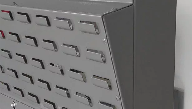

You also have many options for hole shape, pattern and size. Round holes in staggered patterns—which provide greater structural strength—are the most common choice overall. However, square holes are frequently used in appliance designs, although this shape usually functions as a guard or a grill and not as an acoustical component.
Regarding hole size, as mentioned previously, you generally want to strive for smaller holes in noise control applications. However, as a rule, hole diameter should never be less than the thickness of the material.
More broadly speaking, the shape of the metal sheet itself has an impact. In acoustical applications, the metal is often bent or corrugated as opposed to flat. These varied shapes not only lend visual interest, they can also serve to further deflect or otherwise manage noise.
