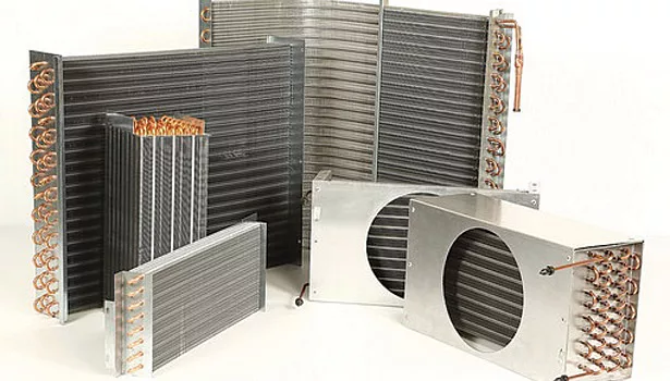

Figure 1. The growing use of smaller diameter copper tubes in different applications is prompting new research on the behavior of MicroGroove tubes. Copper tube outer diameters are 5.0 mm in each of these coil designs. Source: Spirotech Heat Exchangers Pvt. Ltd.

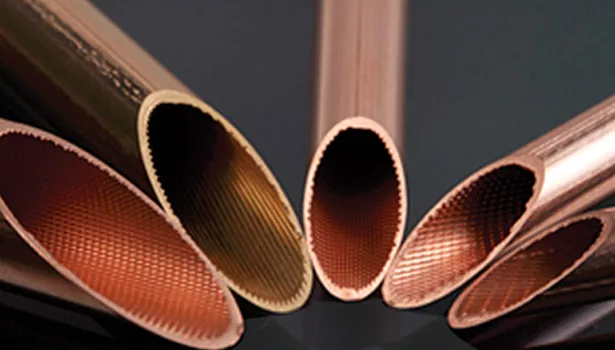

Figure 2. Copper alloy composition, tube diameter, tube wall thickness can be tailored to the application (see paper 2570). Source: Luvata

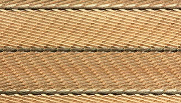

Figure 3. Much research examines the effects of internal surface enhancements or inner fins on the performance of evaporator and condenser coils (see paper 2570). Source: Luvata

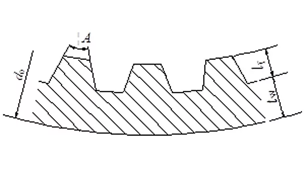

MicroGroove_sl4
Figure 4. The geometry of the inner fins has a dramatic effect on the local heat transfer coefficients (HTCs) inside the tube, which was measured for two types of surface enhancement on tubes with 5-mm outer diameter as well as one type on tubes with 4-mm outer diameter (see paper 2347).

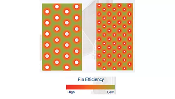

MicroGroove_sl6
Figure 6. Airside air-circulation is better for smaller-diameter copper tubes (see paper 2570).

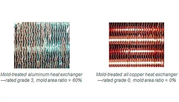

Figure 7. Life Cycle Climate Performance is a factor in coil selection. Both of these coils were treated with mold and allowed to incubate. The all-copper coil on the right shows no mold growth after 28 days of incubation (see paper 2570).

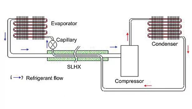

Figure 8. Experiments verified a suction line heat exchanger (SLHX) on R290 air conditioner with smaller diameter tubes of copper can increase the cooling capacity by more than 5%, increase the COP by more than 4%, while also reducing the amount of refrigerant in the system (see paper 2231).

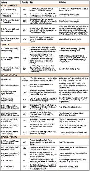

MicroGroove_sl9
Table 1. Download papers free-of-charge online. Simply search for the Session or Paper ID at www.conftool.com/2014Purdue/sessions.php

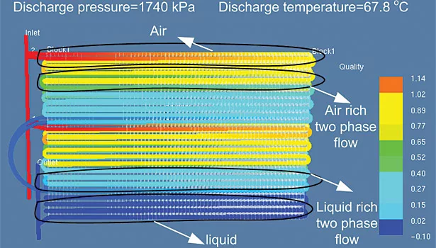

Figure 9. A simulation of the performance of effects of a suction line heat exchanger (SLHX) shows the quality of the refrigerant flow in four zones of the condenser coil as follows: 1) gas flow, 2) gas-rich two phase flow; 3) liquid-rich two phase flow; and 4) liquid flow (see paper 2231).

One fundamental area of experimental research involves the measurement of heat transfer coefficients (HTCs) and pressure drops for various sizes of copper tubes. There was no lack of such papers this year, with researchers investigating the behavior of new refrigerants and the effects of tube size, inner-groove geometry, mixtures, and oil contamination.
Simone Mancin from the University of Padova described extensive experiments measuring boiling heat transfer with R1234yf as the refrigerant. The copper tube was inner-grooved with an inner diameter of only 3.4 mm at the microfin tip. The researchers measured two-phase heat transfer coefficients and pressure drops for the full range of vapor qualities, at three different flow rates and three different heat fluxes. (See paper ID 2460)
Chieko Kondou from Kyushu University described measurements of HTCs and pressure drops on fluorinated olefins (R1234ze), including mixtures with R744 and R32 for air conditioning systems as well as comparisons between R1234ze(E) and the isomer R1234ze(Z) at higher temperatures for industrial heat pump applications. The measurements were made on copper tubes with inner grooves and outer diameters of 6 mm. For the mixtures, which are under consideration for replacing conventional R410a as a refrigerant, lower HTCs were obtained because of higher mass transfer resistances; but this effect was mitigated at higher mass velocities, where the HTCs of the mixtures approached those of the single component. For the isomer study, at condensation temperatures of 65 °C, the pressure gradient of the isomer was about three times greater while the condensation HTC was approximately 2.6 times higher than those of R1234ze(E). Detailed measurements for both condensation and evaporation are presented in the two papers, which should be consulted for a full examination of the results. (See paper ID 2337 and ID 2333, respectively)
Haitao Hu from the Institute of Refrigeration and Cryogenics at Shanghai Jiao Tong University described experiments in which oil contamination actually increases the boiling HTCs. The results obtained were expressed in terms of an enhancement factor (EF) which compares the HTCs with oil and without oil at various oil concentrations (Figures 4 and 5). The outer diameters of the copper tubes were 4 mm and 5 mm. Since two different inside-the-tube microfin geometries were used for the 5 mm outer diameter tube, it is possible to discern the effect of fin height on the HTCs. Similar work had been performed in the past on tubes with diameters 7.0 mm and larger but until now there has been no work on R410A/oil mixture flow boiling in small diameter microfin tubes. (See paper ID 2347)
Sangmu Lee from Mitsubishi Electric Corporation, Japan, presented fascinating research on the heat transfer characteristics of a smaller diameter copper tube with non-uniform inner grooves. In other words, the microfins are of different heights, which has important effects on the performance of the tubes, considering the manufacturing process. Firstly, the taller fins protect the smaller fins when the tube is expanded by the bullet method. Secondly, the contact between the tube and the fin is better when this pattern is used. In the first case, the refrigerant side heat transfer is improved; in the second case, the airside heat transfer is improved. (See paper ID 2283)

According to Professor Guoliang Ding of the Institute of Refrigeration and Cryogenics, Shanghai Jiao Tong University, there are four ways to improve the performance of air conditioners with smaller-diameter copper tubes. First is to optimize the refrigerant circuitry to reduce pressure drop; second is to enhance the air-side heat transfer; third is to optimize the distributor to achieve better refrigerant flow; and, finally, one could apply a suction line heat exchanger (SLHX) which uses the low temperature refrigerant from the suction line to cool down the refrigerant between the condenser and evaporator. In this research paper, which includes ICA coauthors, the theory of why a SLHX should increase efficiency is described and simulations are presented.
Additionally, a SLHX was installed in a 2600 W air conditioner made with smaller diameter copper tubes and propane (R290) as a refrigerant (Figures 8 and 9). According to the experimental results, the SLHX increased the cooling capacity by 5.3% and the COP by 4.5%; and the refrigerant charge was reduced by 6%. (See paper 2231)
