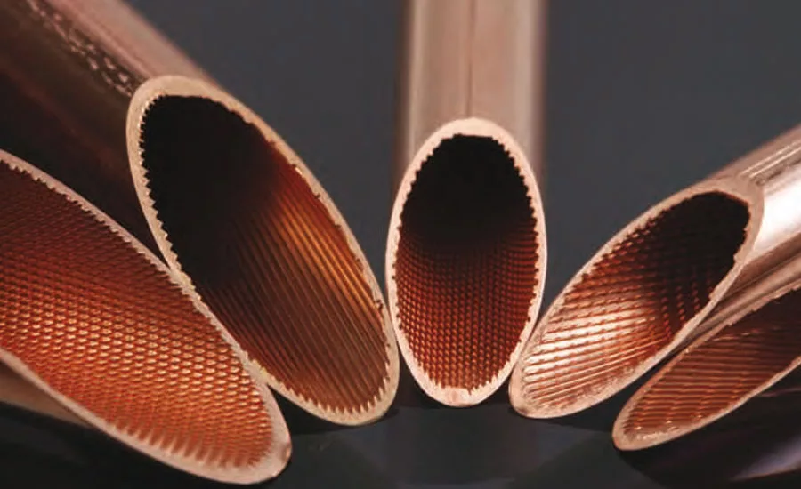

Perfecting the Inner Groove

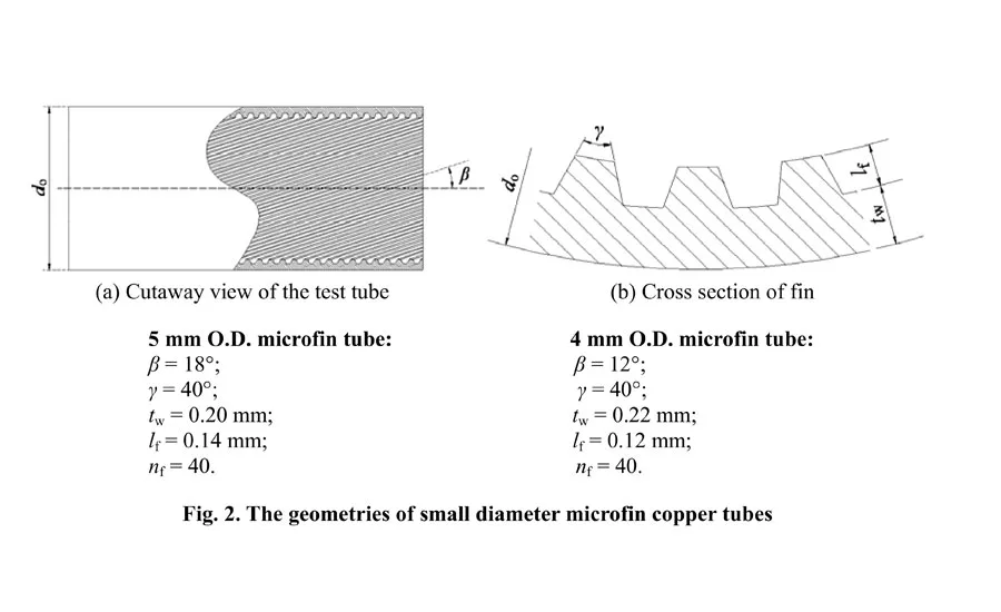

Another trend is to provide surface enhancements to the inside surface of the copper tubes. Again, this increases the inside-the-tube heat transfer characteristics.  Much research has been dedicated to understanding the behavior of various refrigerants as they flow through small, inner-grooved tubes at various rates. Here theory and manufacturing capability are closely intertwined. Generally speaking, a grooved inner surface mixes up the refrigerant for more efficient heat transfer between the refrigerant and the tube wall. Surface enhancements can improve the performance of copper tubes both in condenser coils and evaporator coils.
In the case of inner-grooves or microfins for tubes, the grooves have widths on the order of hundreds of microns at the top of the groove. It is remarkable that these inner grooves can enhance the HTCs by as much as 300 percent depending on the tube diameter, the flow rate, the refrigerant and the type of enhancement. The variability in HTC enhancement has spurred competition among tube suppliers, who are the experts in fabricating tubes with various kinds of enhancements, for example, herringbone or helical patterns.
Tube manufacturers today can vary the features of the microfins in many ways. They can vary the width at the top of the groove. They can vary the depth of the groove. They can vary the groove wall angle, the helical angle and spacing between the grooves.  Incidentally, the term “microgroove” is reminiscent of the record industry where the term was used to describe the narrow grooves of long playing records introduced in the late 1940s. These “microgrooves” were 50 microns (2 mils) or less at the top compared to earlier coarse grooves which were 150 microns (mils) or less at the top. [5,6]  This term “microgroove” is therefore apropos for describing the inner surface enhancements of copper tubes, which are of a similar order of magnitude[7].

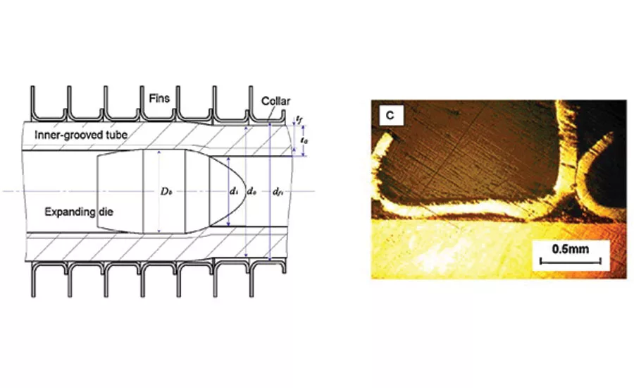

The manufacturing process of RTPF coils creates a rigid assembly from parts that are individually rather delicate. As described earlier, small diameter tubes have much higher strength for resisting internal pressure. However, when not assembled into a coil, the small diameter of these tubes can make them weaker in resisting bending and buckling.
The joining of tubes and fins is what makes the assembly strong. For smaller diameter tubes, depending on the wall thickness, higher forces may be required to expand the tubes but tube expansion is still practical. In addition to creating a rigid assembly, the joint between the tube and fin creates a path for heat conduction. If the tubes are improperly joined to the fins then the boundaries between the tubes and fins can become barriers to heat flow.

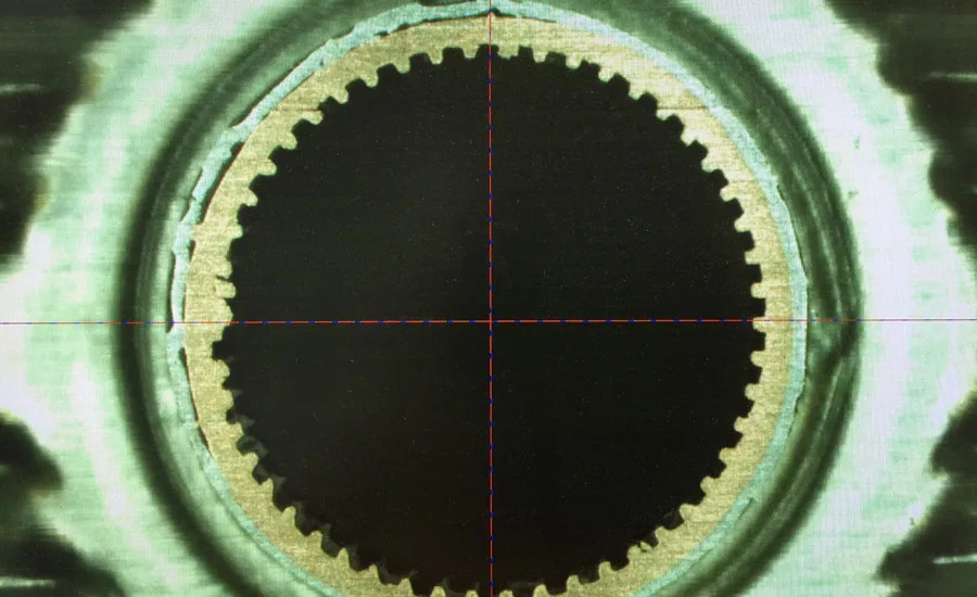

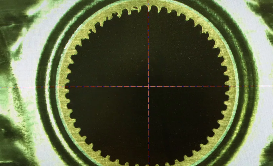

The preferred method for joining tubes and fins is through a process of tube expansion to generate an interference fit between the tube and the extruded fin collar. This expansion is typically performed using a spherical “bullet” that is pushed through the tube by a smaller diameter rod. The bullet diameter is larger than the original tube inside diameter, causing the tube to expand.
Friction between the tube and bullet induces column loading on the tube, which could cause the tube to buckle if not contained. Also, as the tube expands in diameter, material along the length of tube is drawn into the increased circumference of the tube; consequently the tube shrinks in length during the expansion process. Early adopters of small diameter tubes faced challenges in the expansion process, which led to development of “limited-shrink” expansion by OEMs. This approach enabled successful expansion by placing the tube in tension to prevent buckling and to control shrinkage. The proper balance of bullet friction force and tube tension also allows zero shrinkage of the tube.

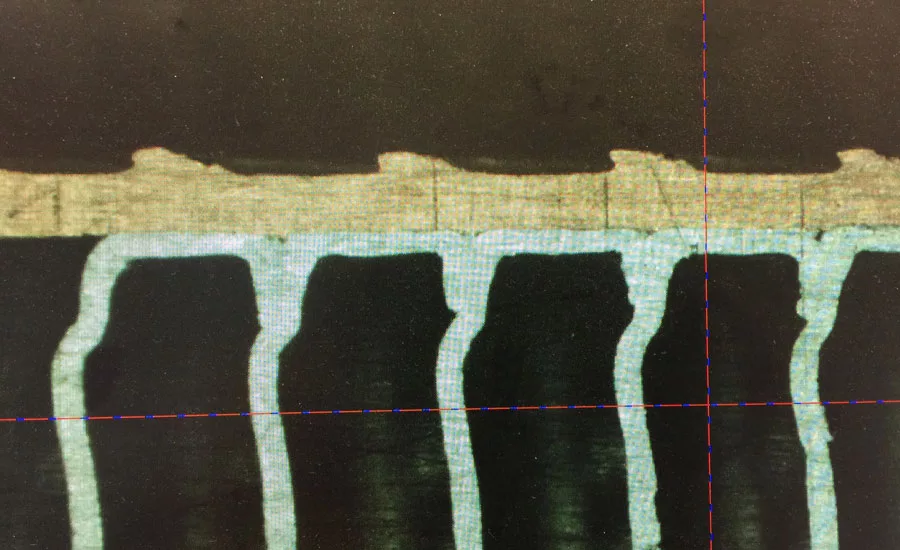

Non-Invasive Tube Expansion Breakthrough
New technology being launched by Burr OAK Tool of Sturgis, Michigan, USA incorporates the proven technology of tube expansion to join the tube and fin. The new product, which is set to be released to the market in November, “uses precisely controlled pressure to expand tubes for an interference fit between the tubes and fins,” according to Jason Halling, Manager of Business Development & Marketing for OAK. The method of using pressure to expand tubes is commonly used in the hydroforming industry where containment for the final tube shape is determined with dies that encapsulate the material. In the case of expanding MicroGroove tubes into fins, the fin collar provides the necessary containment, resisting expansion and establishing a secure bond between the tube and fin. Halling explains that pressure expansion is not a new process to the HVAC industry. Some manufacturers routinely use pressurized fluids to expand coils. “This solution has inherent benefits that the industry will use to take MicroGroove to the next level,” states Halling.
Regarding non-invasive expansion, according to Roger Tetzloff, Innovations Manager for OAK, there are at least three benefits:
1. Zero Shrink Process
Tetzloff explains that pressure expansion is inherently a zero shrink process. Lévy-Mises equations describing plastic flow in material are used to show that a tube experiences zero lateral strain while pressure is applied to expand the tube diameter plastically [14]. In effect, the internal pressure that causes hoop stress in the tube resulting in expansion of the tube diameter also places tension on the tube, in the precise amount needed, to prevent the tube from shrinking. “This is really exciting,” explains Tetzloff, “when you understand the impact that compressive loading and bullet interaction can have on the tube and fin bond.”  Tang, Li, and Peng of the School of Mechanical Engineering in Shanghai have studied the effect of collar compression[15]. Test results indicate improvements in the tube-to-fin contact of coils that are expanded with the non-invasive pressure approach rather than mechanical bullet expansion.
2. No Deformation of MicroGrooves
The second significant advantage of using pressure to expand tubes is that the internal tube enhancements are not disturbed as they are when using a mechanical bullet. This comparison is illustrated in images of small diameter internally enhanced MicroGroove tubes. For the bullet method, the stresses exerted in the internal enhancements of the tube are significant. The bullet method could deform the tops of fragile types of inner fins. Expanding tubes with pressure will enable tube manufacturers and researchers to explore new designs of surface enhancements.
It can be seen then that the use of a non-invasive expansion process opens the door to the use of more delicate inner-fin structures.  The immediate effect is that existing enhancements will be unaffected by the manufacturing process. This phenomenon is already being tested in joint research by the ICA, OTS and BOTI, to determine what effects, if any, the method of expansion method has on the performance of surface enhancements and the values of heat transfer coefficients.
