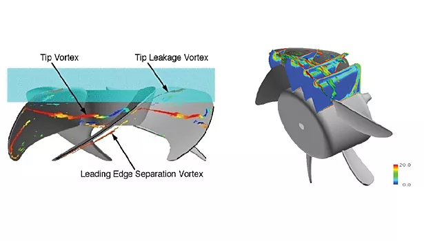

Figure 1: Typical sources of aerodynamic noise in low speed axial propeller fans (left) and visualization of tip leakage flow from one blade hitting the following one (right). Source: Advanced Design Technology

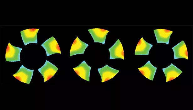

Figure 3: Three designs for axial fans with relative velocity contours, despite the large difference in geometries only one design parameters (stacking) was changed in the three designs. Source: Advanced Design Technology

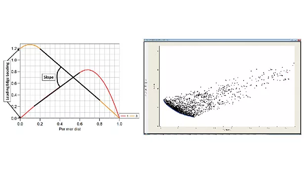

Figure 4: Parameterized blade loading (left), changing the leading edge loading and slope at both hub (1) and tip (3) ensures good coverage of the design space with minimal number of design parameters. Pareto Front of the Optimization (right) shows effectiveness of the optimization process to reduce noise and improve efficiency. Source: Advanced Design Technology

One very important aspect of aerodynamic and aero-acoustic optimization is to understand the sources of noise and noise generation mechanisms for a variety of applications, a number of recent methods and their applications to fan design are reported below.

The blade parameterization implemented in 3-D inverse design is considerably different. Users specify the blade loading, or pressure jump across the blade, via a relatively simple parameterization as illustrated in Figure 4 (left). By controlling the leading edge loading at both hub and tip, the blade incidence is controlled, while the slope of the hub and tip loading curves controls the aerodynamic distribution, the code automatically scales the area underneath each curve to maintain and satisfy the input work coefficient, or essentially the blade pressure rise. With inclusion of the blade stacking, or wrap angle at hub or shroud at the trailing edge, a total of five design parameters can cover a relatively large design space as illustrated by the two fan designs in Figure 3 where only stacking was changed for values of -10, 0 and +10 wrap angle at the hub. Therefore following on the example above, with n=5 only 21 designs are needed.

Figure 4 presents the Pareto Front (blue line) of the above mentioned optimization routine where each design, represented by a dot, is evaluated for both tonal noise and profile loss, as an indicator of the blade efficiency. This unconstrained optimization shows that compared to the original design (pink lines) the optimization routine identified several design candidates featuring up to 13% reduction in profile loss, hence increase in efficiency, and up to 5% reduction in tonal noise. These designs are clearly situated at the extremities of the Pareto Front showing an inevitable tradeoff between efficiency and noise, although designers can comfortably select the design that best suits their requirements by selecting any point in-between these extremities.
