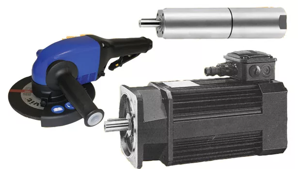

deprag_sl1
Motors are shown here for size comparison. Source: DEPRAG

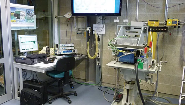

DEPRAG has collaborated with the University of Applied Sciences at Amberg-Weiden in testing and developing these turbines. The calculation and design work for the turbines for the turbine grinder took place under the leadership of Professor Dr. Andreas Weiß. The university has a test facility for pneumatic drives and compressed air technology, which was used to verify the design calculations and CFD flow simulations for the Curtis turbines used in the grinder. Source: DEPRAG

Dr. Pfeiffer:Indeed they do. But other features also come into play here. We have already talked about their small size. It means that turbines are particularly suited for robot-controlled applications or where space is at a premium, for example inside the fuselage of an aircraft, but they are also used in high quality manual machinery. We market a turbine grinder which is able to exert as much as 2.2 kilowatts of power onto the grinding wheel, yet it weighs only 1.8 kilograms. A comparable device to deburr, polish or cut using a vane motor and weighing the same would produce only 1 kilowatt of power. Compared with an electrically driven tool the advantage derived from this low power-weight ratio is even more pronounced: To produce the same power an electro-grinder would weigh 5.7 kilograms.
