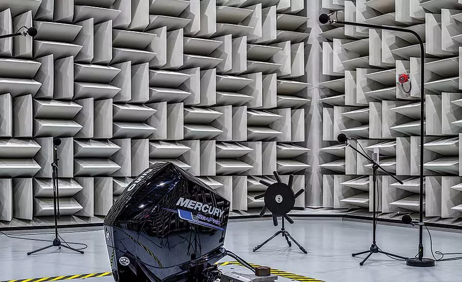

Two highly flexible acoustic test chambers were designed specifically for testing marine engines. Photo courtesy Mercury MarineCorp

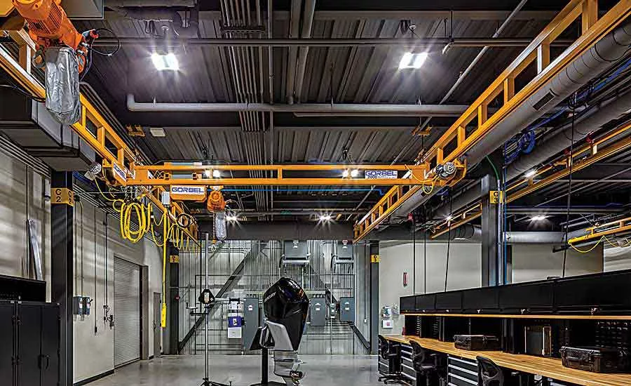

A large instrumentation bay offers an indoor area for testing vessels up to 45 feet in length and 12 feet in beam. PHOTO COURTE-SY MERCURY MARINE

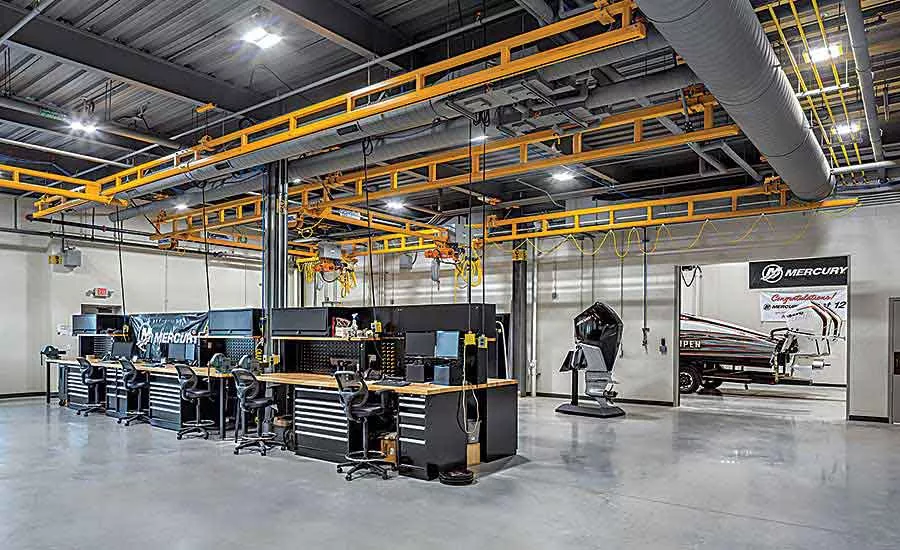

A modal test area provides space for performing modal analysis of products, as well as measurement of engine center of gravity and moment of inertia parameters. PHOTO COURTESY MERCURY MARINE

An indoor environment designed to mitigate vibrations transmitted into the facility was essential to ensure that noise and vibration testing and sound level measurements would be accurate. Two highly flexible acoustic test chambers were designed specifically for testing marine engines, but are also configurable into standard hemi-anechoic spaces to test a wide array of other products.
An evaluation and listening room allows juries to evaluate the distinctive sounds of Mercury products. While quiet enough to allow for undisturbed evaluation, the room is not so quiet as to create an unnerving environment for participants. A technician area provides engineers with an ideal place to perform their duties. A modal test area provides space for performing modal analysis of products, as well as measurement of engine center of gravity and moment of inertia parameters. Lastly, a large instrumentation bay offers an indoor area for testing vessels up to 45 feet in length and 12 feet in beam.

Acoustic isolation systems. With test room noise floor targets nearing noise criterion (NC) curve 10, a minimum sound transmission class (STC) of 56 was necessary to reduce unwanted airborne sound.
NC curves are a common way to measure and specify background noise in unoccupied buildings and spaces. Their purpose is to produce a single-value representation of a complete sound spectrum. A library might have an NC curve of 35 to 40; a recording studio might have an NC curve of 15 to 20. STC is an integer rating of how well a building partition attenuates airborne sound. It is used to rate walls, ceilings, floors, doors and windows. A wall with a high STC attenuates more noise than one with a lower rating.
Precast concrete panels with ratings as high as STC-61 were used to form the exterior perimeter walls. A nested room configuration minimizes background sound levels. With ground-borne vibration a concern, and test room isolation essential, the inner test room was constructed of weight-reducing metal acoustic wall panels with integrated perforated metal anechoic wedges.
Vibration isolation. Isolation of the acoustic test chambers was essential. Test room floors are 6-inch thick steel-reinforced concrete slabs designed for added stiffness to mitigate floor resonance. Coiled steel spring mounts isolate the test room floor and acoustic room structure from unwanted ground-borne vibration.
The acoustic panel test chamber and its steel structural frame are supported on the perimeter of the floor slab, where the slab transfers its dead and live loads through the isolation mounts. A 90 percent isolation efficiency from disturbing frequencies of 8 hertz and higher is achieved.
