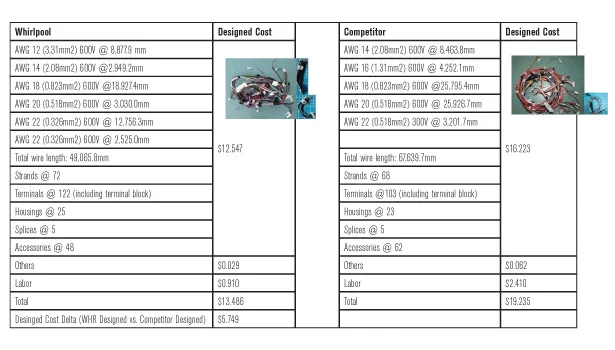

DFMA chart information whirlpool
Figure 1: Prior to having a formal DFMA database and reporting tool, many of cost comparisons where done in spreadsheets and saved in PowerPoint slides along with product images. It was very challenging to assemble and distribute these reports and even more challenging keeping the data current. Comparison reports like these drove the need for more automation.

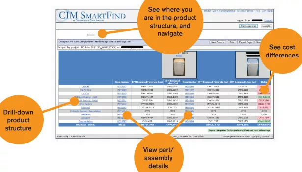

cim smart find reporting tool whirlpool
Figure 2: CIM SmartFind Cost Reporting Tool used at Whirlpool. Engineers can view DFMA cost data from a Web browser tool called CIM SmartFind, which serves as their cost data reporting tool. This tool allows them to compare different components and their costs and roll up this data at a product level to make further comparisons.

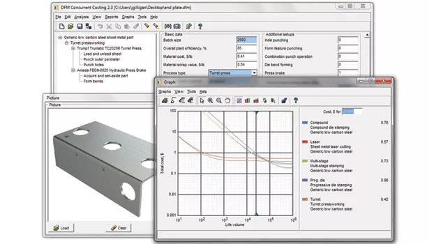

dfma cost analysis software program
Figure 3: A series of cost curves for making the sheet metal end plate pictured at left. The DFM analysis compares five different sheet metal tooling options and shows how costs vary depending on the life volume planned for the part. At a life volume of 25,000, the least expensive manufacturing strategy utilizes a turret press. As volume increases, however, the analysis shows that other processes become more economical.

  • Finally, a globally web accessible search capability was added to facilitate the retrieval of both individual cost models and full cost reports via the SmartFind search tool—eliminating the need for manual assembly and distribution of static PowerPoint reports.
Using CIM, Whirlpool engineers have been able to easily find the exact part or assembly they are most interested in investigating. They can view multiple images and associated cost data of Whirlpool and competitive designs to help understand cost differences and areas to achieve cost advantages. They are also able to use this information to create their own personal reports. An example of this type of comparison is illustrated below. Thanks to the robust taxonomy work completed by the team, these reports can be navigated up and down the entire product structure from entire product all the way down to individual parts.
