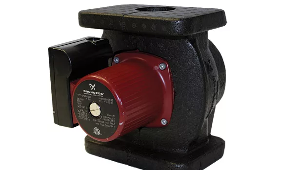

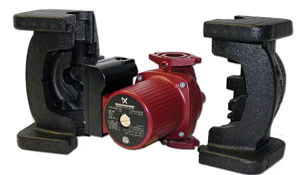

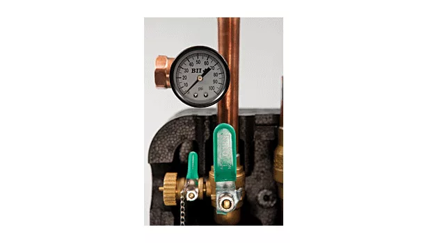

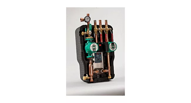

This unique solar hot water heater pump case uses foam in place of hard plastic to reduce this required amount of fasteners for assembly. The pipe and valve components snap into the foam.

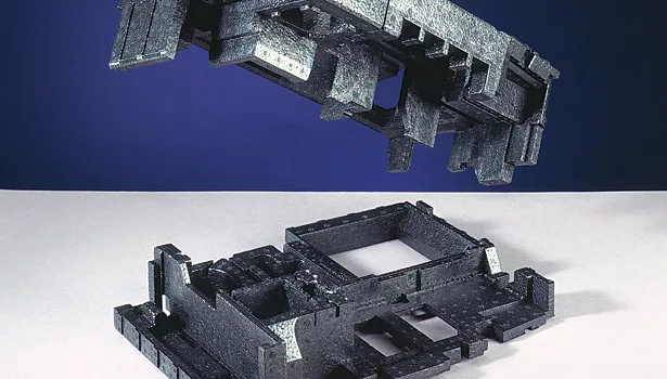

The foam can be molded into complex shapes using steam heat & pressure. Beads are introduced under pressure into an aluminum mold and are heated to their melting point using superheated steam. The heat causes the gas inside each bead to expand which allows the surface of the beads to fuse into one another. The finished parts are then cooled and ejected from the mold. Tooling prices are dependent on both the size and complexity of the part but generally range from $10,000 to $50,000 which makes this process a good option for applications with medium or high production volumes.

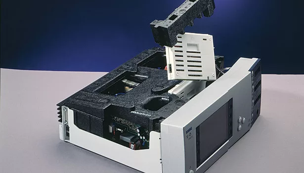

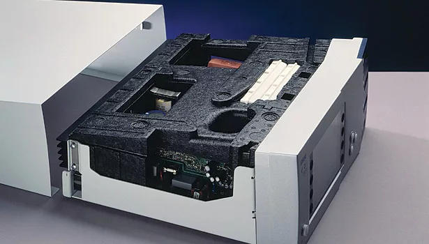

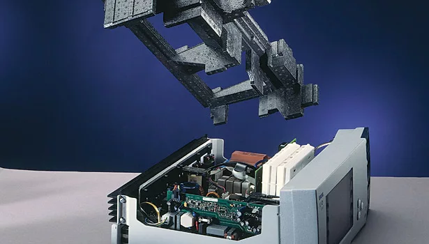

The resiliency of the material allows components such as printed circuit boards, fans and power supplies to be held in place using a friction fit, thus fewer screws and fasteners. The components are simply slid or snapped into place and then held in place by the foam.
Current applications utilize a sandwich approach with top and bottom foam pieces that lock the components between them. Instead of securing a cooling fan to a wall or chassis with screws, EPP can be used to sandwich the foam and hold it in place. The resilient nature of the foam will also dampen any vibration or noise created by the fan.
Assembly can also be simplified by press-fitting the components into the internal chassis. Press fitting makes it easier to disassemble for any service or maintenance that is needed or for full recyclability of the product at its end of life.

Using foam to create the inner chassis of a product gives product designers more flexibility in their designs as they can decouple the functionality of the inner chassis and the outer housing. The rigidity and strength provided by the foam chassis reduces the strength required from the outer housing and allows thinner gauge materials to be used. In some cases, it also allows products with different interior configurations to be made without having to change the outer housing. EPP has excellent cushioning properties and will protect the internal components in case of drops and falls. A variety of textures can be molded into the foam and in certain applications such as solar hot water heater control panels; the EPP foam is used as the outer housing as well.
Another benefit of using EPP to create an internal chassis is the ability to mold different types of channels into the foam. Channels can be molded into the foam to provide runs for wires, cables and tubing to be routed. Ribs molded into the sides of these runs allow the wires, cables and tubing to simply snap into place during assembly without any further need for attachments. Channels can be molded into the foam to manage the airflow throughout a product and provide pinpoint cooling where it is needed. By directing the airflow within the chassis to precisely where it is needed, smaller fans can be used, possibly allowing a quieter and more energy efficient design. This feature is especially beneficial for portable devices.
Once a design has been roughed out, an initial prototype can be produced using a CNC milling machine to cut a billet of the EPP material. No special tooling is required to create the prototype. The components can be assembled into place on the prototype and modifications can be made directly to the foam using a razor knife and/or hot wire cutter. The improvements are then added to the CAD model and the next iteration of the prototype can be quickly made. It is not uncommon for product designers, as they become more comfortable with the material, to mock up proofs of concept from foam blocks using razor knives and hot glue guns.
