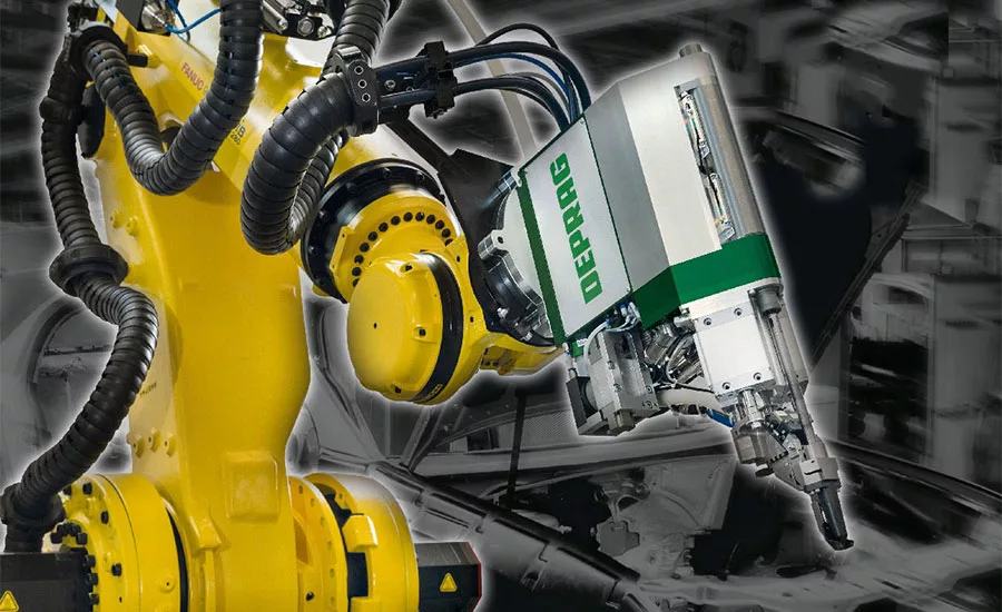

The assembly systems needed for the flow-type fastener assemblies are primarily used on robots.
Using an earlier generation of assembly system requires a lot of operator involvement, such as parameter input, parameter change, adjustments to cylinders, air, etc. If an assembly system is used that is adaptive and where the adjustment is done automatically, less time is spent on babysitting the robot or the screwdriving system.

An ideal assembly should use a “closed loop” and adaptive assembly unit that combines EC-Servo screwdriving technology with EC-Servo stroke technology.
The communication between a twin-closed-loop system allows the automatic recognition of the penetration of the material layers—independent of the material- or screw-tolerances. Such a control could continuously evaluate the relevant feedback from the control modules and automatically optimize the process. This could be done by adjusting the process variables such as the contact pressure, feed-distance, and speed. The system also ensures the ideal processing parameter, which means: parameters are reliably put into action during each individual screwdriving cycle, as well as the connecting parts and fasteners are exposed to the least possible stress.
